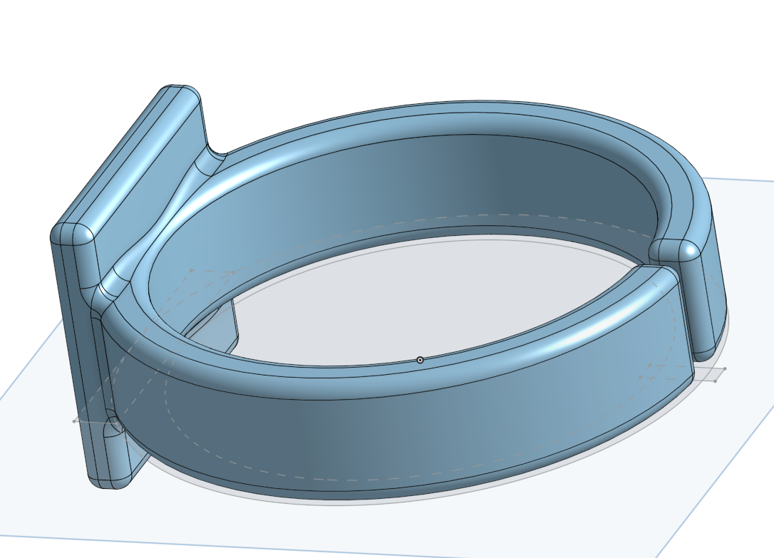

sounds the most approachable and i feel like there could be indeed some Hz to be gained and maybe at the same time the mid-bass bump reduced1) Take the back off and using a tubular extension, mess with internal volume increase as well as a passive radiator on the back
tho, i preferably would like to keep the unit stock (maybe i change my mind once the gurantee is over.. but i also feel like the unit sounds quite good stock) and just make an external shell or something that has some benefits
i actually played around a bit with the speaker (putting it inside of tubes or such) and imo there is some low end extension going on.... also placing the speaker simply on a desk has such a effect (tho its not really predictable/repeatable)
but in my experimentation i actually "sensed" that there was on the outer aluminium(?) tube around 3x as much vibration going on as on the bottom, so i figured why not try a clamp? (as it seems that putting some force with a few fingers around the tube actually quite significantly cleans up some muddyness in the bass/low vocal region)
i will report back once the print finished 🙂
i just took a listen to the clamp, actually this might be the easiest solution to the resonance problem, big pro is it stays portable and i could design it in such way so it can be used as horizontal stand
the clamp definitely reduced/eliminated some of the muddyness, was able to bump the bass by one notch inside the minirig app after that
So, i might just go with this?
currently printing this version (ports are between the clamps) with adjusted/tighter tolerances:
will try to make some measurements soon, im pretty sure this can be seen specially in the waterfal diagram

just an update after a bit more listening to it
i printed the model with Sunlu PLA+ 2.0
its at first a very thight fit but it seems over time the PLA+ gives in a little
while the effect of the clamp on is still audible, its not as good anymore as the first day/few hours
ALSO, i noticed the horizontal stand is actually quite heavly transferring resonances into the ground, therefore i advice to put some rubber feet/dampener under it to avoid aggregating the bottom surface the minirig stands on
