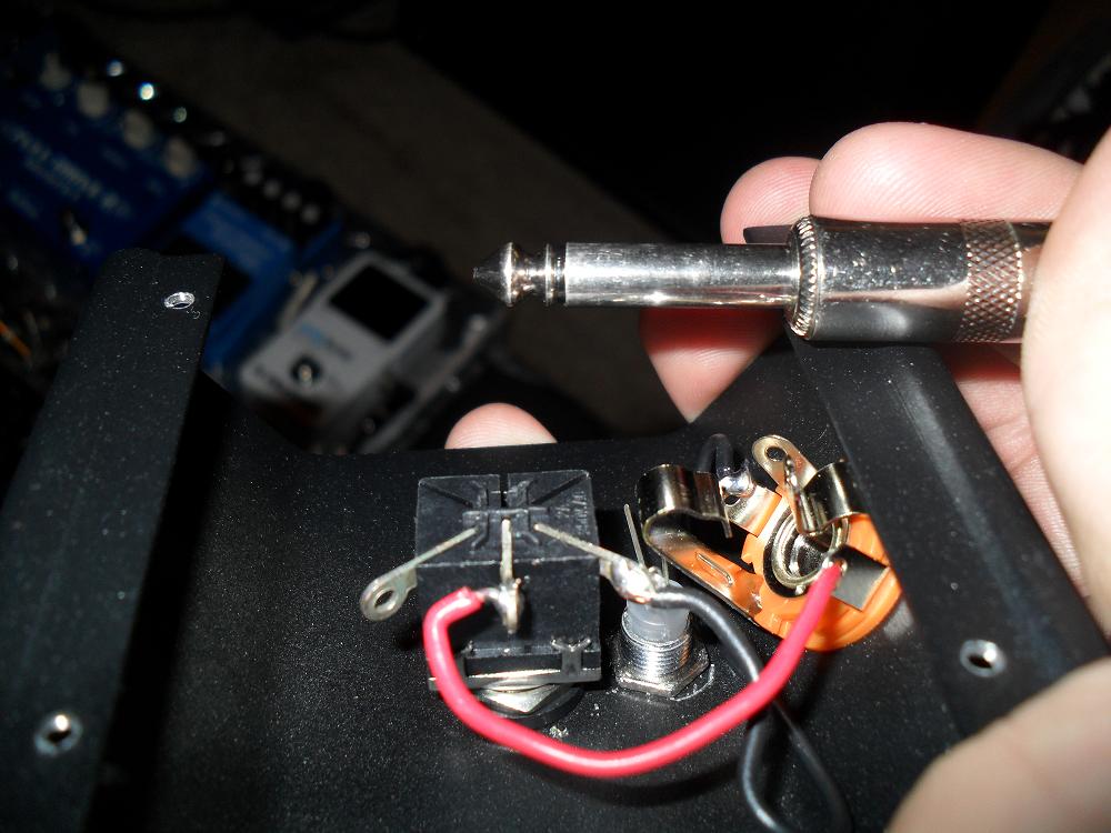

View attachment 203683Thanks so much for your help guys! I think I am going to try picking up a couple of the recommended flip flops and see if I can get this thing working. I don't really know much about de-bouncing the circuit, but I have read up on it a little, and seems like it's nothing too complicated. I took a couple photos of the project also just to give a little more insight as to what I am working with. In addition it was suggested that there might be current coming from the amp which could be used to power the LED. So I put a multimeter to it and it read -18.5 DCV...I don't know if that is useful or not, but I figured I would throw that on here in case it gives anyone an idea of a better way to approach the project.

The amplifier is a Blacktar HT-5 combo. There is a LED on the control panel of the amp, but I am trying to get this done by modifying the footswitch only. At this point I don't want to void the warranty of the amplifier by modifying any internal components. It would be ideal to tap into the LED on the control panel since you would never have to worry about the 2 being out of sync, but since the fix for them being out of sync would be a simple push of a button that would only be necessary once per use, so I can be happy with that if i get it working.
