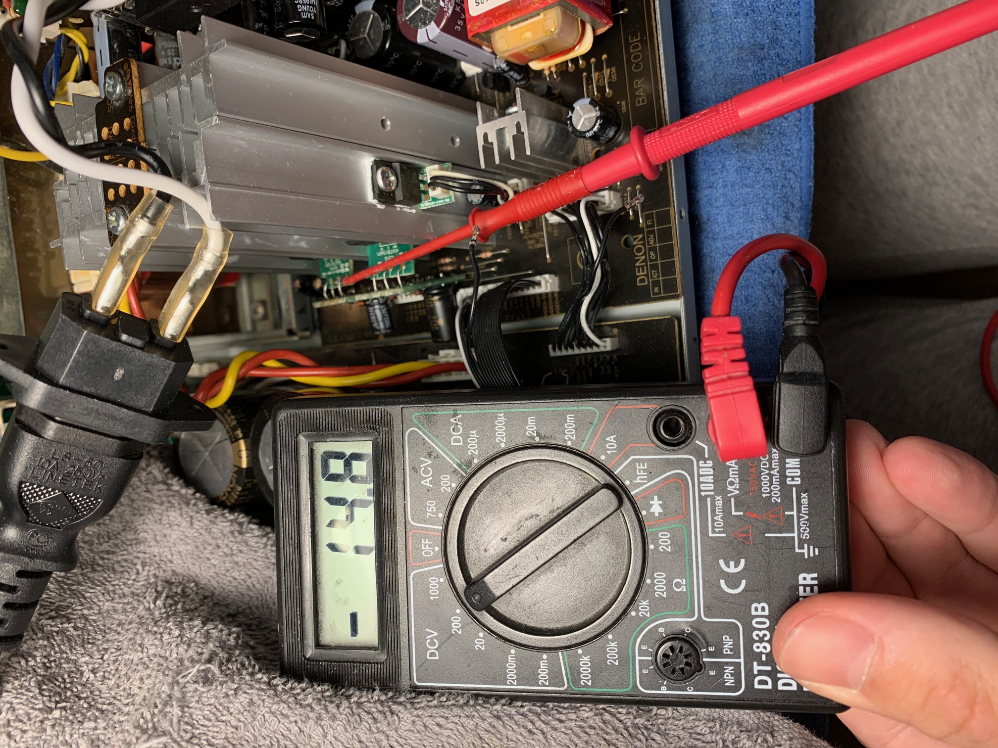

Got a problem with my AVR1909. Problem began with unit going into protection mode after ~5-10 min. Checked power supply voltages and found that -15V is pretty low (~ -14), drops to ~ -13 and and around that moment protection mode kicks in.

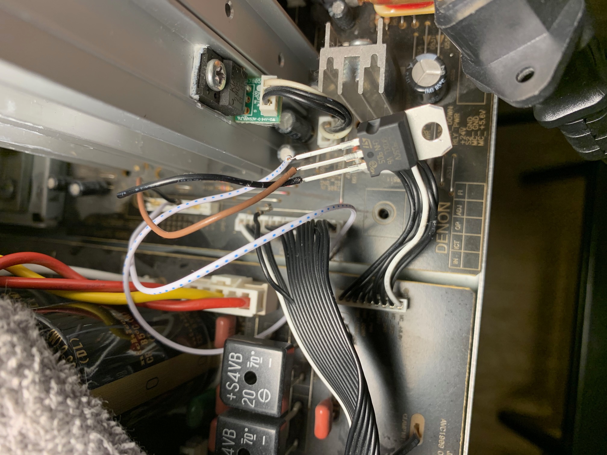

Changed regulator (KIA7915P ->L7915CV, insulated central pin from radiator of course), got 0V on 15V rail. With this temporary setup (photo, only -15V regulator) and disconnected -15V pin from input board (tested that pin only when disconnected, i don't get it short to ground) i get constant -15V (looks like PSU is working fine?).

I replaced both -15V and +15V regulators, -15V (7915) output capacitor and input zener diode (33V). When i disconnect -15V rail output i get nice -15V from the regulator, with both -15V rails connected i get 0V. +15V rail is fine. Maybe someone has any ideas where to look next? 🙂 Thanks!

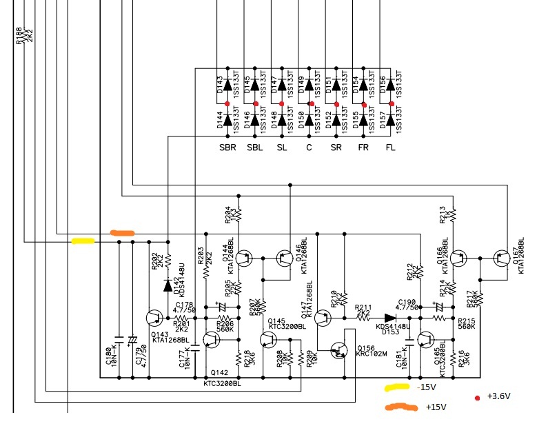

Looks like found one shorted op-amp along the -15V rail, but still have short in this part of protection circuit (picture). Disconnecting R188 makes it go away and amp turns on fine.
Replaced C179, ceramic SMD cap C180 not shorted, all resistors and Q143 seem fine for me. Red points (come from input/output board) measure ~ +3.6V each, does that trigger protection circuit? Thanks a lot for any ideas 🙂

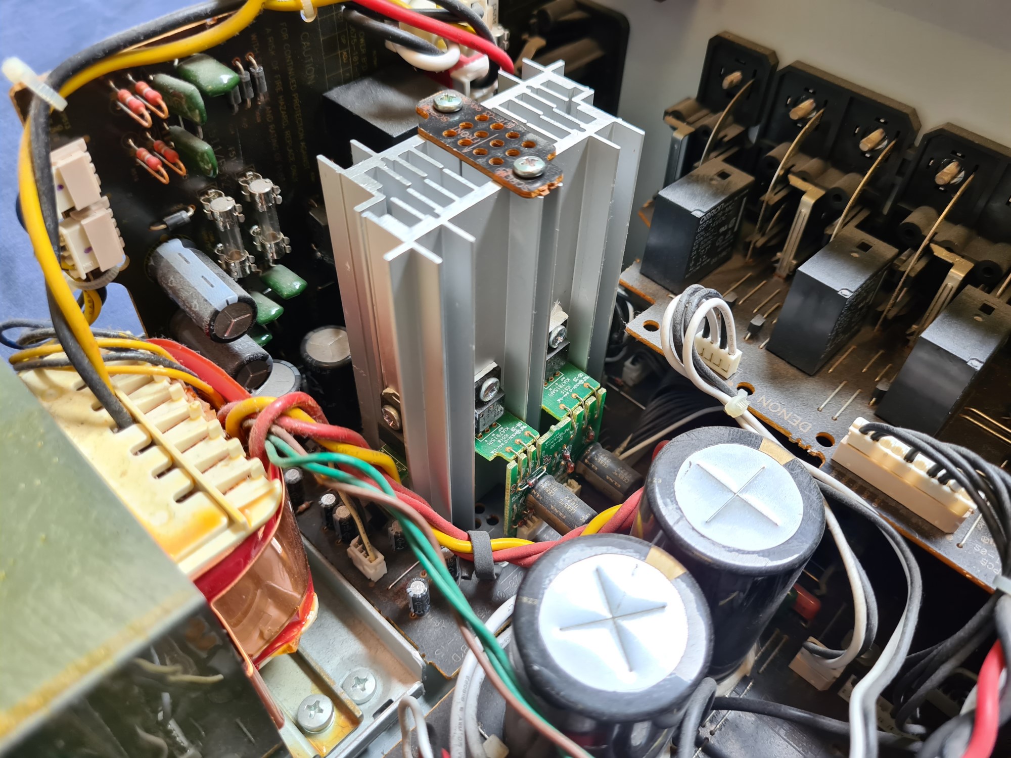

I also have a failing Denon 1909. Getting the fast flashing red power light (ASO / DC protection error) after about 15 min operation. Blasting with a fan to keep it cool seems to help but still fails after a few hours.
Have already opened it up to clean out dust and poke around. Suspect the 15v regulator may be the issue, it's the only part that seems to get hot (60C+ on the heat-sink) and have seen a few references to the transistors failing. I measured the voltages at the plug below the transistor daughter board as +16.10v and -14.46v. Not sure if this is the correct point or what the acceptable range is?
I'm fairly handy with a soldering iron but don't understand the circuits that well. Doesn't look too hard to replace the KIA7815API & KIA7915PI. Is it ok to replace with L7915ACV & L7815CV, not sure what the difference is? Anything else I should be looking at?

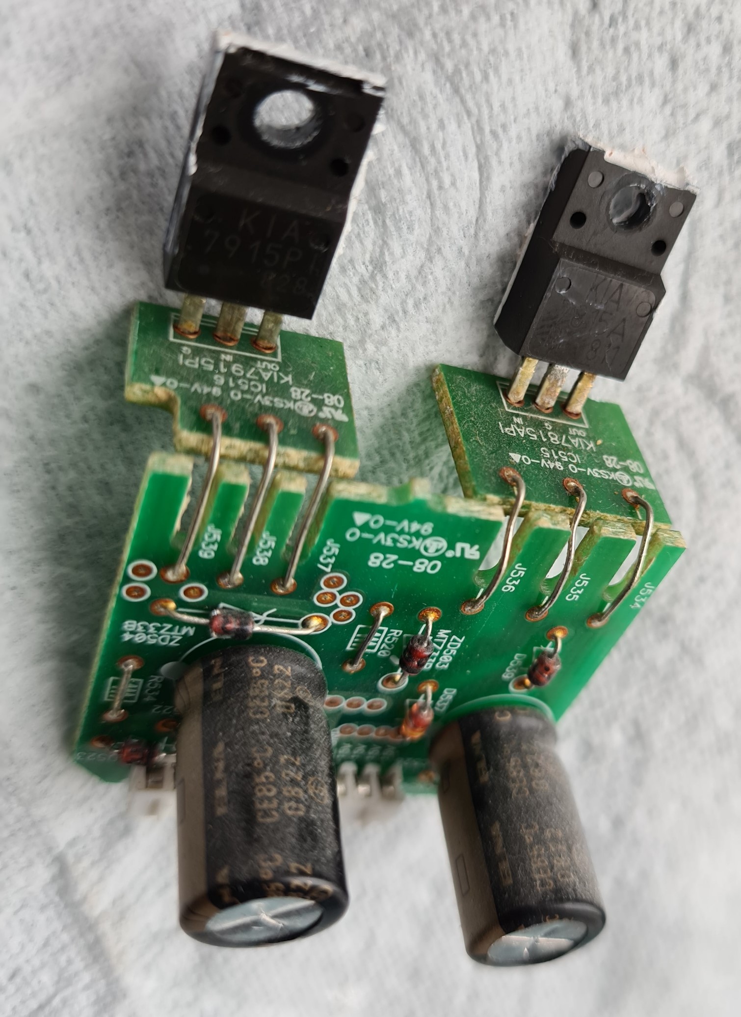

Well I managed to pop the regulator daughter board out without having to take anything else apart.
Took a couple more voltage readings from the regulator pins before removing:
KIA7915PI : -26v in / -14.4v out
KIA7815API : 24.5v in / 15.8v out
Guess I go ahead and try replacing the KIA7815API & KIA7915PI?
Feels like i'm just replacing random parts but don't have any other ideas. Maybe replace the 2 capacitors as well?

Ordered the new voltage regulators. Don't know if it will work but want to try something before giving up.
15v rails don't seem that far out to me but it does still work for some time before failing. Hard to get it to fail while opened up as it only seems to happen when the heat builds up. They are the hottest components in there and do seem to be a common failure point on old Denons. Makes sense that if one of the rails drifts too far out it could trigger the protection circuit.

Done the repair, had it running for a few hours in a hot room with no errors so hopefully it's fixed. Post fix voltages were -14.7v & +15.7v so looking a bit better than before. It also feels like it's running a lot cooler now, maybe old failing regulators produce more heat?
Didn't take any pic's, not overly proud of my soldering. Scorched the board and screwed-up one pad getting the old regulators off, not too bad apart from that.
