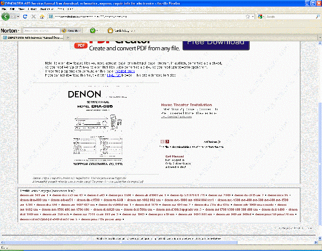

Hi John - you can download a service manual from here - DENON DRA-685 Service Manual free download, schematics, eeprom, repair info for electronics
Check around the net for more info. I don't have any experience with Denon's - sorry.
I can't seem to download the manual...it directs me to a PDF reader (don't need one)
In the lower portion of the screen you should see an image of the pdf 1st page. To the right of that should be the words "get manual" - click on get manual phrase in what looks to be a sort of burnt red or brown color.
