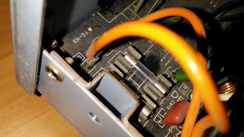

So I pulled off the cover this evening to take a look at the protection circuit, I was going to replace the caps because I don't have an ESR meter (and to use an ESR meter, the cap has to be removed anyway).
I've disassembled my fair share of PCs, game consoles and even CRT arcade monitors/CRT TVs, and never have I seen the board interconnections like this before.
It looks like wire wrapped around a long header pin? Surely this wasn't the pinnacle of Japanese electronic engineering in the early 90s? The amp has quite a few of these connections, so I don't think it was a home job...?
It looks to be a pain to remove this speaker terminal/protection circuit board. It has a number of these connections, the screw holding it to the back panel has a cap soldered to the end of it .. this is all odd looking to me!

Wirewraps were really common in 70's and 80's gear. Done correctly they offer a better connection than solder (really) because the wire cuts into the post.

Mooly, thanks for info. After some googling and youtube, I notice that a tool is required to properly do it.

If you need to undo a wire wrap as a one off then its OK to remake the joint with solder, its not worth investing in the correct tools for such occasional use, and to do a wire wrap as good as the original isn't easy.
