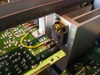

A piece on one of the outputs had been blown away :S
(the one with the yellow wire on the downside of the
circuit board. (isnt it strange with a wire?? maybe it has
been repaired before, dont know)

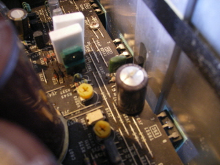

One of the Caps also blown. (the brown one between the two
biasing pots) It came some stuff out of the cap, hard to see
on the picture.
And before i got the power cord out it starded glowing somewhere didnt have time to see exactly what part.
But i found that a GREEN 😉 transistor is in very bad shape.
Nearly shattered in two. Hard to see but its the same picture
as the broken CAP.

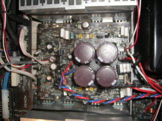

After a couple of hours measuring i got this far.
www.itxpress.se/2434.jpg
komponents marked with yellow was broken.
and marked with green are tested OK.
