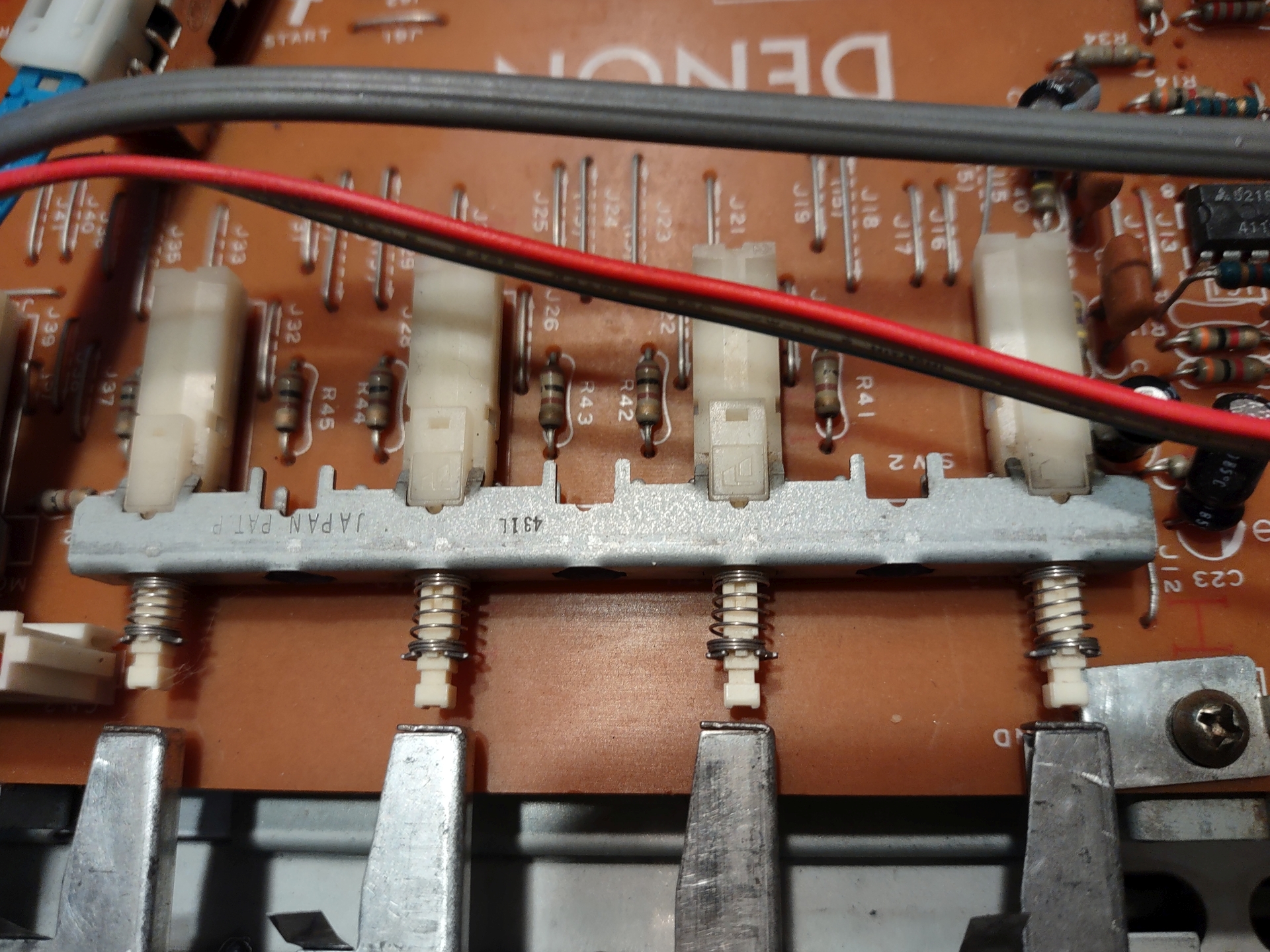

Yes! I just got done de-soldering, cleaning and re-soldering the Volume and Balance pots. I decided to play some music through the unit. At first, the right side was completely dead, BUT when I pushed in the VIDEO button (the connected source) all the way in on the front, it immediately played perfectly! So, I assume you're talking about these right? Remove, clean and re-solder?
So the volume related problem disappeared?BUT when I pushed in the VIDEO button (the connected source) all the way in on the front, it immediately played perfectly!
If so then you have the issue of oxidized contacts in the signal selector path.
In addition to the input selector switches (Tape 1/2, Video/Aux etc) you need to clean the Monitor switch - it is the "last man standing" in the signal path and gets very rarely used so bad contacts inside are likely.
I would start from just working each switch tens of times to see if any change happens.
At least in my amp, the volume problem was caused by the input selector (the one with the flat blue link; rec out in your amp). It's possible that the input selector push-buttons are in the same condition and need to be cleaned as well.Yes! I just got done de-soldering, cleaning and re-soldering the Volume and Balance pots. I decided to play some music through the unit. At first, the right side was completely dead, BUT when I pushed in the VIDEO button (the connected source) all the way in on the front, it immediately played perfectly! So, I assume you're talking about these right? Remove, clean and re-solder?
That should be the output signal (for recordings) selector and would affect sound in case of e.g. equalizer being connected in one of the tape loops.(the one with the flat blue link; rec out in your amp)
Yes!So the volume related problem disappeared?

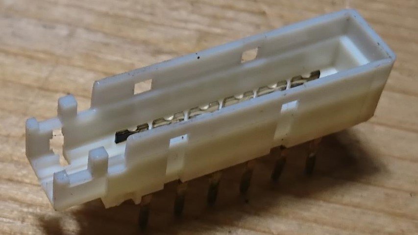

Last night I was running out of time so with a small jewelers screwdriver, I carefully lifted the plastic backside of each input selector switch (the white ones) and using the extension straw, sprayed the last amount of D5 I had in the crevices. I then worked each switch about 20 times. I played music through each of the inputs and so far, the Denon is working like its old self again.
I can continue to the blue selector switch today but all I have left is CRC Electronics Cleaner or WD40 Contact Cleaner. Ordering more Deoxit will take 5 days, probably due to Christmas orders. Going forward, are any of those usable or would you suggest I wait for more Deoxit to arrive?
Nice pic... Yes, still on the agenda but I need to get a better de-soldering tool. I've been using de-soldering wick and it's very time consuming. I saw a guy on YouTube with some kind of round push-button tool that seemed to work better and faster. Still researching it.
To clean switches once they're opened, would you recommend 91% alcohol, Deoxit or something else?
Yes, so far so good thanks. At this point I plan to de-solder, open and clean all the switches. As I said earlier, even a light spray cleaning to the white input selector switches proved that my problem was related to one or more of these.At least in my amp, the volume problem was caused by the input selector (the one with the flat blue link; rec out in your amp). It's possible that the input selector push-buttons are in the same condition and need to be cleaned as well.
