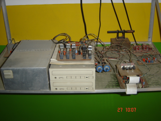

I have running actually a couple of them. One is a simple FlyBack using UC3842, a MOSFET, and a recycled core from a PC monitor. This gives me +-14V to power a couple of TDA2006 and 2003´s, and +12 and +5 for 2 old PC cd readers, and it is working from about a decade all weekends when I´m at home, almost 15 hours per day. In some circumstances of power line failure, I could us it once started, from 220V (Nominal line voltage in Argentina) down to 36Vac (you obviously cannot believe me, but I swear that it is true). (the aluminium box in the first photo).

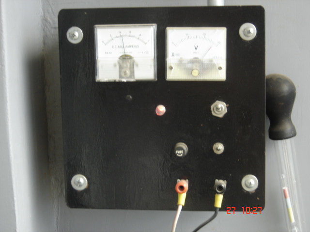

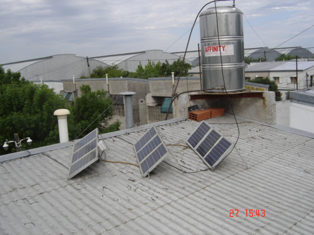

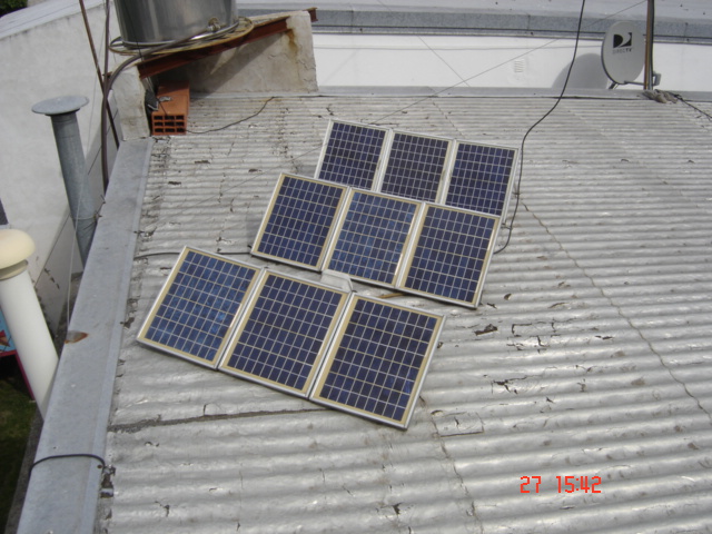

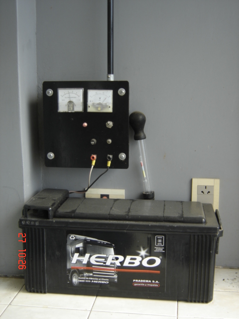

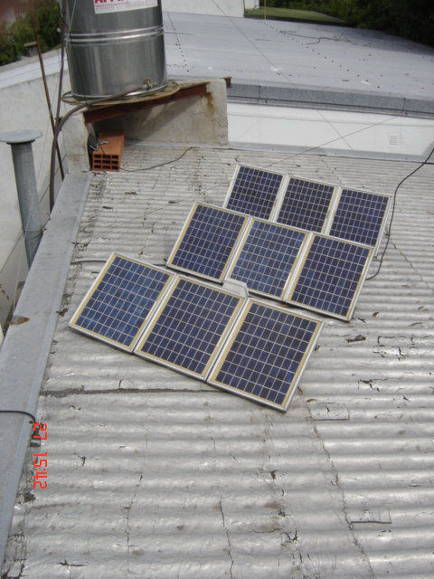

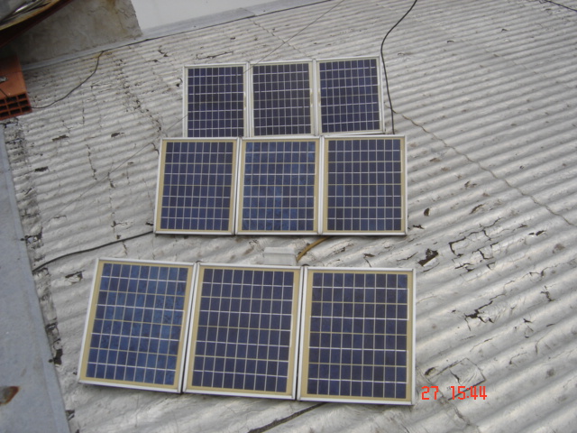

Other is a solar cell battery charger for my ham radio station. It has benn constructed almost all using standard discrete devices, for example, a TS556 (CMOS version of 556) is used as PWM'er. It consists of a 4047 clack generator driving them in antiphase, and amplifying the current, it finally get the gate of a two buck converters working 180deg out of phase. (The black box with analog instruments).
This is your problem, not mine. I saw working with only 36VAc and is sufficient for me. The design parameters was standard 90-240VAC, but once started at 100V, is collapses about 30VAC with light load as a class AB audio amplifier with low volume, but not zero.
