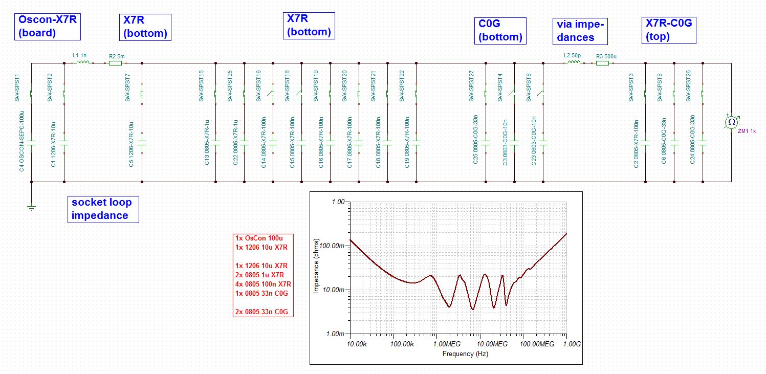

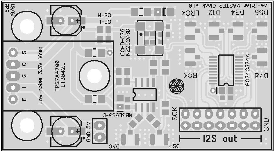

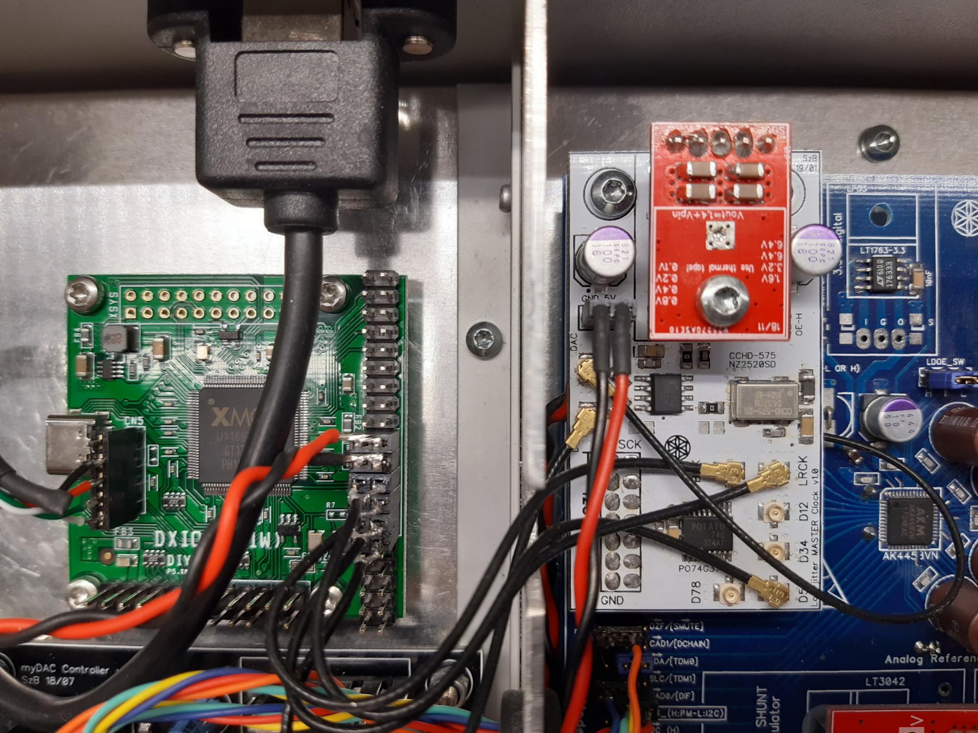

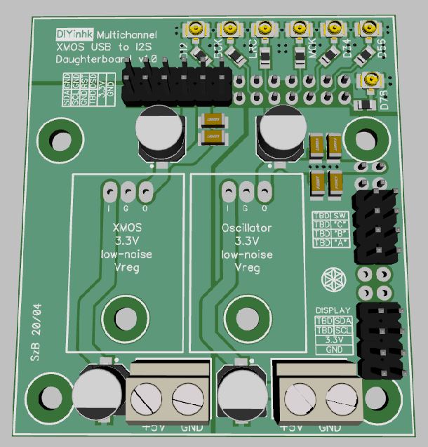

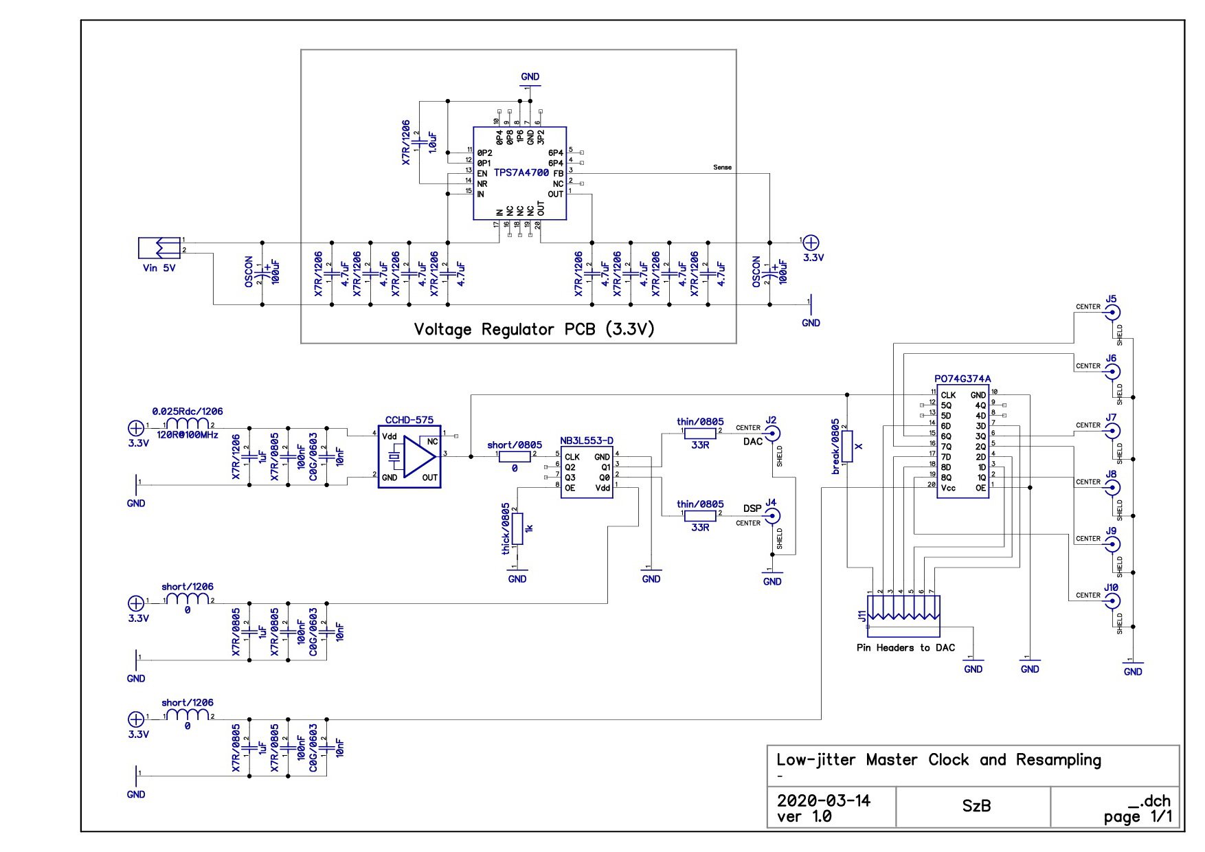

My setup contains the following elements (see photo and schematic):
- DIYinhk USB multichannel XMOS board
- my AK4458 multichannel DAC
- my reclocking board with Crystek CCHD-575 crystal, NB3L553-D buffer and PO74G374A logic gates, supplied from a TPS7A4700 3.3V regulator
The circuit is working good, although it is under testing yet. Before this setup I fed my DAC direct from a MiniDSP USBStreamer, without reclocking the I2S signals. The improvement is obvious: there are more microdetails, finer textures, the instruments are better focused and more separated. Brass instruments and violins are excellent detailed. Overall a more natural presentation, not so fuzzy like a typical "digital" sound.
But! After some experiments I must say that it’s not an easy task to design so a HF circuit correctly. Depending e.g. from the applied bypassing, the sound character changes too! By not adequate setup the higher transients can be too harsh/grainy and the midrange-bass not so articulated, what I'm actually experiencing with my setup. I’d like to make a little technical “walk around” here, to find and understand the optimal environment for such a circuit.

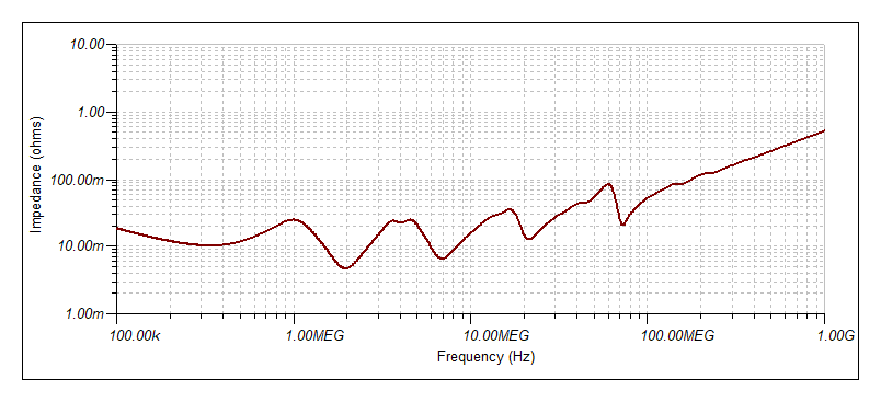

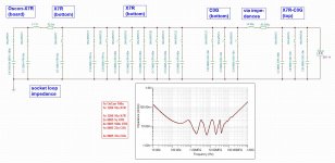

Please find attached an excel-sheet, adapted from this book. I’ve made it for myself, to understand the basics and to have a good starting point. The applied models are relative simple (capacitors modelled only with capacitance and a serial inductance), but I think it doesn’t harm to make a check like this and make some thoughts…
Another try is to collect as good as possible spice models from the manufacturers (Murata, Kemet, Panasonic etc.) and drop them into a simulator (e.g. TINA). Feel free to experiment with that!
My next step will be to make some jitter measurements with injected noise into the power lines. Will try simply to superpose e.g. 0,1V sinusoidal signal with changing frequency and see what happens on the clock and other outputs… I hope I can determine a reasonable targeted noise floor what a supply line must be achieve to get an appropriate audio playback.
I’ll try to split the psu-lines of the ICs (clock, buffer, gates) and supply them with different voltage regulators. TPS7A4700, LT3042, shunt, LF33CV, etc.
So, I leave rather no questions at the end, because I’ve to experience it myself, but still the message: if you feel to say some advice please make it! 🙂

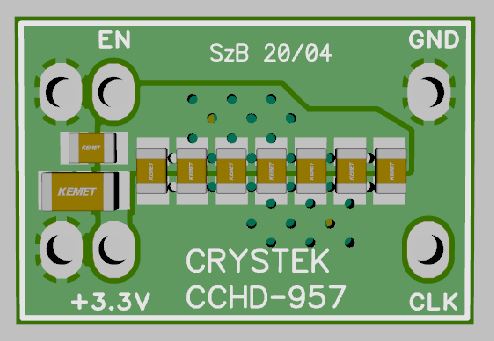

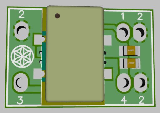

I've decided to make a whole new concept, with changeable oscillator. The first challange is to design a proper adapter-pcb. I took some ideas from Ian (Canada), and adapted with my experiences and know-how.
The basic adapter solution has the problem, that the power and ground connections are forming a relatively large (>10nH) loop (because they are in the opposite corner of the 2x7 pin socket), making the PDN impedance worse in the HF region. I've expanded a little the pcb area and added 2 extra GND pins beside the power pin to keep the loop as small as possible.
If you are putting so much effort in decoupling techniques, why aren't you using ferrite beads? They significantly reduce the RF current through the groundplane (and thus common impedance coupling). It also reduces resonances because ferrites are lossy at high frequencies.
Also, it's generally not recommended to put a groundplane under an oscillator. Some oscillators have high impedance amplification stage (like the jfet in a TWTMC version). This allows for easy coupling from and to the groundplane and thus jitter and polution of the ground.
I also recommend checking out PCB Toolkit from Saturn PCB. It's a neat calculator for calculating parasitic inductances and capacitances (and various amounts of other things).
Personally I think a single 0402 capacitor (or reverse topology variant), a ferrite and 3 terminal capacitor (like in the Murata paper you listed) would give a better result. The Murata capacitor can be quite big in value to reduce the effectiveness at low frequencies.
Parralleling capacitors for hf decoupling doesn't work as effectively as a single small capacitor. Mainly because they form a resonant circuit on their own!
A 0805 capacitor has a width of 1.2mm, If you would place them right next to eachother we would have a distance of 2*1.2mm (center of pad to center of pad). This would give a rough inductance of 2nH. The two capacitors form a loop and are effectively in series. This results in a LC circuit with 2nH and 16.5nF -> 27.7MHz.
Though I assume no ESL of the cap here and there is practically more space between the capacitors. The effective resonance frequency will be lower. As you can see it can get really close to the oscilators fundamental.

Thanks for the comments!
So, generally I do not use 0402 components, these are simply too small for hand soldering. I've experimented in the simulator with some 0603 types but I do not feel a need to use them, 0805 are doing the job just fine. The impedance between them are about 0,1nH (do not included the cap inductances itself of course)! How did you calculated the 2nH???
I know the Saturn software, but I must say it is not very usefull for me... I use e.g. this site: https://www.eeweb.com/tools/rectangle-loop-inductance
Ferrite beads are excellent to achive a good noise performance, but they increases drastically the supply line impedance, what I do not want actually. I will supplying all the 3 ICs (osc., buffer, potato) from different voltage regulators, so the suppression of emitted noise is not a task to obtain. Or am I wrong?

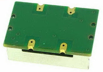

The oscillator will be the Crystek CCHD-957, mounted originally an a small pcb, see photo. I do not see a problem with ground planes...
The Murata 3 pin caps (NFM) could be a good option anyway, but I do not have a real experience how they sound...!? Perhaps will make a pattern for that, and if I don't like it simply replace with a short.

0402 is doable for me, you need good tools and some practice though. As I said there are also reverse geometry parts which are nice for their low ESL properties. These are easier to solder because they are the size of 1206 I believe (don't quote me on that though).
The way I calculated the trace length is by using the SaturnPCB toolkit. I used a conductor with of 0.7mm. The PCB height is 1.6mm (standard FR-4). This resulted in a inductance of 0.5863nH/mm. The minimum tracelength is 2*1.3mm (center to center, it's the padwidth of a standard 0805 capacitor). 2.6*0.5863 = 1.52438nH. I think I made a mistake somewhere.
I've added an image so you can see what I did.
Personally I find it much easier to think in currents when looking at decoupling circuits. Decoupling capacitors are there so the loop current is very small. They also function as RF short circuit to ground. A decoupling capacitor however doesn't reduce the current!
Groundplanes are largely inductive. If we then have a high RF current through our groundplane we allow a voltage gradient to occur (= common impedance coupling). We clearly don't want common impedance coupling so we have to reduce the RF current. The only way to do this is to increase the impedance for high frequencies and keep the impedance low for low frequencies! This means we have to use some form of inductor. Ferrites are often used because they become lossy at high frequencies (it's an actual frequency dependant resistor).
Properly simulating ferrite beads is quite tricky and I'm struggling with that part myself. It's mostly hard because their lumped element values change over current and over frequency. If you are interested you might want to check out these articles:

I know you aren't using the TWTMC as your main oscillator. However the Crystek CCHD-957 also has a low jitter oscillator circuit in it's enclosure. We don't know how they build it (unless you take it apart). The best we can do is assume a worst case scenario and assume it's high impedance!

I wonder if it could work to build a fairly simple 10MHz, because of a few points :
1. in audio, sinewave or squarewave clocks are required. According to some posts & docs, it's easier to build a sinewave MClock, because the the signal is simpler, and with lower phase nosie than squarewave clocks (I read that, but didn't verify myself).
2. we have on the shelf of Digikey / Mouser etc, some OCXO, sinewave, 10MHz, 10ppb max stability, with pretty nice phase noises => from 70USD !
thus, my guess is : that simple !
- you pay 70USD for this sugar piece
- put it on tiny PCB
- connect a BNC 75ohm connector between the GND & signal pins of the OXCO
- power the OCXO by connecting its Vcc & GND pins to a nice PS
