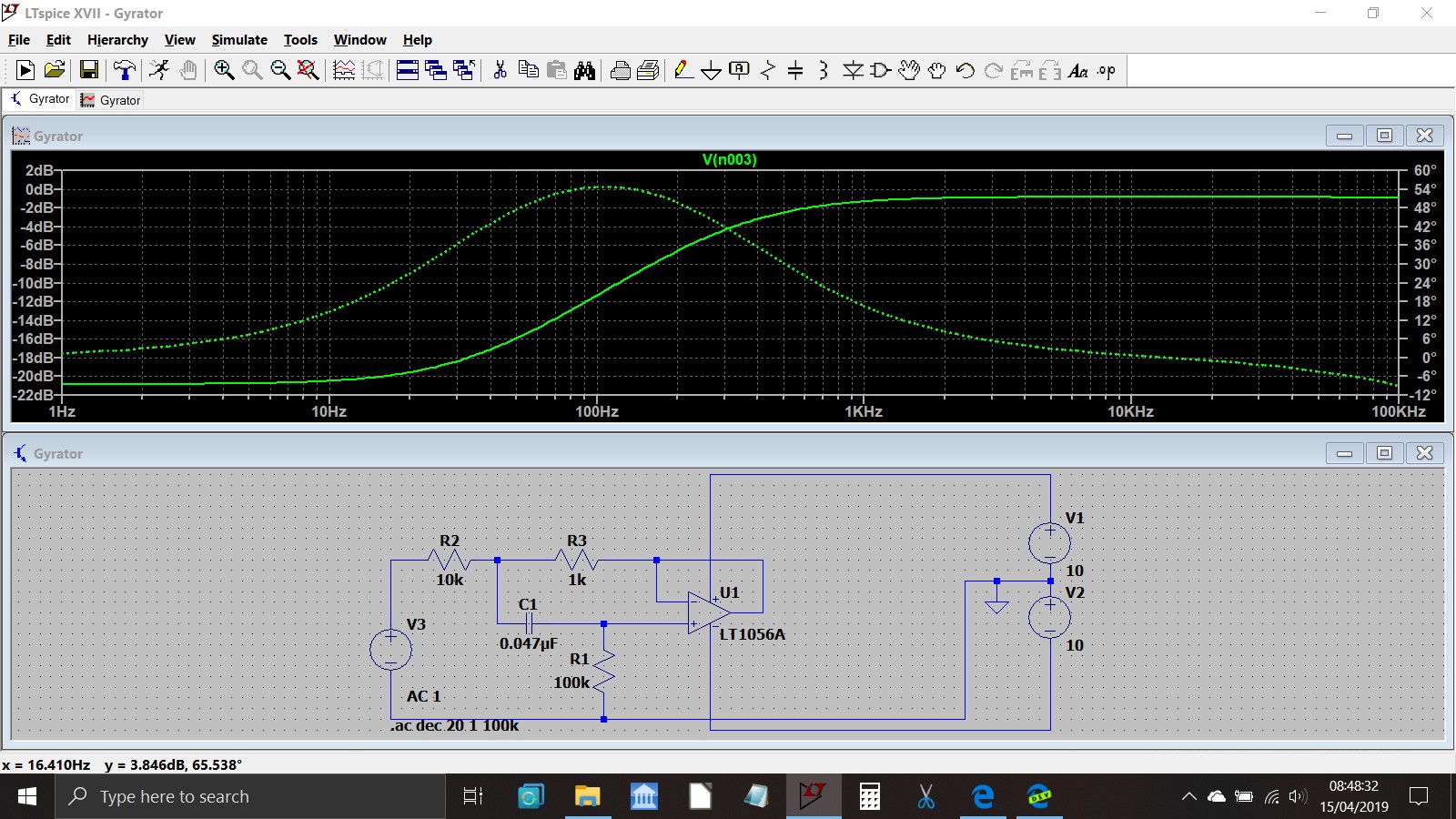

The attached circuit is a working gyrator circuit to emulate an inductance.

I'm not so sure the simulation is working at all tbh. The biasing looks wrong on the opamp (single rail) and the cap is effectively working into the low impedance of the supply.
Snip the opamp out and link the 20k out and you get the same result.

Limiting my google search to only .edu sites, it seems, I found a gyrator that emulates an inductor. The schematic is attached and, if my memory servers me right, the voltage leads the current by 90 degrees. Aging is making easy concepts like 'leading' and 'lagging' difficult to imagine concretely. I assume, if the voltage peak is reached 90 degrees before the current peak, it means, the voltage is leading the current.

Thanks, Mooly. I am reading the document you linked, and I can say, it is a very interesting reading. Till today, I didn't know there were tunable gyrators, and hence, tunable equilizers.
The author stated clearly that the functioning of gyrators is a difficult concept to grasp and focuses largely on explaining their properties.

Finally, I succeeded to simulate a gyrator that behaves like an inductor. Connecting this simulated inductor in series with a capacitor produced resonance at 4.7kHz. The circuit is attached.
Ignoring the resistances, the calculated resonance is at 5kHz.
Plotting I(C2) gets a peak at 4.7kHz.
My first, very inexpert impression, is that the current curve may not be adequately selective. If I remember, sharpness of resonance peaks depends on the Q of the inductor.
