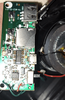

I am in the process of building a set of speakers specifically for this little Bluetooth amplifier, with some success. I am getting 70 dB at 1 metre with these connected to large vintage floor standers of 89 dB sensitivity.
I had a few questions though.
Images of the speaker, the internal board which seems to have an 8002D amplifier IC doing all the amplification work.

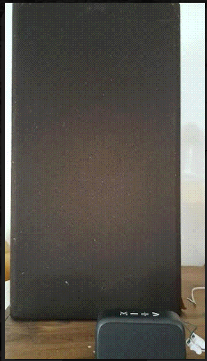

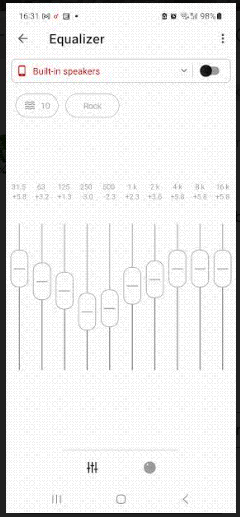

This is the image - representation of the system. In front is the Bluetooth speaker unit, with the internal speaker wires extracted out of the case and connected to a clip-type connector. In the background are the SONY speakers. The other image is one of the Musicolet app equalizer settings that gives me better bass and clarity.

This is a nice setup for listening, however I cannot take these speakers with me, so I will have to build an open baffle pair with a 6 inch woofer and some sort of tweeter. The speakers are connected in series.

There are also videos of connecting cheap Bluetooth speakers to large speakers, but none of the videos I have seen make use of an equalizer which is vital with any Bluetooth speaker, even commercial ones, to obtain clear sound.

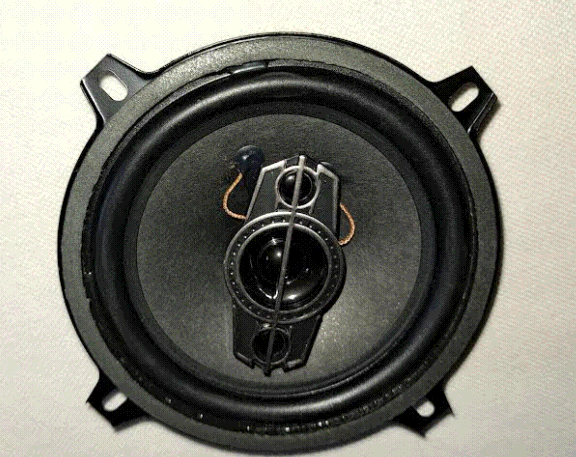

Testing with two car speakers gave much better results in the bass, however the level of EQ required (this was in open baffle format) was very high. I am considering building a box for the speaker drivers just for the TablePro MG2 . The tweeter of the car speaker generated a lot of distortion, noise, so the wires to the tweeter were cut and the tweeter unit was removed. Sound was much better.

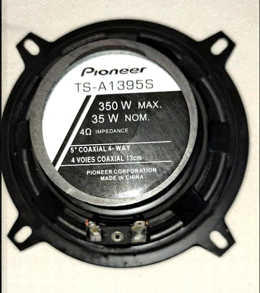

The Pioneer car speakers are one option, however I am open to online purchase of a set of speakers 2 inch 4 inch whatever.
