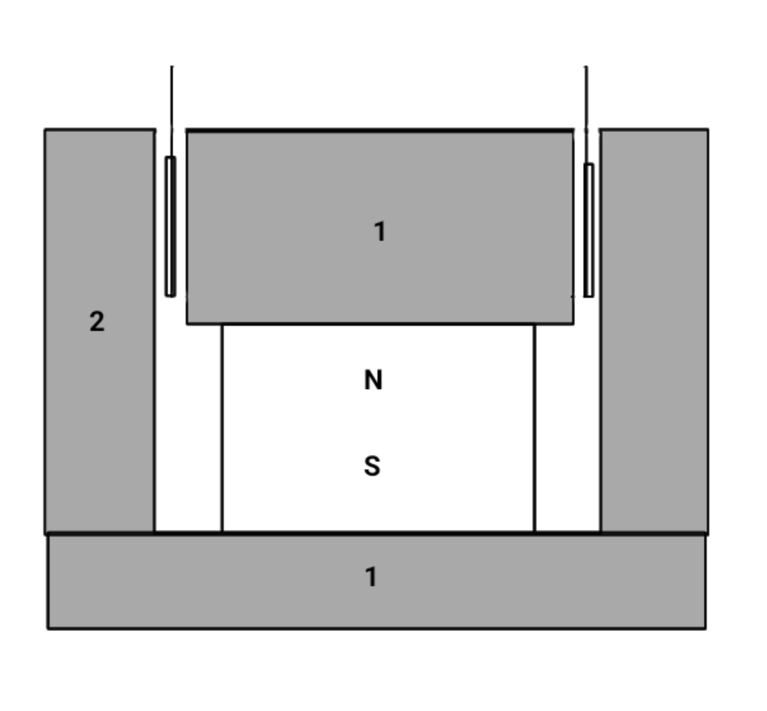

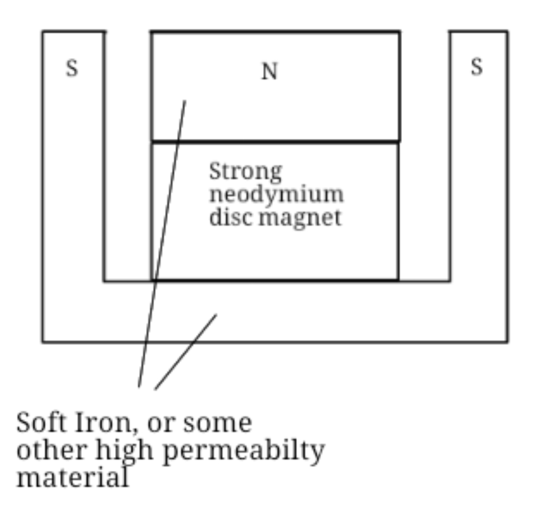

There may be something wrong with the magnet structure. I used a very strong neodymium magnet (lifts up to 40kg) with some S355 steel. S355 steel has somewhat ok magnetic properties, but it is not as good as pure iron. However, pure iron was not a good option, because nobody sells that stuff unless I order thousand tons of it. The coil is underhung, and gap is 2,5mm wide, I attached an image of it to this post. The coil has dc resistance somewhere between 4.9 and 5.4 and it's made ow 0.2mm copper wire. The magnetic gap width stays the same all the way to the bottom, but I think that's not the only problem, as my tweeter has narrower gap at the place where the coil hangs, but it has even higher Qts.
Well, it´s a great accomplishment making a working version. 🙂
Now it´s done.
Pure iron is unobtanium, but hey, you have what you have.
It was clever using a premagnetized Neo disk but it must have been H*LL assembling the magnetic circuit because they pull so strongly towards sides, (you said 40 kg 😱 )
You are losing magnet power there, typical is around 1.25mm. Again, you have what you have, not criticizing you.
Curious about voice coil diameter and top plate thickness.

Thank you JMFahey. Voice coil diameter is about 38mm and it has two layers of wire on it. Top plate is pretty thick, 20mm. The coil is underhung, and it has 5mm of room to move up and down. It's almost like in the attached picture, but the gap width stays the same all the way to the bottom. I don't know, maybe the saturation magnetization of the steel was still too low.

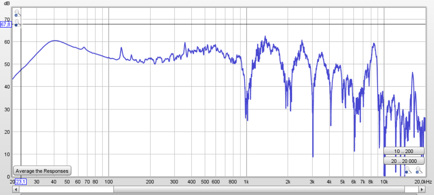

I will still attach the home-measured frequency response here. It doesn't look very good, because it's not measured in a good place with good equipment (I used a non-calibrated USB mic). However, it can still give some idea about the response. Also, when I measured with REW, some strange comb filtering appeared in the response. That does not exist in the actual fr, but it is probably caused by something in my measurement setup.
