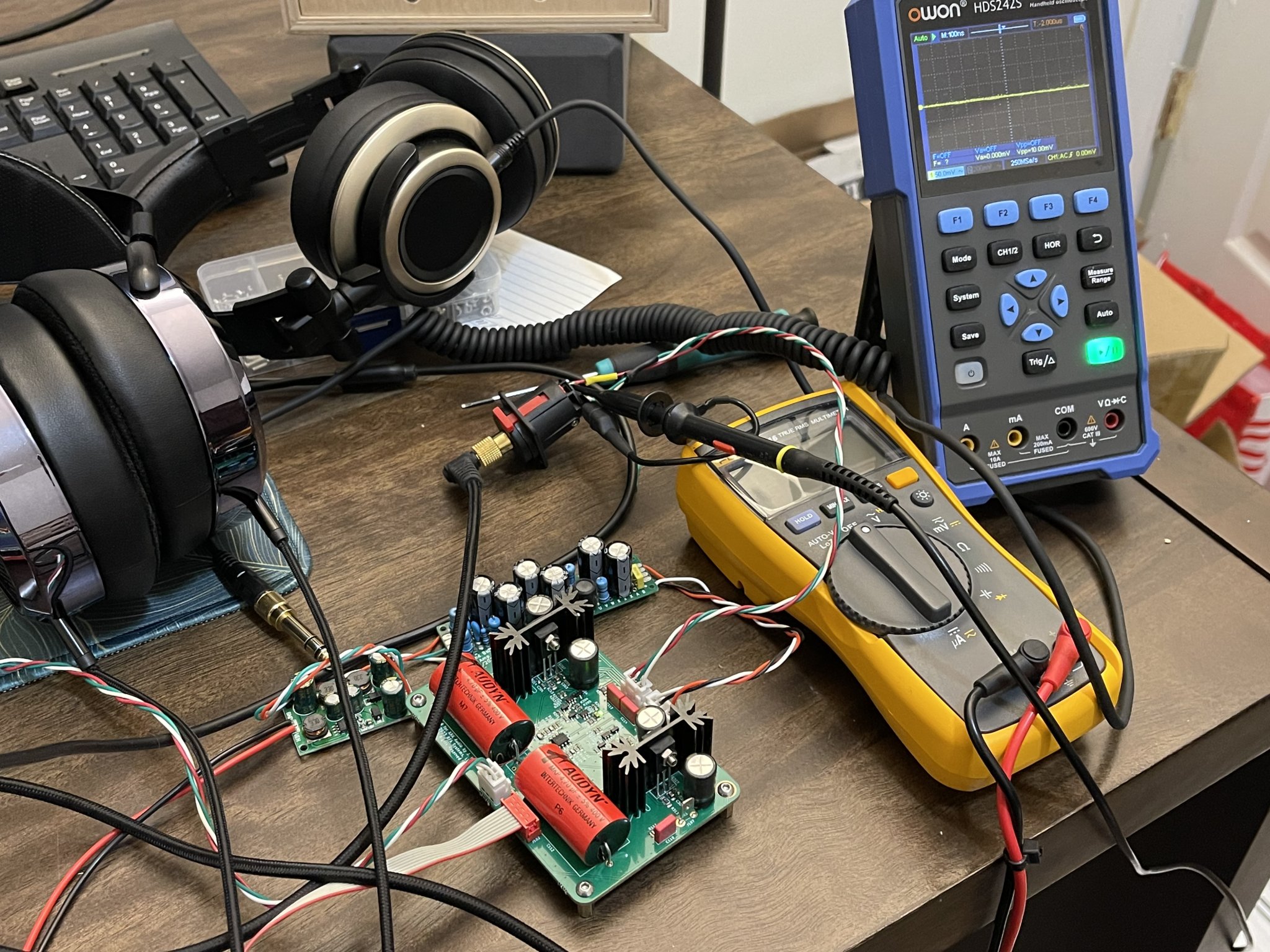

Here’s a photo of a built up amp board in operation:
With larger MKP caps only:

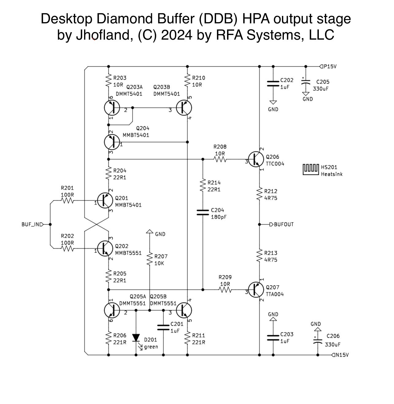

I initially struggled with an oscillation but chased it down to a feedback compensation cap that was too large. That’s all fixed now rock solid. A stability analysis on LtSpice pointed me in the right direction. So the schematic shows a 470pF cap needing to be replaced with 47pF. It’s an easy swap and I’ll do this on the SMT pre populated boards that I will be offering in my shop. I will also have bare PCBs for those wanting to assemble it themselves.

Here is schematic of the Diamond output stage:

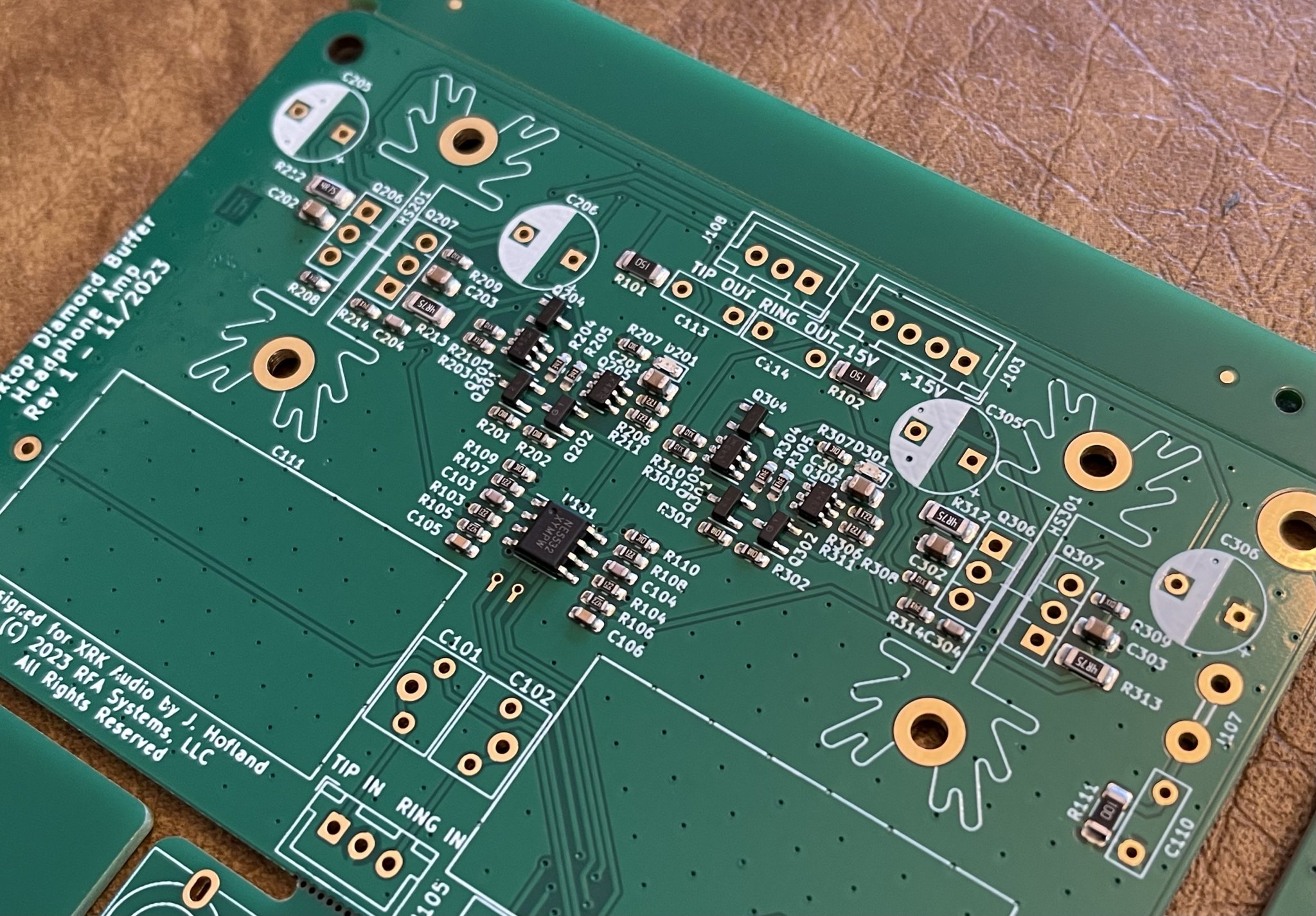

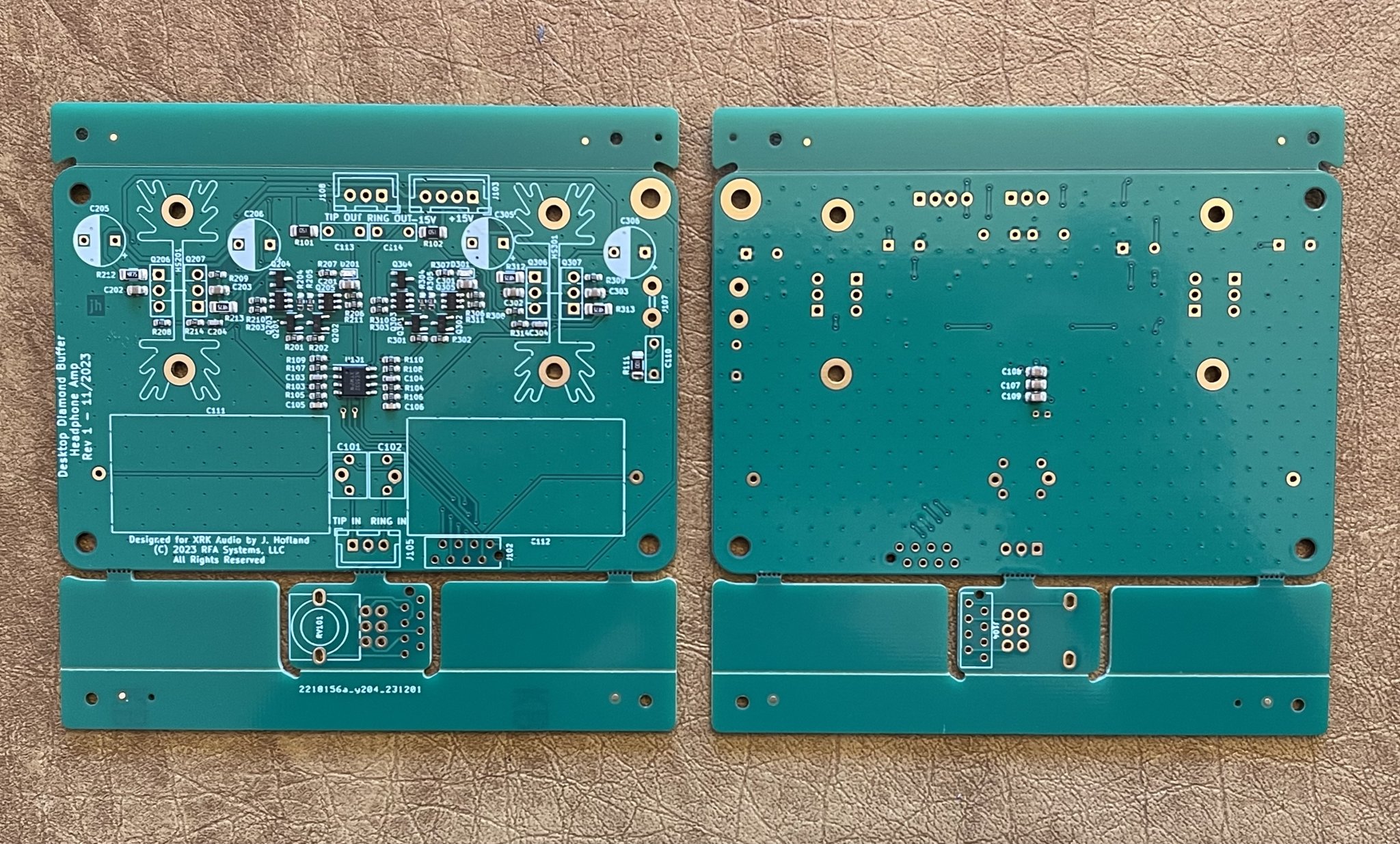

Here is a SMT prepopulated PCB so all you need to do is to install all the through hole parts:
Both sides:

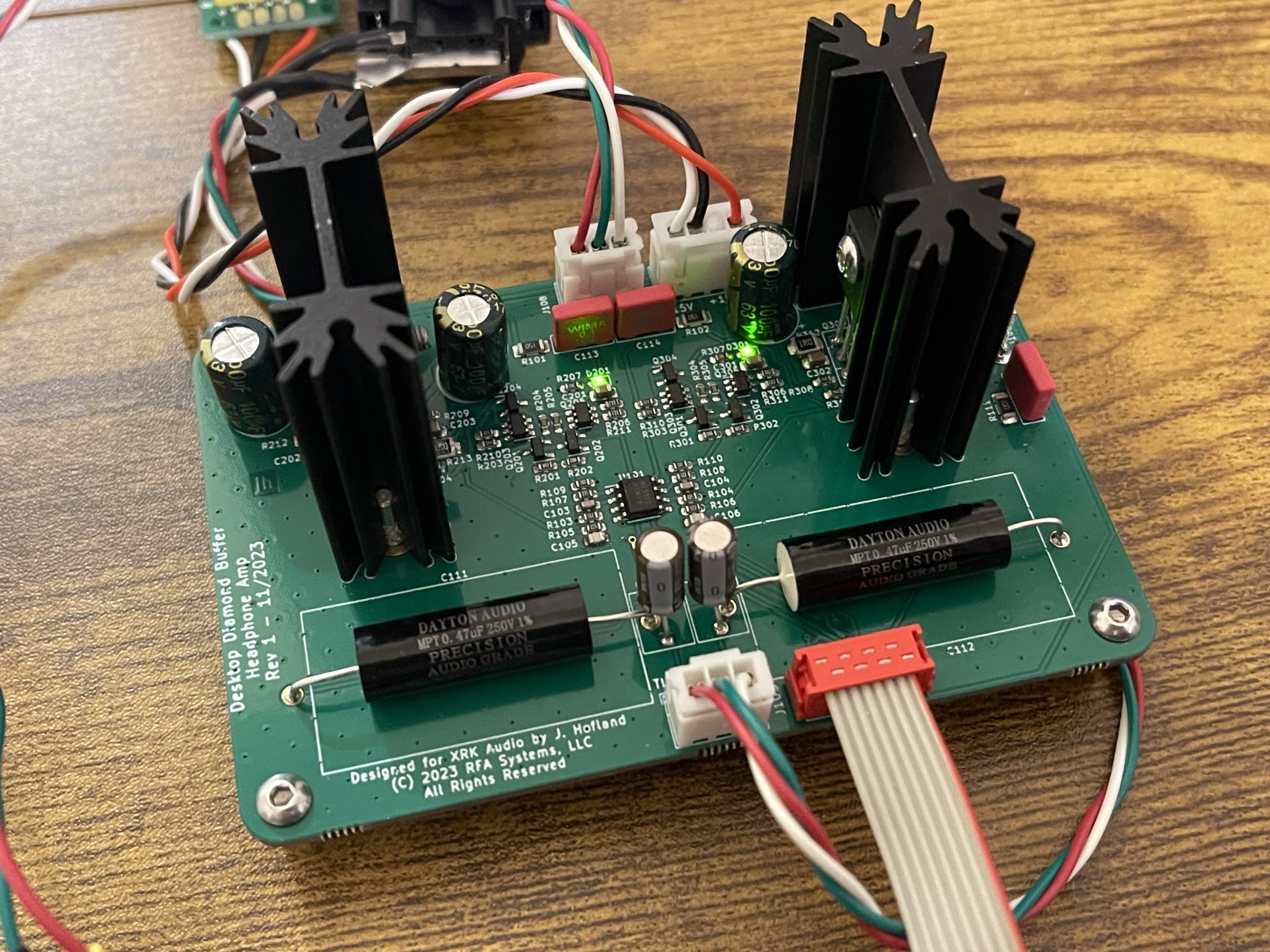

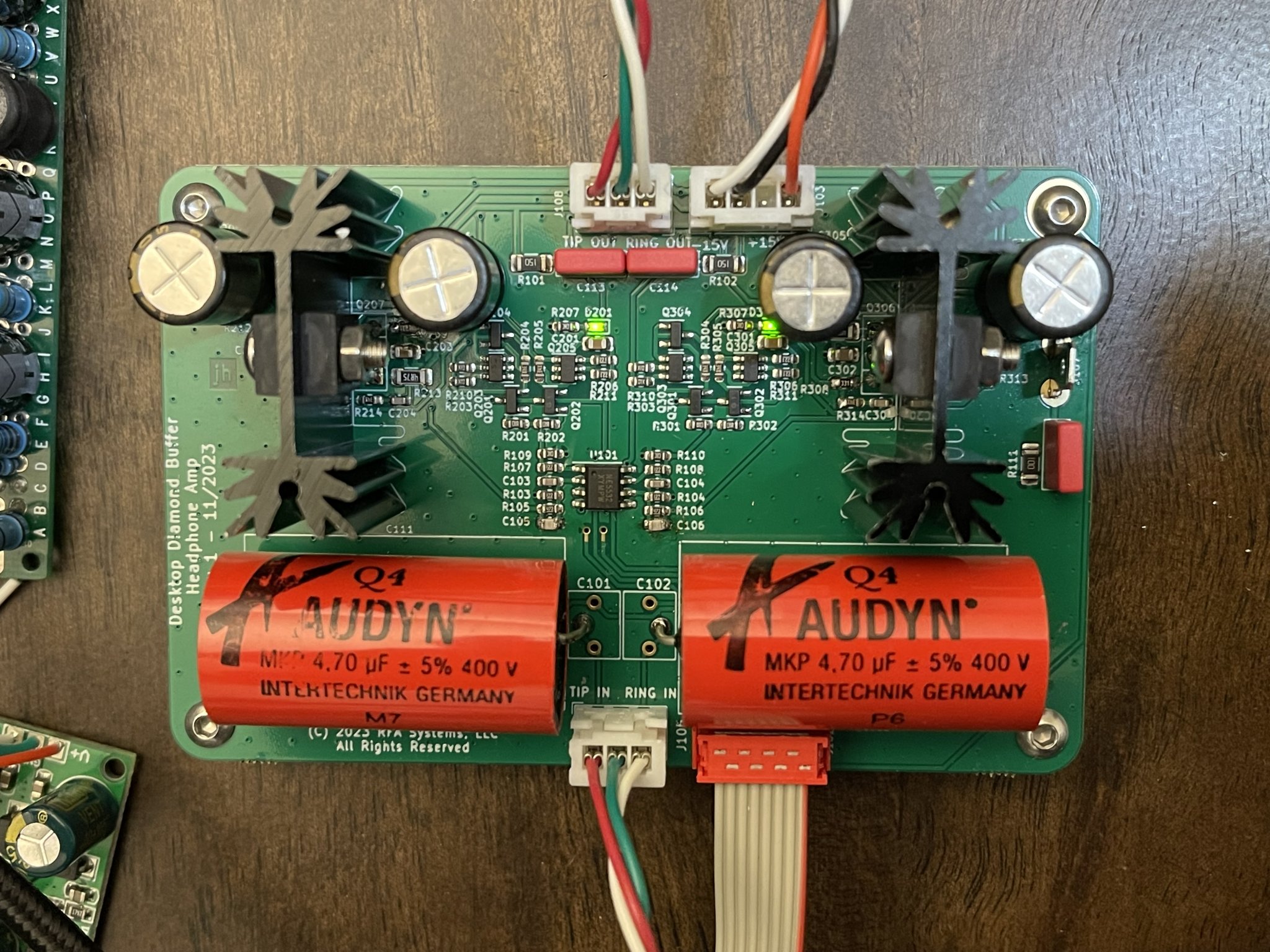

Here is the board assembled with big 4.7uF MKP caps:

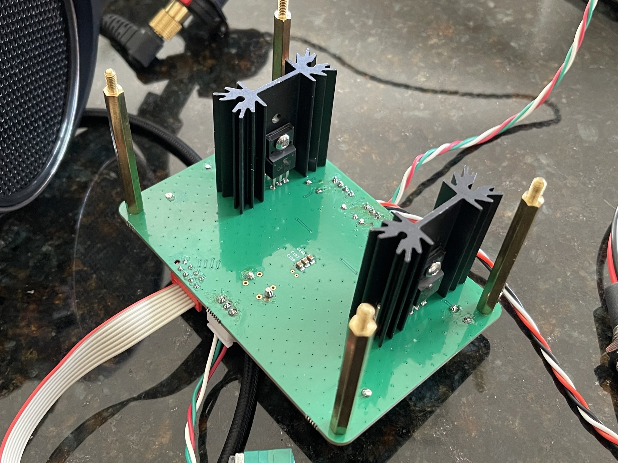

Standard BOM calls for ECB pinout TO-126 BJTs (Toshiba TTA004 and TTC004) but if you have some classic Toshiba 2SA1837 and 2SC4795 (BCE pinout) you can mount them in the bottom like I did here - leaves a cleaner look on top giving you lots of access to the parts:

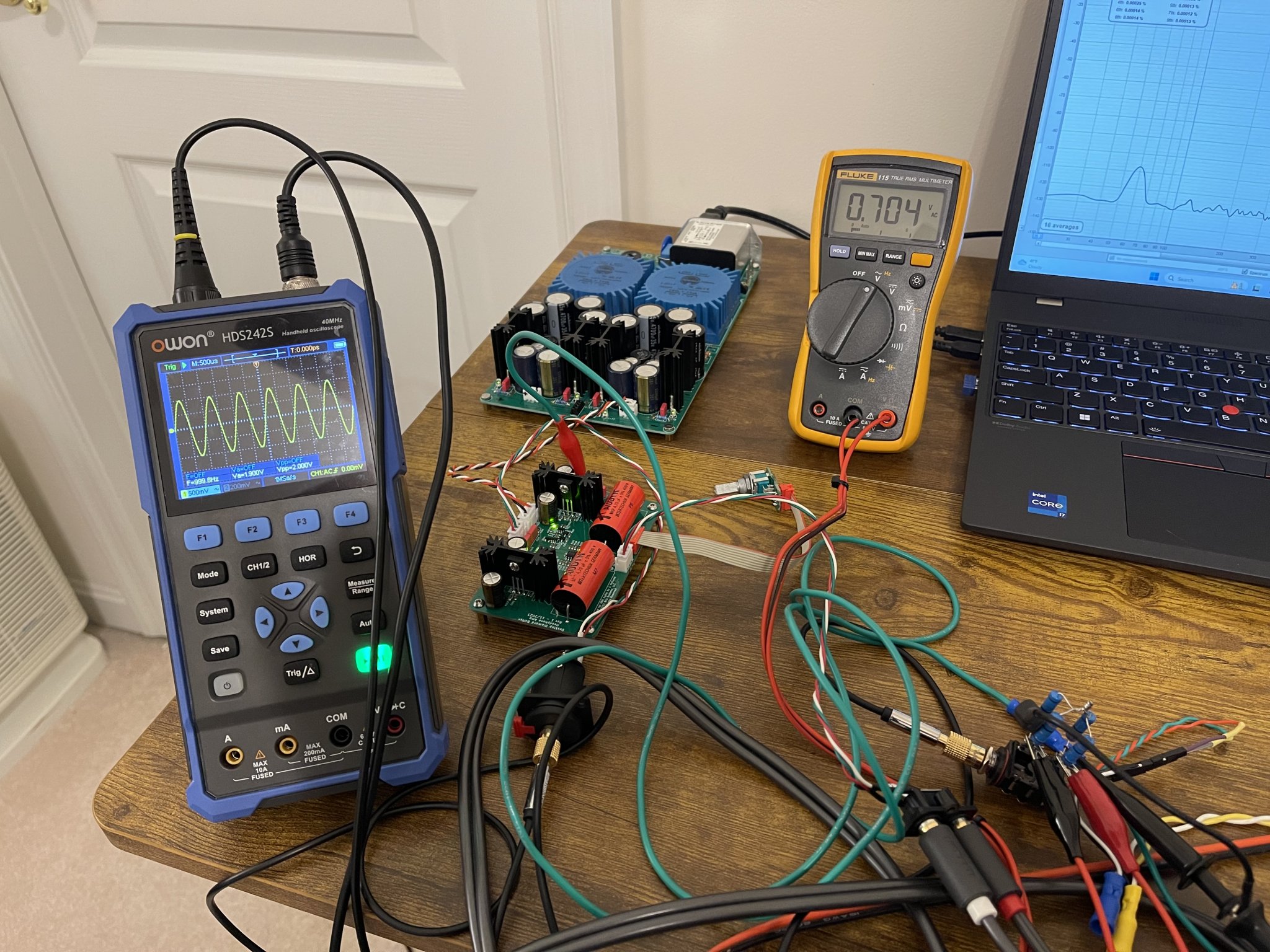

Testing on the bench:

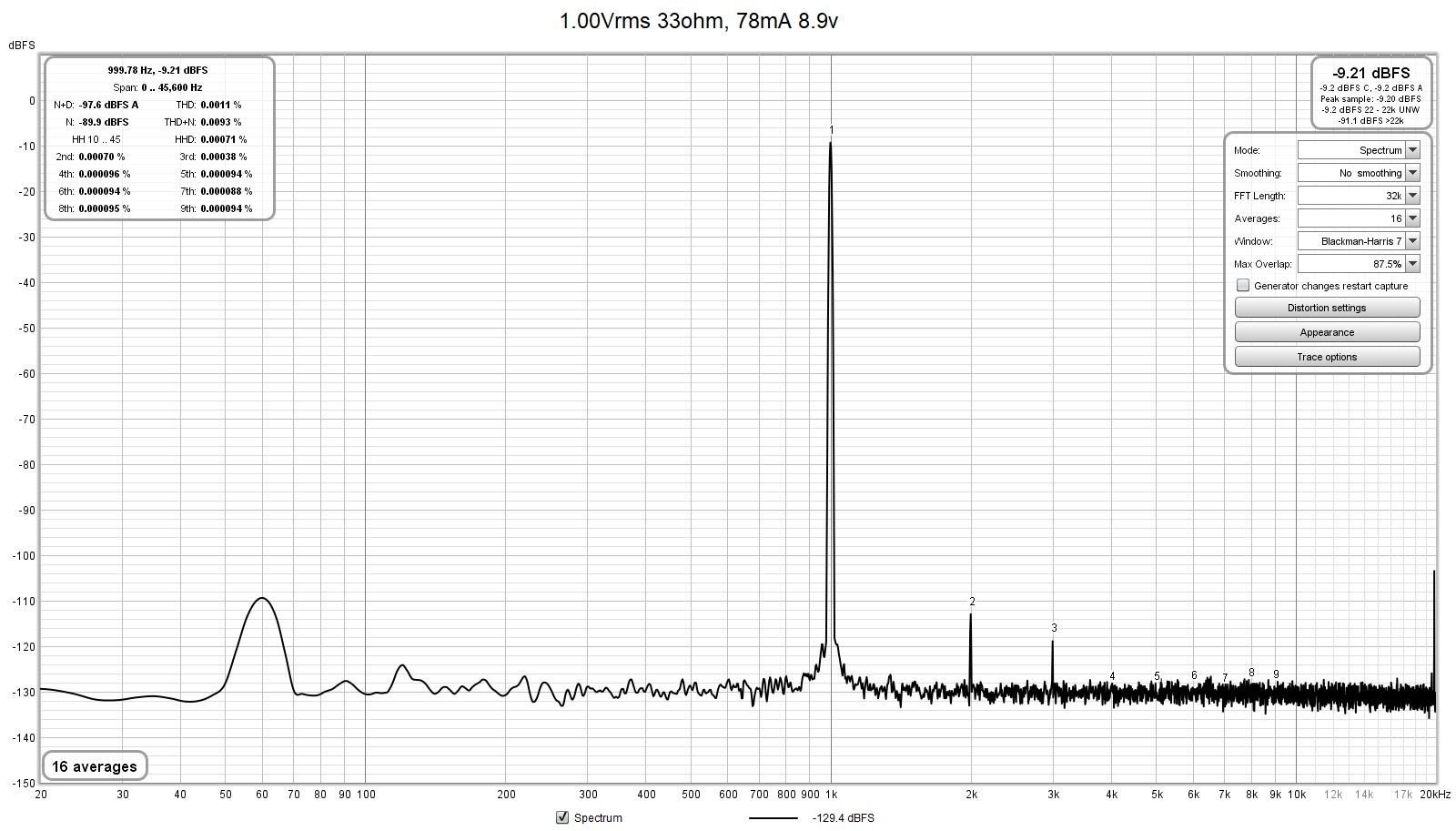

Nice low distortion but second harmonic dominant distortion profile for 1Vrms into 33ohms:

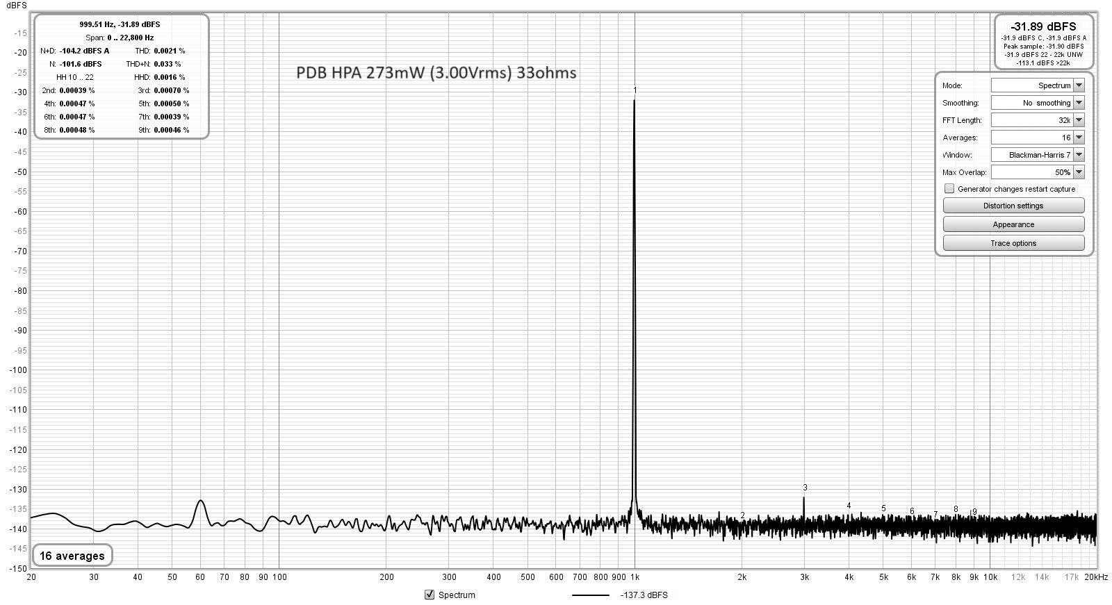

Hi X,
It looks amazing , specially harmonic profile lacking any higher order other than 2 and 3 order in Audible range,
i believe it sounds very lively and wide since Slew is high as well 2nd and 3rd order being close to each other in spectrum dominated by
second order.

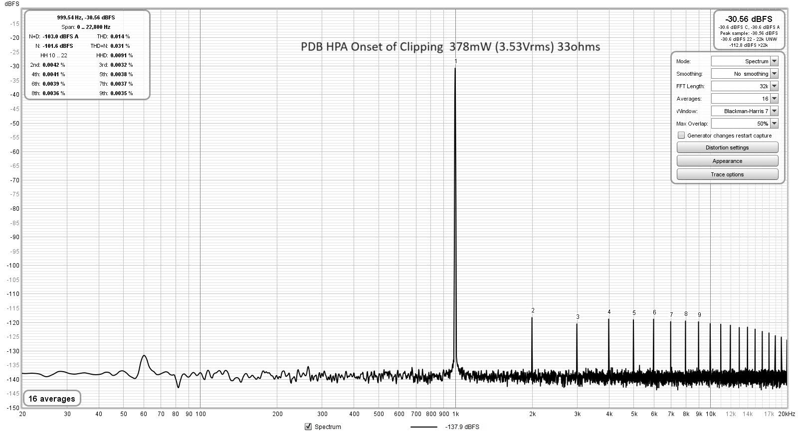

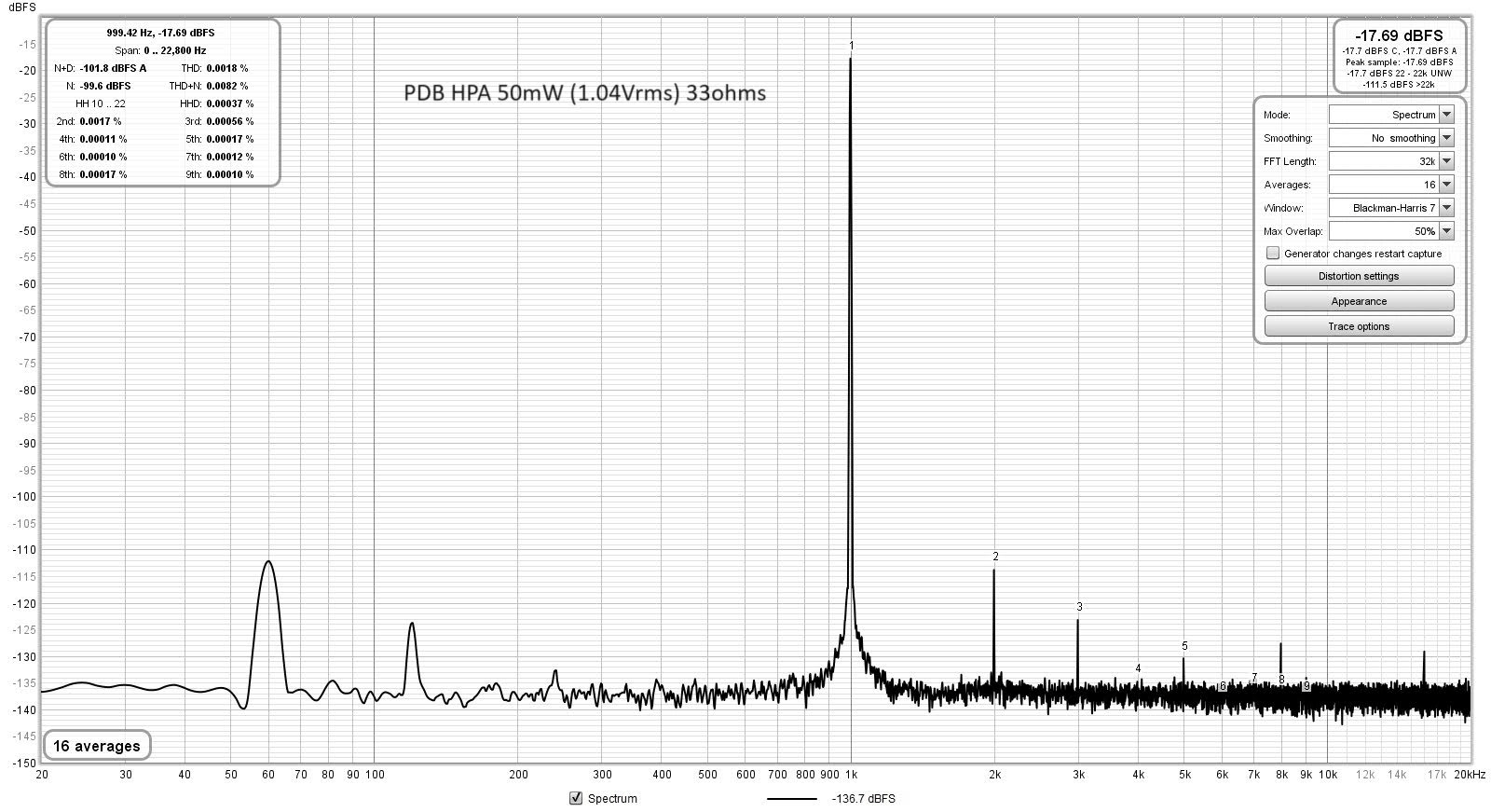

The higher orders do start appearing when you push the amp to higher power. I don’t have extensive testing on the Desktop variety yet as I did much of it with the pocket version (at +/-9v). For the pocket amp, the +/-9v rails only allowed a max of about 270mW and it left Class A at 125mW. Here is FFT of the pocket version at 270mW with third harmonic dominant but overall THD is quite low.
When pushed to clipping higher orders appear of course - this was about 370mW with the pocket Diamond Buffer HPA:
But, at typical sensible listening SPLs like 50mW, the harmonic profile is quite lovely:

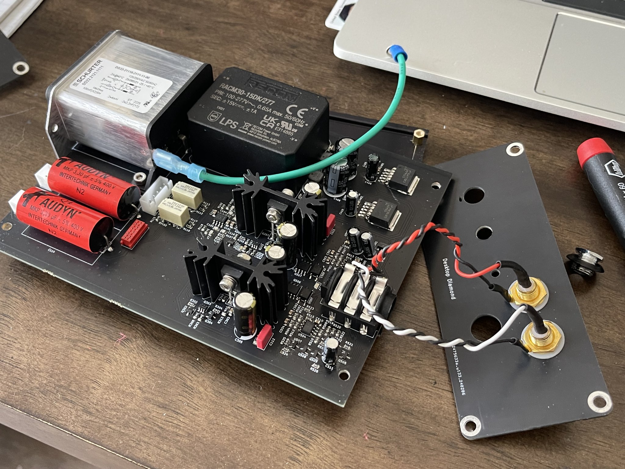

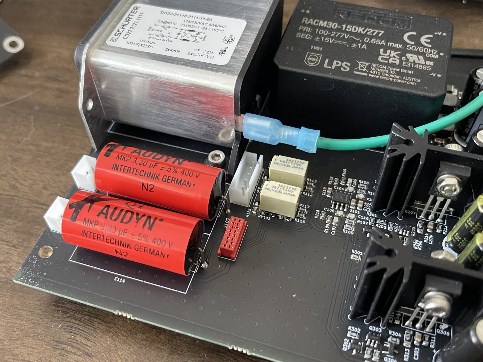

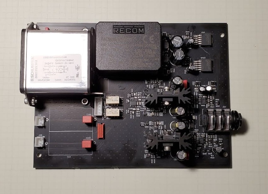

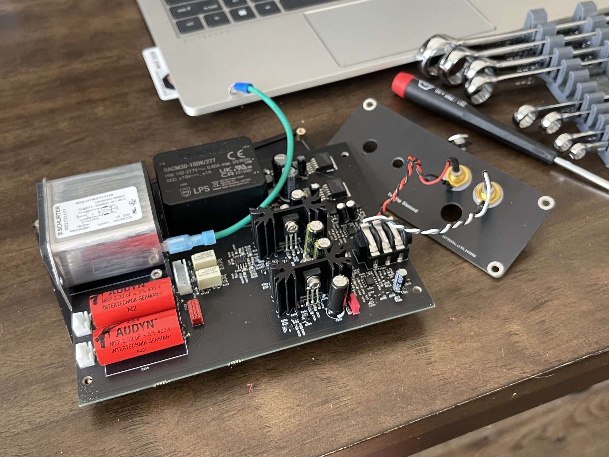

Jhofland is working on the commercial version of this amp for me. It will have built in AC/DC PSU, filter, and voltage regulators. Selectable gain with toggle switch (9/6/12dB), solid state relay mute and DC protection. All on one PCB. The Schurter IEC EMI/fuse/switch is single largest and most expensive part I think.

My specific question is: When using the large 4.7uF Audyn caps on C111 & C112, do I leave C101 & C102 unpopulated as in the pictures shown here? (Starting my build this weekend).
Thank you in advance. Dave M.

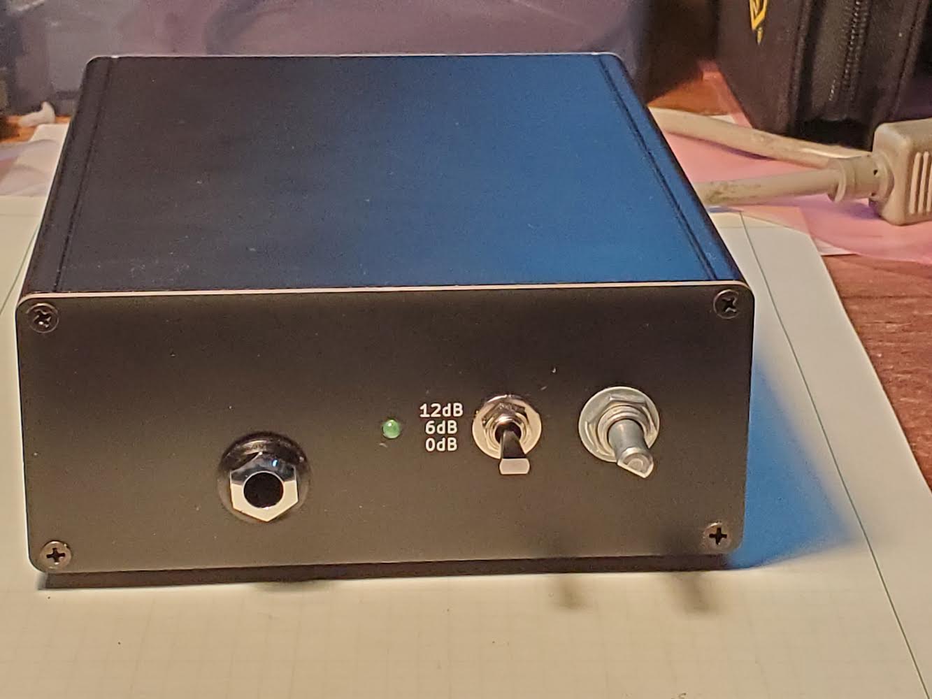

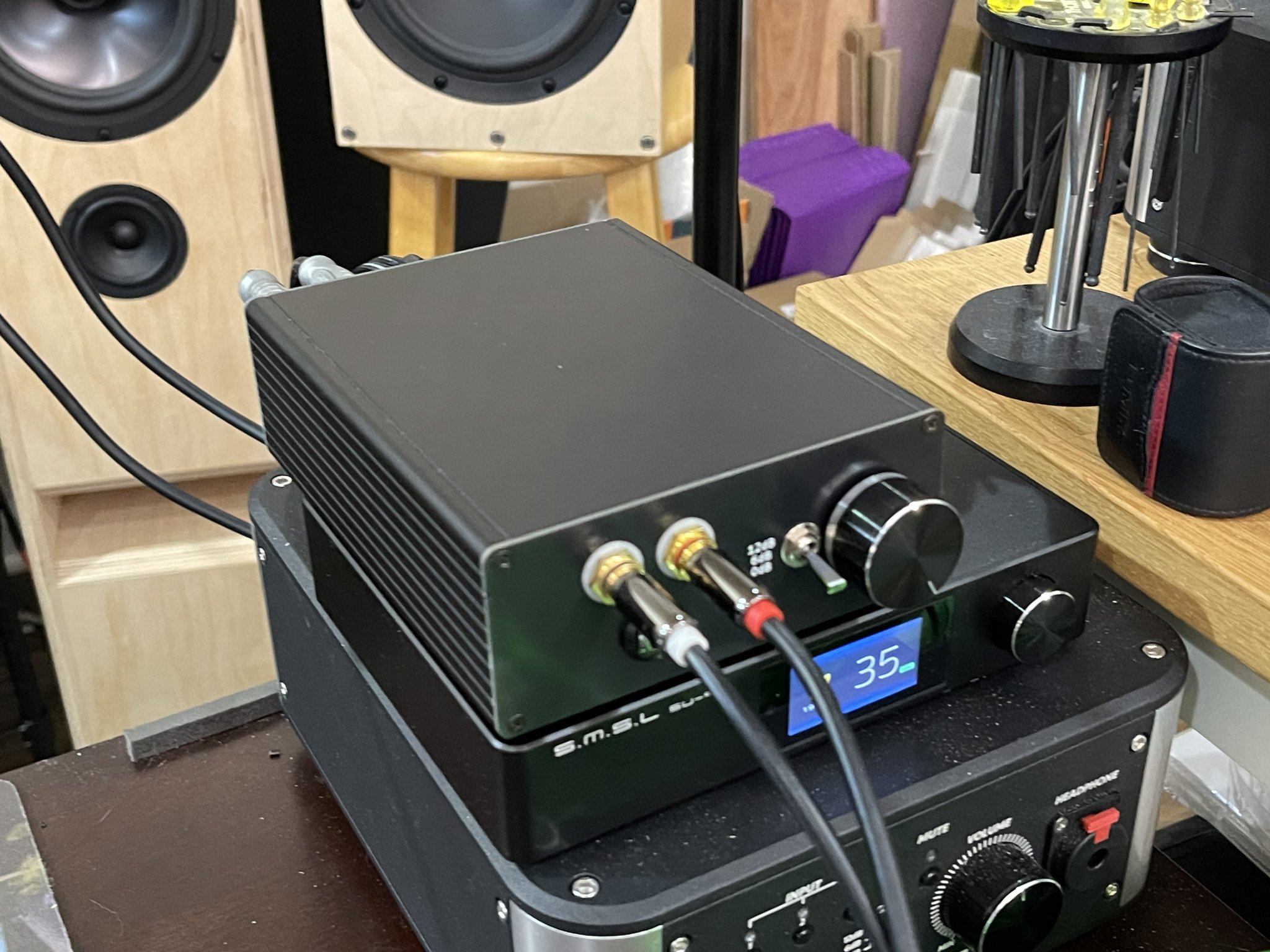

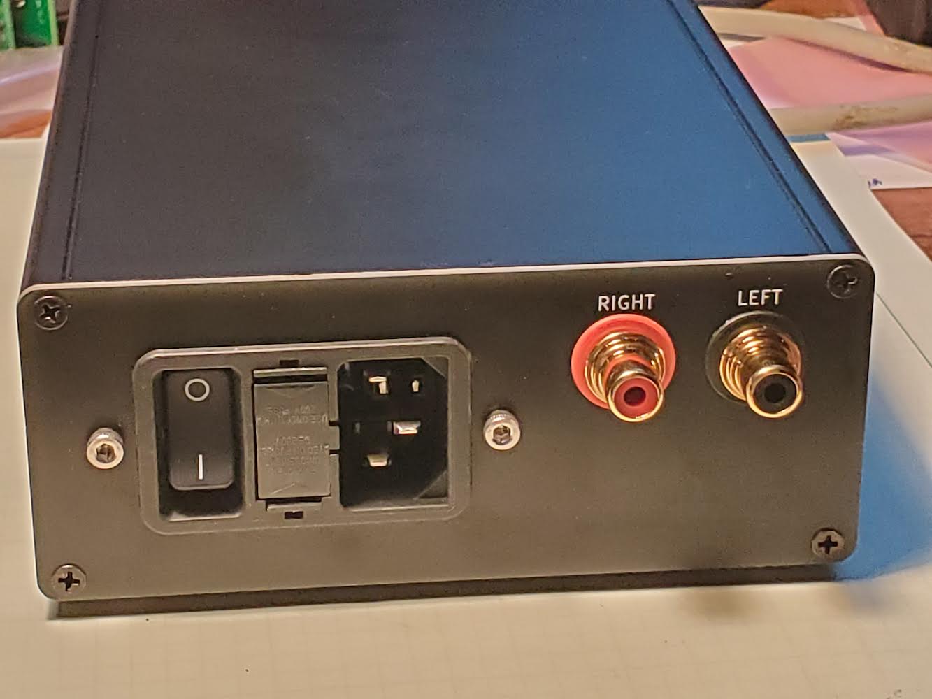

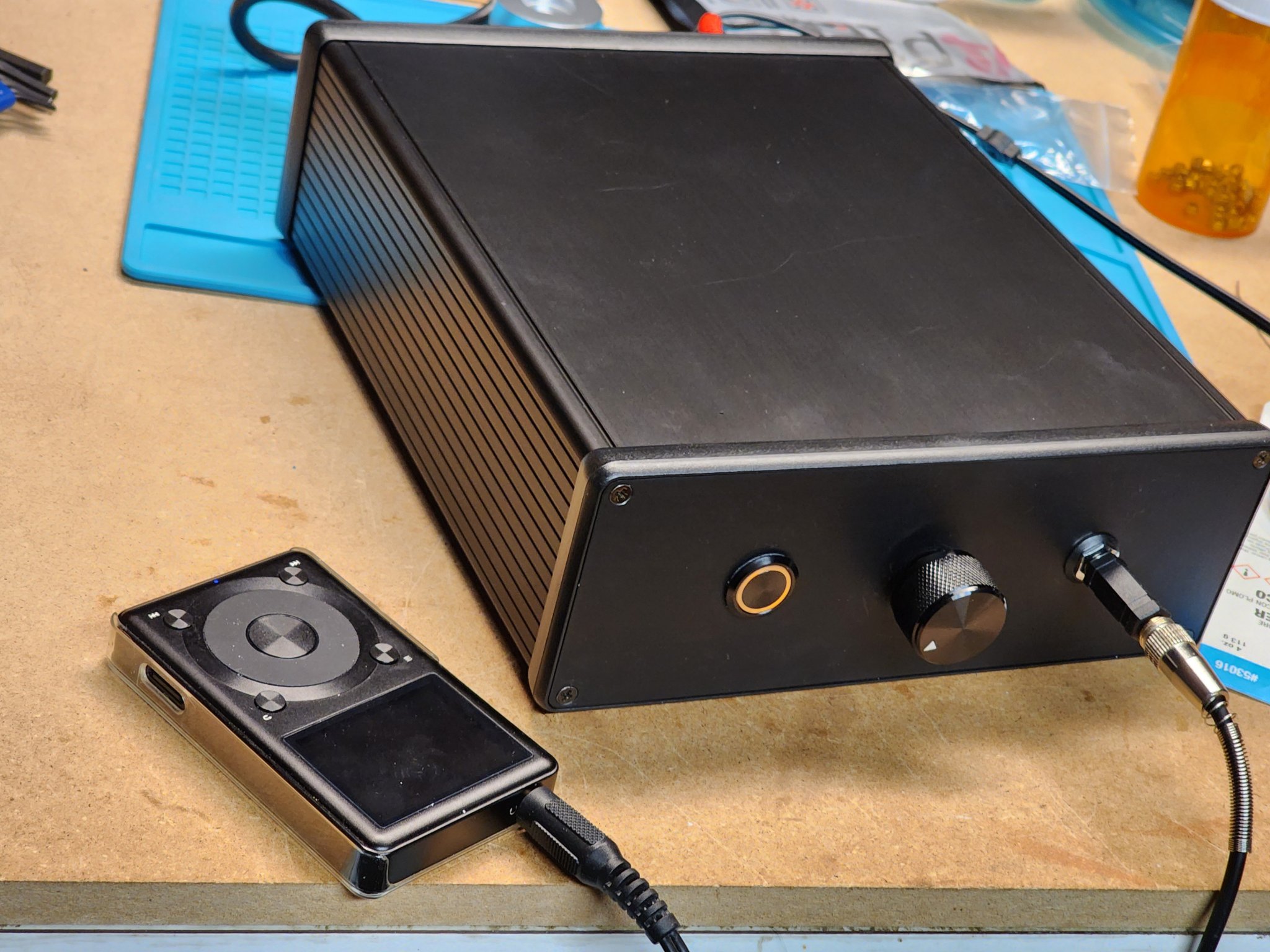

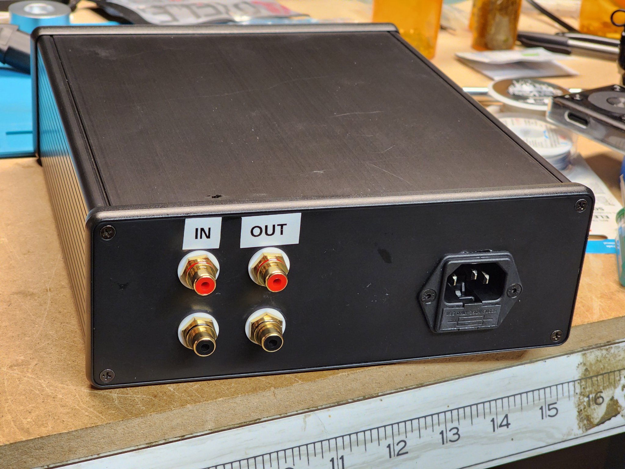

I thought I would briefly share my recent build of XRK Audio's Desktop Diamond Buffer Headphone Amp.
Because I wanted to utilize this amp sooner rather than later, I decided to go with a "ready to run" power supply. The output is 12 vdc.
I chose a Hammond 1455U2201BK enclosure to house my project. The most time time-consuming part of assembly was the wiring, which really wasn't that bad.
I am quite pleased with the outcome. The soundstage is wide and deep, with great clarity. The bass response is great and makes for a rich sounding presentation. If anyone is considering putting one of the together I would encourage them to do it. Many thanks to XRK Audio and jhofland for an excellent sounding headamp.

I just wanted to hop online briefly to comment on this Desktop Diamond Buffer Headphone Amp one more time.
I used the DDB HPA as a preamp to my Honey Badger while my beloved FH9HVX is on the workbench.
X, you were right! Wow, what an amazing little preamp. I absolutely love the bass this thing puts out. Some day I want to build a low to mid-power amp/ preamp combo that would be suitable for an apartment. I think I may have found the preamp part of the equation. Thank you XRK Audio and jhofland!
