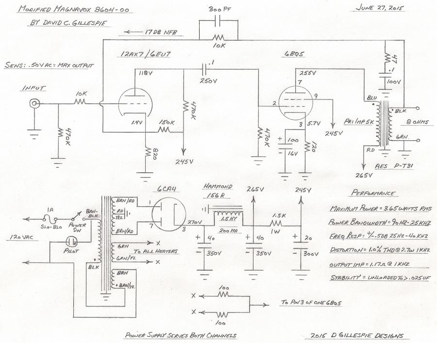

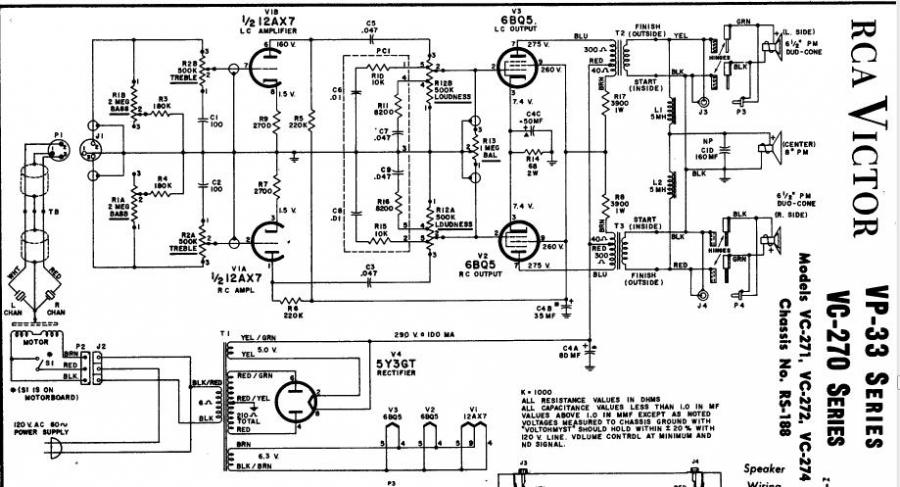

Here is the original circuit. Note how they used a tap on the output transformer +
This is current state of affairs besides the power supply differences and unknown output transformer.

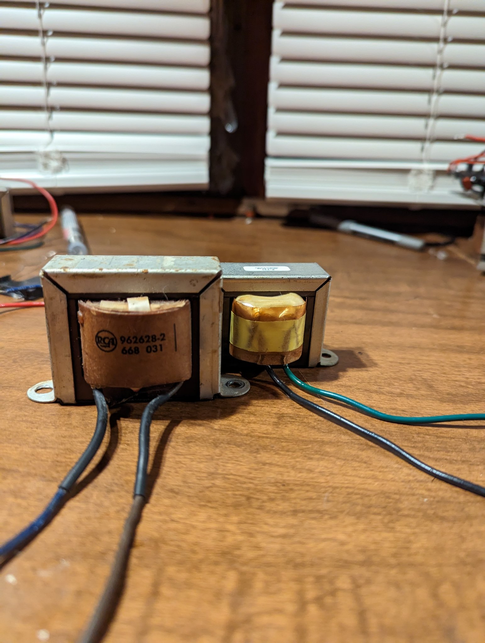

Here's the original trafos compared to the p-t31

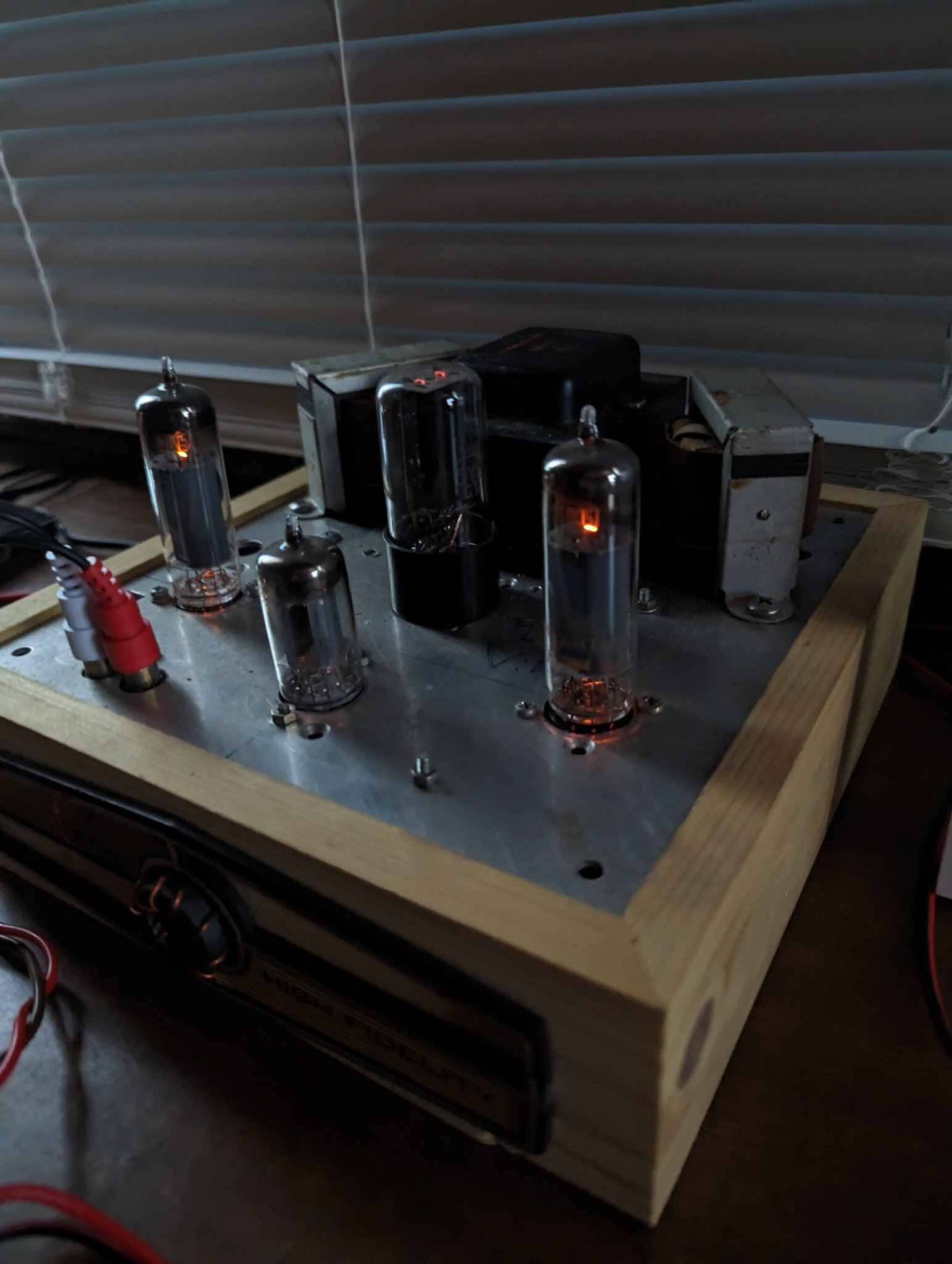

And this is what I built and I'm about to dismantle.
using salvaged parts.

. The ones I used from the original circuit worked with 8 ohm speakers and they are twice the size of the pt31's I ordered.
Question is. How do I check the impedance of it.
Which transformer do you want to check...? Which impedance? Primary, secondary? Not quite following you on your transformer switchout. The originals are better.
The original RCA output transformer doesn't have it's resistance or impedance anywhere. I want to see if they will work or will I get better results with the transformers the circuit is designed around.Which transformer do you want to check...? Which impedance? Primary, secondary? Not quite following you on your transformer switchout. The originals are better.
Primary and secondary
The RCA tranny was made for the 6BQ5 so you can assume the primary side will be 100% good for the DG circuit. The voltages are within any normal design for the 6BQ5 so the primary isn't an issue. The main difference is in the secondary side with the addition of the FB line taken from an 8 ohm tap. If you don't have the rating of the speakers in the RCA, then to calculate it you have to get the turns ratio of the tranny and use an educated guess on the primary Z, which would be about 6K for an SE 6BQ5 circuit. Then with those two numbers you can calculate the approximate secondary tap rating. If it comes out to something other than @8 ohms you would adjust the FB resistor, and use other speakers. If you use 8 ohm speakers, the reflected impedance will be close enough to use the circuit as is. Have fun.
Yes. RCA was so proud of that trick that they took out a US patent. (IIRC, Philips invented and patented it in Europe too.)Note how they used a tap on the output transformer +
It gives a reduction of hum/buzz a few pennies cheaper than just doing good filtering. You are not counting your last penny like a factory has to. Your second plan has great filtering. That or a little less (C-R-C) will do nicely.
V/I of that 6BQ5/EL84 is 5,800 Ohms. You low-load a pentode, so 5k is THE happy load here. This is also the most common for a small SE OT.
