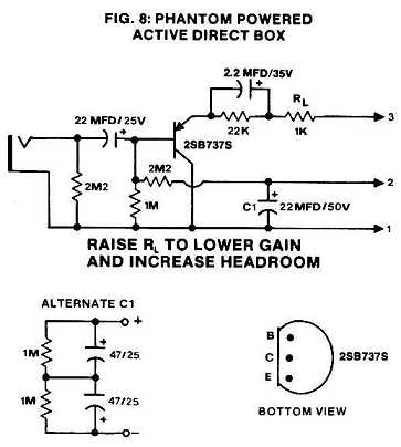

Minion, I don't know the ins and outs of designing circuitry. Have you seen a schematic for one that is good enough to use for a recording studio?
Jman
jman 31 said:
I will look into those. I really would like it to run on phantom power if I use an active DI. I need to check if that is one of their options.
The Behringer I use can be powered by a 9V battery, or by phantom power from the mixer. It's the DI20, twin channel, I've found them invaluble (I even bought a second one as I liked it so much 😀 ). Only £20, not worth messing about building one.
http://www.bluearan.co.uk/index.php?id=BEHDI20&seeimage=YES&img_name=DI20
Everyone should have one in their bag!.
As for the single transistor circuit, it's really pretty naff - it isn't going to be very good quality.
