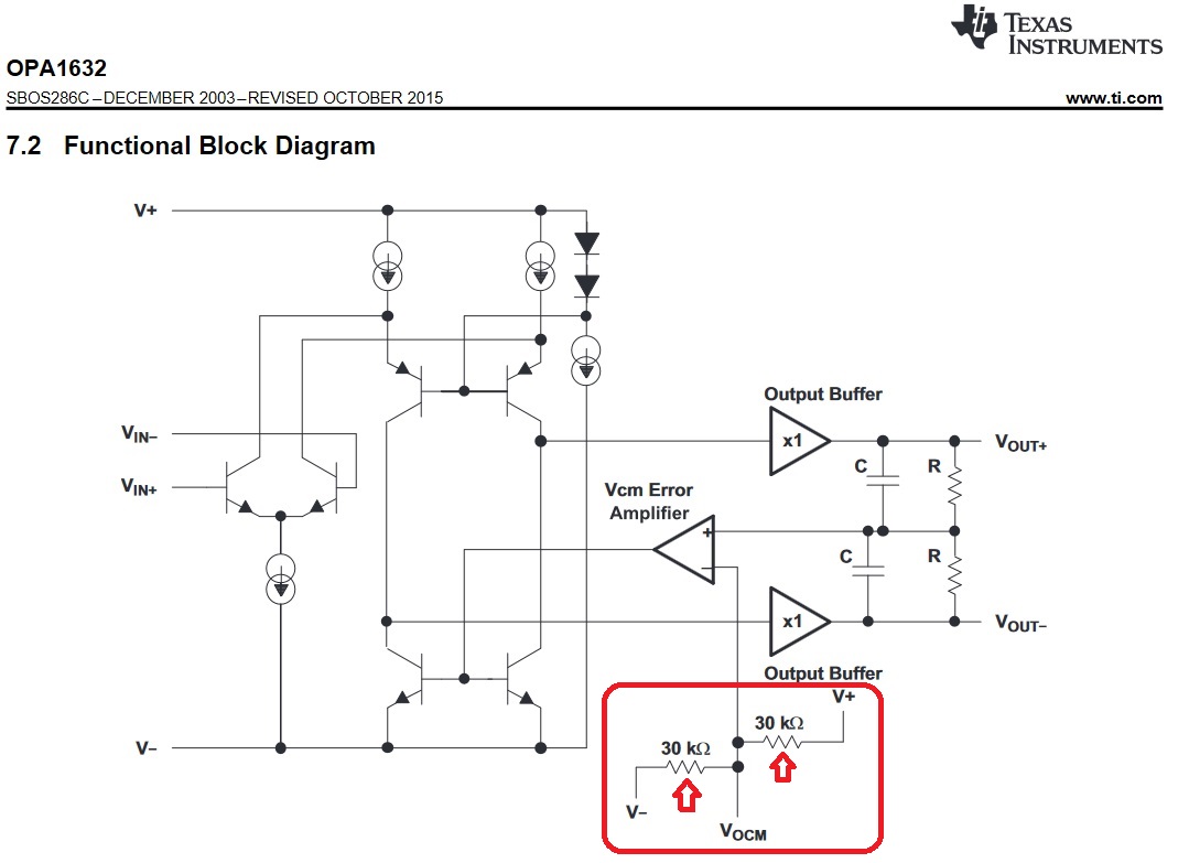

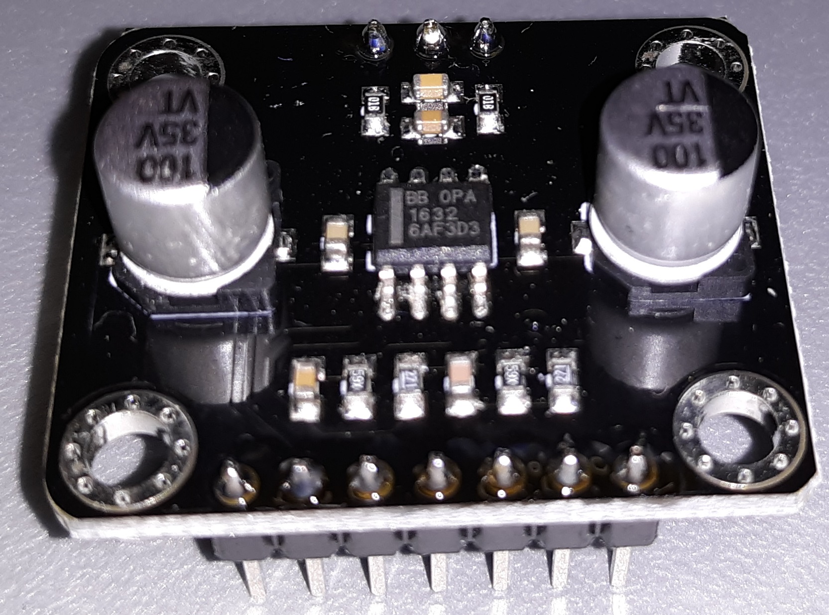

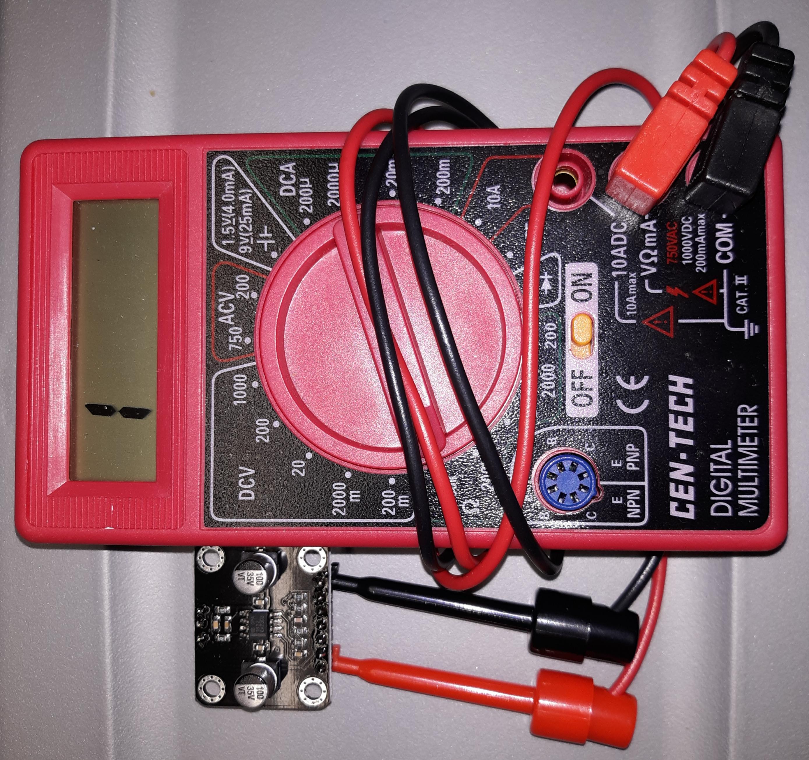

I ask since a simple multi-meter measurement shows that they don't have the 30k Ohm resistors from Vocm (common mode voltage input) and the positive and negative supplies. A real OPA1632 was measured and the 30k resistors measured 30.7k.
If you bought one of these modules (see pictures) what noise and distortion levels did you measure? Do the modules have good noise and distortion performance or should they be disposed of?
A function of the OPA1632 is the fact it contains a CM error amplifier to suppress CM signals .

Well I "tested" these modules with +/-15V supplies and inputs grounded as a first little test.
The so called "OPA1632" gets burning hot. So not only are the 30k resistors missing from the supplies to the Vocm pin the modules are in fact totally useless nonfunctional junk. Of course without the internal 30k resistors there was a 0% chance that these were not fake.

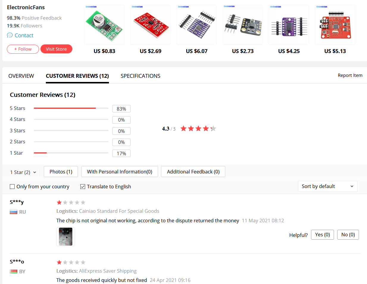

Between the time I ordered them and arrival the following two negative reviews were left by other buyers. (Attached image.) I can only assume that the positive reviews were left by buyers who received the item but never tested it before leaving a review. (Or fake reviews.)

Thanks for the confirmation Kozard ,it would be a help if you could post the website/seller to warn others , that's what my last help website did so the public would not be scammed.
I bought them from seller ElectronicFans on AliExpress. Even with two buyers reporting that they don't work they are still selling them. That is the same thing I have seen with all the fake op-amps, fake power transistors, fake capacitors and the fake low noise regulators. They just keep selling them.
