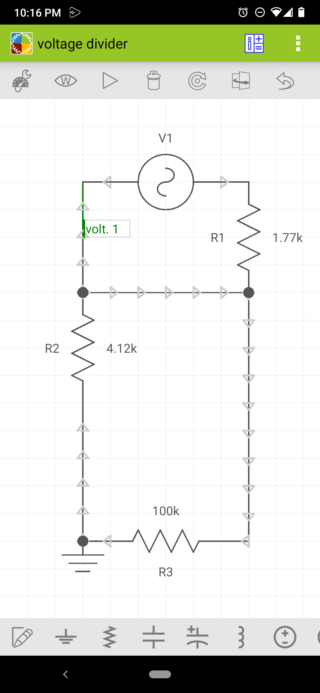

I finally got around to hooking this pot via Mooly's suggestion #2. I used a 10k volume potentiometer.
with a 1.77k inline on the signal input to the amp, and the pot between signal (after the 1.77k R) and ground, I measured 4.12k Ohms.
Do the values of these resisters matter much? Or only the ratio between them? The input impedence of the amp is 100k, should I try and get my resister values higher or lower?

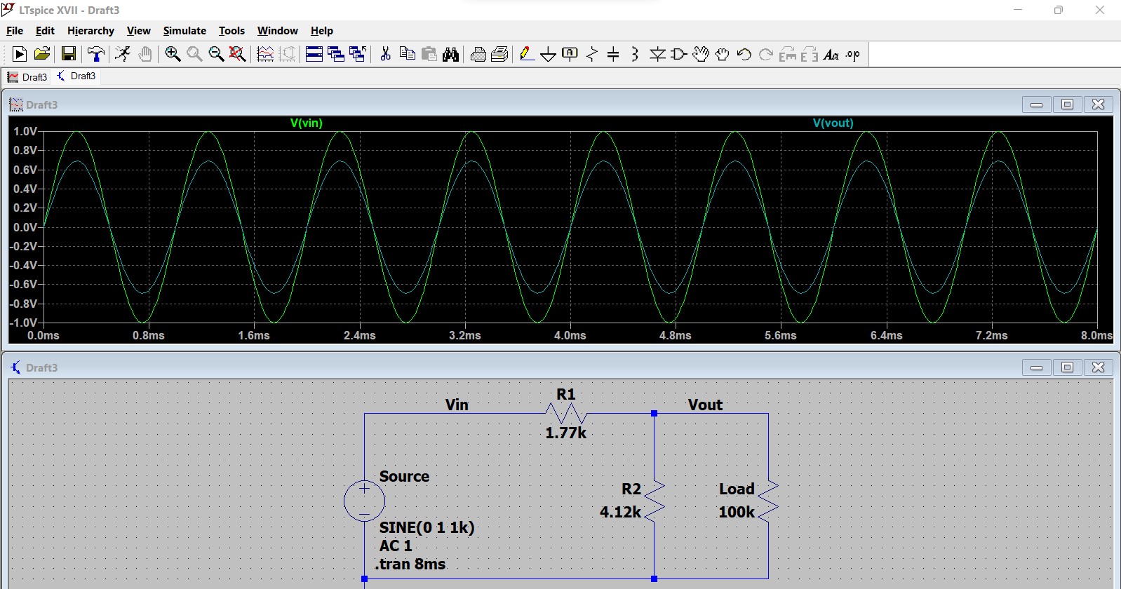

After thinking about this a bit more, I think I may have hooked up my test circuit with a missing connection between on the - side of the RCA cable.
So I think I will retest again tomorrow.
I did think to measure resistance with my multimeter. It reads only ~4kOhm across V1(see schematic), which would be the preamp side of the setup.
Probably I want to adjust my resister values to be higher, so it reads above 10k?
Yes, I think you have drawn the circuit incorrectly 🙂 The attenuation of 1.77 and 4.12k is not very much. The 100k input impedance is high enough not to significantly effect anything.
The values are OK for most solid state gear which should easily drive those values. It is the ratio that sets the attenuation but in practice you should not go to high either as that can cause other problems. 10 to 20k is a usually a good value to aim for.
You can just use the preset alone with no other resistor. Connect the 10k preset across the audio output (the source) using the end legs of the preset and then take the signal from the middle wiper leg of the preset.
7.2/4.5=1.6X attenuation needed
Which means: 4.08dB=4dB (in the Real World)
From: dB calculate - decibel calculation dB calculator voltage power ratio sound pressure level matching dBA SPL sound pressure intensity ratios converter thd percent % audio engineering impedance matching bridging - sengpielaudio Sengpiel Berlin whih I recommend, tons of excellent Audio calcuators there, very useful.
Designing around what you have, attenuate Amp B whih to boot has higher impedance, making things easier.
My choice (there are others possible of course):
* Add 100k in parallel with amp B input, so combination is 50k.
* add 0.6*50k resistor in series, so 30k (in practice 33k is close enough)
Presto!!!!
PD: for the ultimate confirmation and peace of mind, join both amp inputs togeter, feed them 330mV and confirm both output 4.5V
Easy peasy.
No need for OCD , within 10% of each other is enough, worst case slightly adjust the "30k" resistor.

30k:50k divider could be a bit noisy by producing a high impedance node sensitive to pickup (if not screened) and by adding some Johnson noise (probably not an issue at line level). However it is the most compatible with a range of sources.

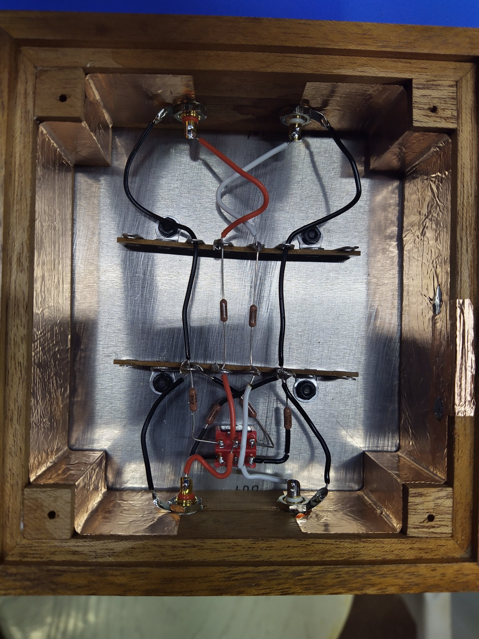

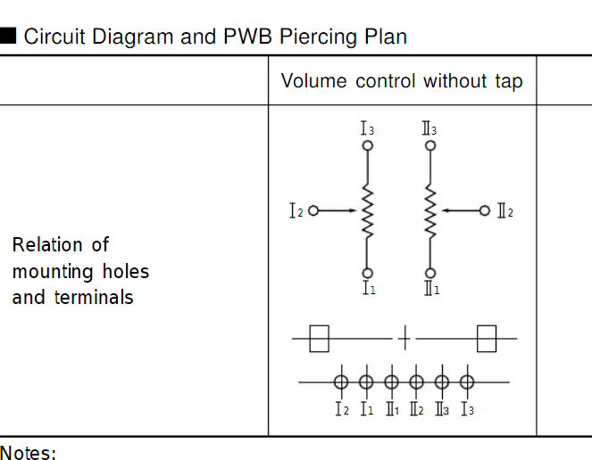

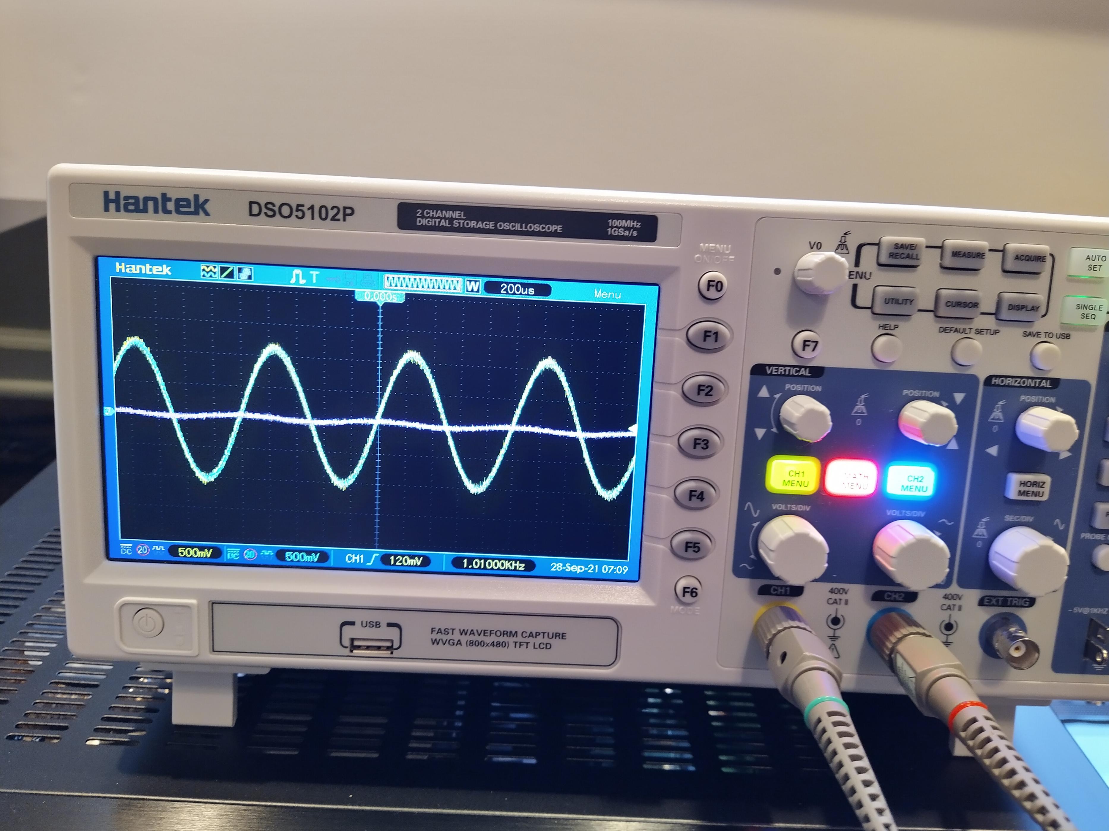

Ok, I hooked everything up again, here are the details. Hopefully, I figured out the correct way. Who would of thought 3 wires would cause me so much trouble.😀 I took the measurements with the preamp at 3 o clock volume. There is also a Scot of the scope with no pot in series, just a wire. And an after adjustment shot.
Amp A = scope channel 1;
Amp B = scope channel 2
In lookin at the pot's schematic (attached).
I measure 8.42k Ohm across the audio output I2 and I3.
I measure 1.75k Ohm across I2 and I1.
I measure 10k Ohm across I1 and I3.
I have the audio source output + fed into I2.
I have the audio source output - fed into I1.
I have the downstream amplifier input signal(+) connected to I3.
I have the downstream amplifier input signal (-) connected to the audio source -.
See attached photo.
left black alligator is "audio source output + fed into I2.".
green alligator is "audio source output - fed into I1."
right black alligator goes to amp B's input jack.
I also made a video to help explain how I set this up. Mostly, I just want to make sure I understand what is going on so I can gain a bit of knowledge too.

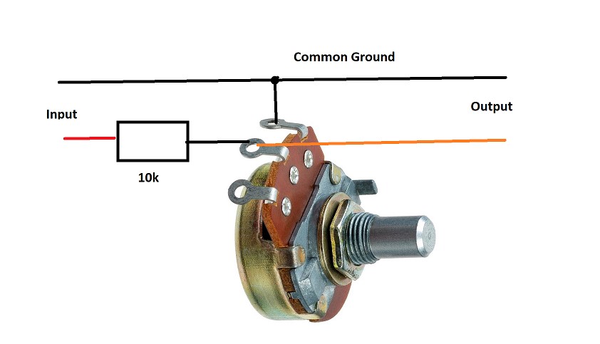

Difficult to follow all that 🙂
Like this, two versions, the first allows control over 0 to 100% of the signal level, the second always has some attenuation present depending on the value of the pot.
For example if the pot and resistor are 10k then in the second example you can only ever get a maximum level of 50% of the input.
Both allow the signal to go to zero. The first is the more common arrangement.

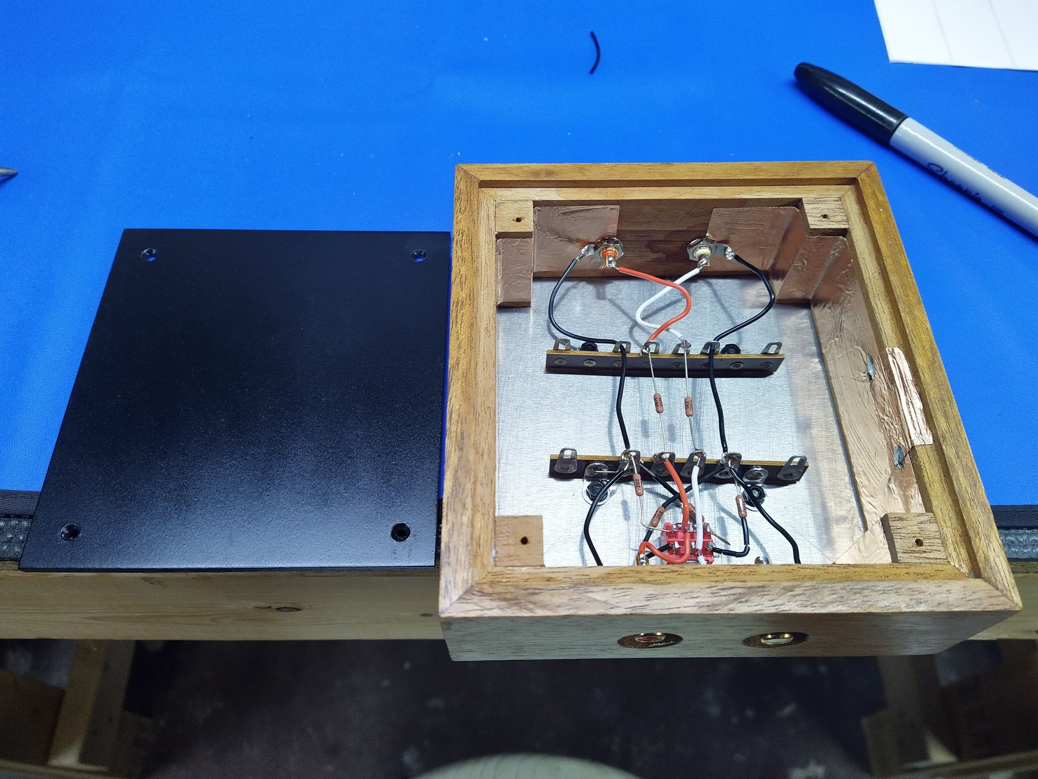

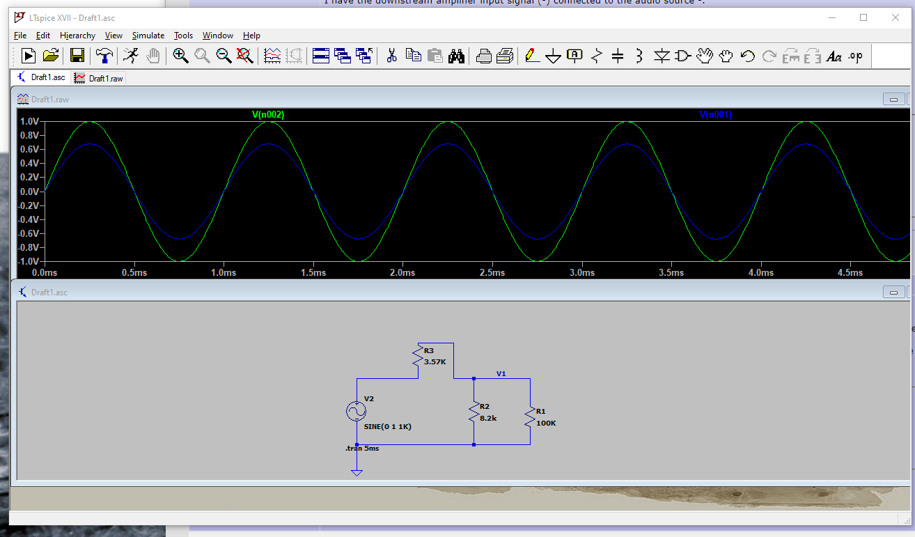

@Mooly, thanks for the drawings, I understand a lot better now.
The pot I was using was really touchy, but I could get the signals at the speakers close. Then I grabbed a bunch of close resistors from the parts bin and hooked them up to my cheater cable in place of the potentiometer.
The signals are the closest with the following resistors in place. 8k2 across the input side of the amplifier and 3k6 inline with the signal.
I tested the circuit via the schematic that is attached. I also spent some time figuring out ltspice. (Although, I haven't figured out how to rotate a component yet 😛)

I plan on sacrificing a cheap rca cable and testing the values with some music and see how the levels sound before I commit to making a more presentable box/build out.
I really do appreciate all the help.
For my own sanity, hooked up via Mooly's 1st drawing, the following readings were taken from the pot, and the levels on the scope equalized.
Input to wiper 3.37kOhm;
Wiper to ground 7.18kOhm;
That's it
