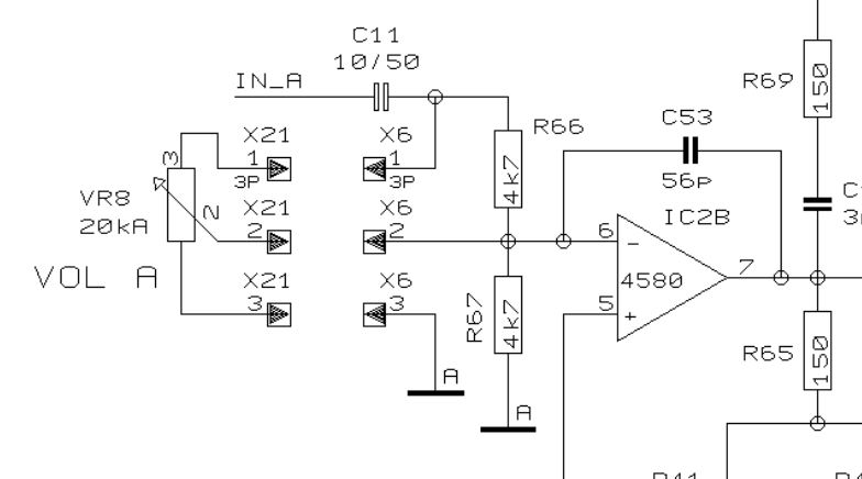

Theseare amps made for studios so they are fanless and also quite sturdy for the money. I am thinking of going A500 but I still wonder why he would say a A800 is so much better.
The A500 has a cheap point creating unwanted distortion. The volume knob or rather the potentiometer, i guess, is the culprit. Unless they are put at max, distortion rises quite measurable. Like 10xtimes if i remembeer cirrectly. They really dont hold up to the spec sheet but A500 are tested at 128w both channels driven at 20-20k hz 8ohm and if i rememeber correctly with the pots at max at a respectable somewhere 0.0130% I think.

Hi ! this sounds strange ... i wonder if anyone has given a look at the schematic and at how these pots are wired.
Maybe a simple mod could solve the problem.
Pots should not impact distortion so much ... they are just variable resistors in the end. Strange. 🙄
... The A500 has a cheap point creating unwanted distortion. The volume knob or rather the potentiometer, i guess, is the culprit. Unless they are put at max, distortion rises quite measurable. Like 10xtimes if i remembeer cirrectly.
They really dont hold up to the spec sheet but A500 are tested at 128w both channels driven at 20-20k hz 8ohm and if i rememeber correctly with the pots at max at a respectable somewhere 0.0130% I think....
Hi regarding the pot induced distortion issue i have found the schematic of the a500 i am attaching ... the way the input volume pots are wired looks weird to me. I am attaching the particular
I would cut R66
Any comments ? is it instead perfectly fine ?

If the pot is the culprit in increasing the distortion, removing R66 would tend to make the problem worse. The only reason distortion would increase depending on the pot setting is if for some reason the 4580 op amp only wants to be driven from a LOW impedance source. Perhaps they realized this in testing and added the resistor to help mitigate the “problem”. In all the “professional” versions the input op amp to the power amp section is driven by another op amp.

Hi thanks a lot for the very kind and valuable advice. Wrong design then ? one thing is sure ... at Behringer they must love this OA ... they put it everywhere (I have seen inside other units using it ... a dac and an Headphone amp and also a mixer)
Maybe we discover that a simple 5532 could be a better option ? or a 2604 ? i have to check if it is smd ... i wonder if swapping for an equivalent could mitigate the distortion issue. Strange mistake indeed ...
You need an op amp with high drive capability there. That’s why 5532s have traditionally been used. It may behave better here. 2604 won’t cut the mustard, don’t even try it. Nowhere near the drive capability. If it were driving a small signal stage, it would be better.
Driving power transistors directly with the op amp is a very difficult load for it. In most normal applications, a higher source resistance has little impact on distortion, only on noise. With circuits like this anything can happen. QSC universally used the 5532 for a reason, even in modern implementations.

Hi thanks a lot for the very kind and valuable advice. I have to check if the opamp is replaceable with a 5532. As i said above at Behringer they must have fallen in love with the 4580 opamp ... they used it very often. Even where, i now understand, better alternatives exist.
