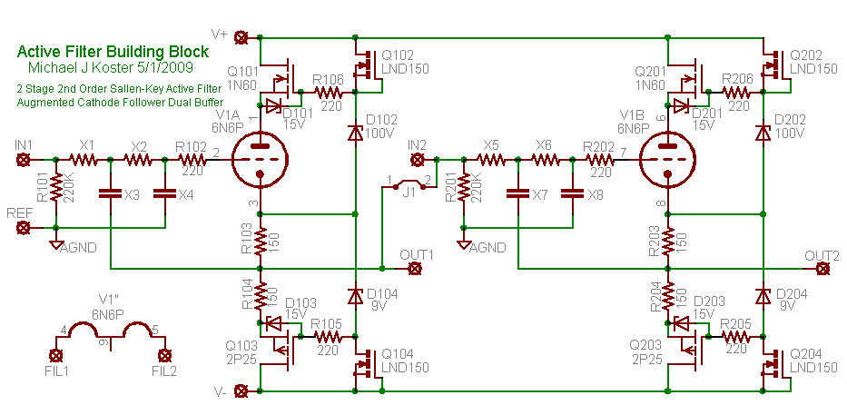

Hi Alex,
That all sounds familiar.
I worked on a differential active filter about a year ago and ultimately
decided that the component matching problem would be too much
trouble. I asked myself why it needed to be differential or balanced
and couldn't justify it. I'll use transformer coupling for input and output
anyway which will work fine with my balanced XLR studio interconnects.
I decided to work on SE circuits to reduce the noise and linearize the
transfer function and came up with a SE augmented cathode follower.
The PSRR is improved by the MOSFET bootstraps and CCS bias. For
my purposes at least, this gets me to my goal of a great active line
level crossover sooner with less risk.
I have another version with cascoded MOSFETS everywhere but in
the end decided to simplify it to this for the first try.
Michael

Michael,
Thanks for your response. The primary reason for going for a differential crossover was because I already use, and am very happy with, the Vacuum State RTP3 preamp I built two or three years ago, and my next project will be a 300B amp with a differential input.
Your buffer circuit looks rather like mine, although you have clearly put effort into optimising the current sink and bootstrap elements. Transformer coupling is an elegant solution. The one thing that has kept me away from using transformers in my system, apart from the cost and real estate, is the thought of all that copper. I have had one short experience with an OTL amplifier, next to a similar amp with an output transformer from the same designer, and heard a huge gain in transparency. All the same, I understand that there are plenty of people out there who would rather use a whole pile of transformers than a single capacitor.
My crossover, while on my workbench, is being fed from a single-ended signal generator, and I suspect that the differential input stage isn't quite perfoming as it should: the plot I posted has all the traces normalised by the passband amplitude, and in reality my circuit has a few dB of imbalance which I need to sort out. I still don't see why two single-ended filter stages which are working correctly should have such a response anomaly when they are used differentially.
Now I am running the filters single-ended, their responses seem to be matched to within a fraction of a dB (and also very close to the target LR4 curves), which is very pleasing. I matched components to within 1%, which seems to be enough in this case.
Alex
