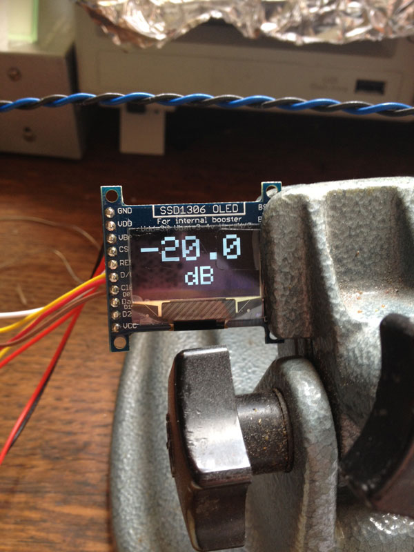

I'm building a couple attenuators, one for unbalanced lines and another for balanced lines.
I have my unbalanced design worked out using a PGA2310, but haven't seen much discussion of designs/chips for balanced (differential) lines. Except this brief thread.
Does anybody have any experience or recommendations for chips and designs for balanced lines?
If there isn't a balanced equivalent of the PGA2310, I'd consider making a "balanced bridged T" with 10-bit 1%-tolerance digital potentiometers (something like these) in the requisite locations.
Thoughts?
Thanks!
John

These attenuators I'm building are for precision attenuation of theatrical cinema audio mixes in a calibrated (-20dBFS=85dBspl per SMPTE RP200) listening environment, for the purpose of loudness matching.
They need to be outboard gear, hence I'm working in the analog domain.
