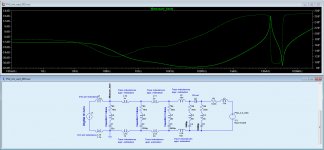

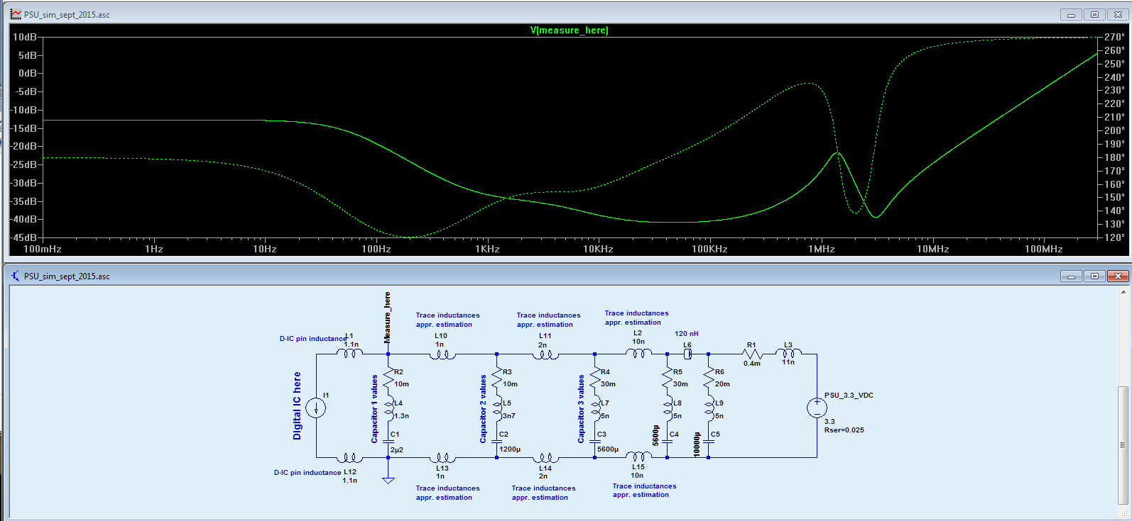

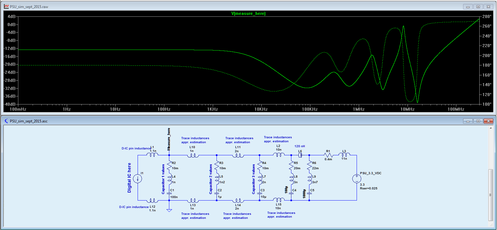

Hi All,
I have for some time now been reading about digital decoupling and it seems that there are at least three different philosophies about how to optimally decouple digital circuitry. Generally speaking these appear to be:
1. To use one or more capacitors of the same (low) value to provide a low impedance dip where the main decoupling frequency is desired. Could e.g. be one or more 100 nF capacitors to decouple around 12.3 MHz (192 kHz - 32 bits - 2 channels).
2. To use one large(r) capacitor, e.g. somewhere between 1uF to 10 uF, which - in a practical circuitry with PCB (& other) inductances and impedances - gives a lower resonance frequency and fewer impedance dips and peaks. Yet also typically a higher impedance, i.e. less effective filtering, at the desired filtering frequency (for example at 12.3 MHz for a 192 kHz clock).
3. To use a selection of capacitors spaced e.g. 10x values apart, e.g. 100 nF parallelled with 1 uF & 10 uF & 100 uF etc.

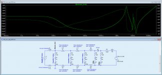

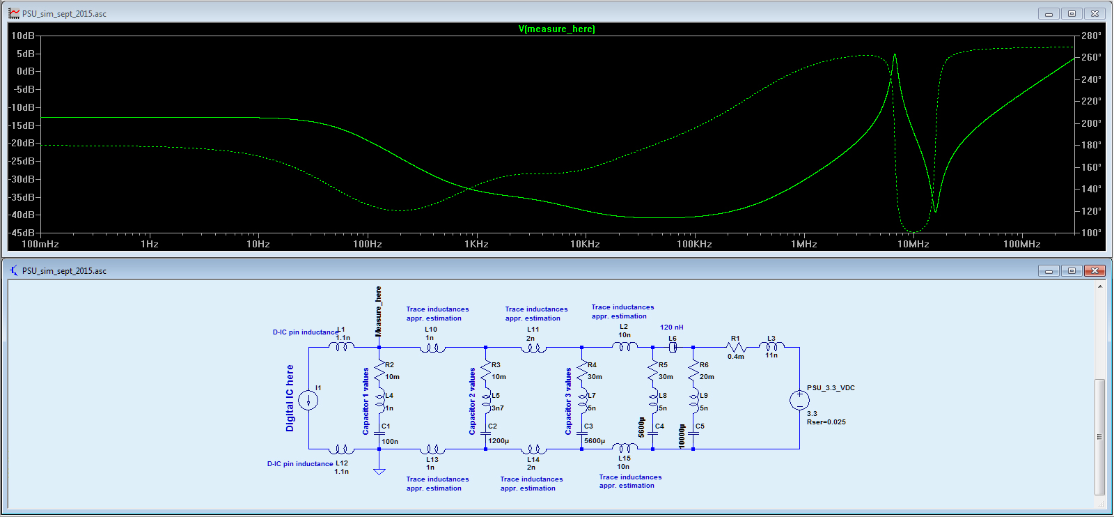

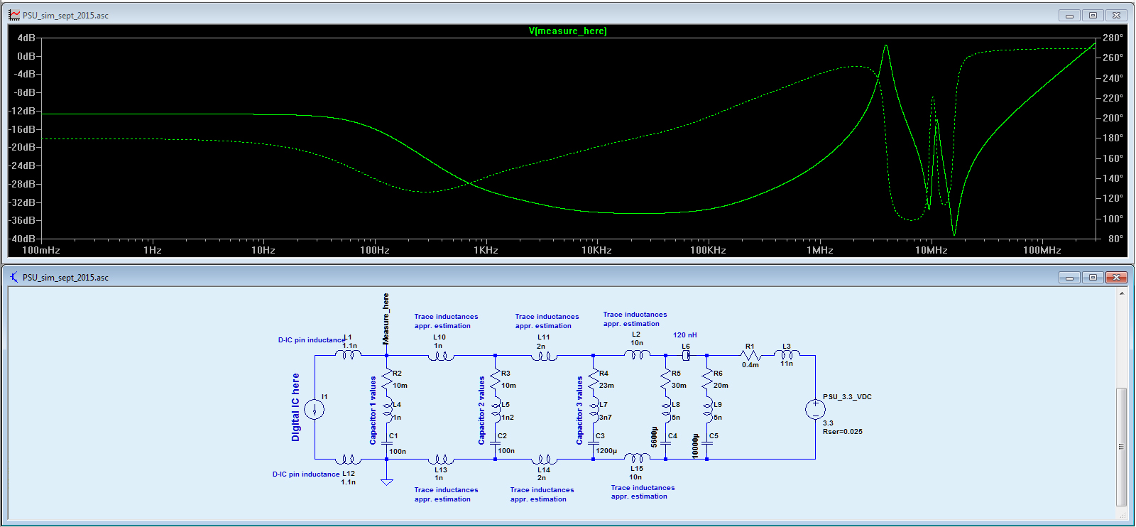

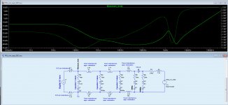

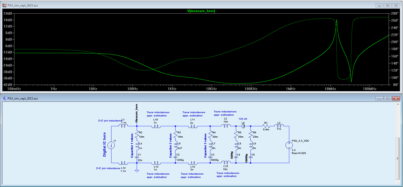

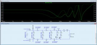

I've included five LTspice simulations of these various capacitances placed in what may (hopefully) be realistic component & circuitry values. The reason why there are five simulations, and not three, is that I've also included:
- a simulation of a single 22nF capacitor placed in the same circuitry - this capacitor value actually seems to amplify the PSU noise with a peak of appr. 18 dBs at 14 MHz ...
- a simulation of two 100 nF capacitors placed in parallel. Something that does not seem to alter the lowest impedance much.
The "digital IC" that is decoupled is the current source I1. The digital IC's package is akin to a QFN or 28 lead SSOP package, hence a lead inductance around ~1 nH to 2.2 nH. I hope this makes for simulations that can be used for this purpose ...
Please note that there are many more capacitors in the simulations than just the ones related to the three options above. I've been trying out various values and decided to let the larger values be in the circuitries since they do not really affect the simulations with respect to resonance peaks & dips.
So what I've been wondering about is:
- Which of these decoupling methods are most effective in technical terms, i.e. they provide the best practical/real world attenuation of digital PSU noise? Is there a generally acknowledged best practice in this field?
- Is there any knowledge about how a particular digital decoupling - and a factual noise spectrum related to this decoupling - correlates with listening impressions?
- Is there a direct and reliable way of measuring - i.e. in a particular circuit - how effective a given decoupling really is? That is: How is it possible to make a reliable measurement in a way that does not interfere with the circuitry - using equipment that is accessible to a DIY'er?

Major manufacturers including Philips and Sony use a 100nF capacitor on the chip feed leads, next to the chip. Why make life complicated with a series of capacitors and imaginary inductors when there is no need.
Run separate grounds for digital and analogue then decouple as you go at each digital IC.

Same value decoupling capacitors work best for me... the main decoupling frequency as you call it is in fact what needs to be tackled most in a given application. Good to see people experimenting and trying different things...

Minimizing stray inductance to the ground plane is the key to decoupling.
Even vias can cause problems. A 10nF can be better than a 100nF in some cases.

Use the smallest package capacitor for the chosen value, 0402 0.1uf is a good choice, preferably with via in pad. Though 0603's would probably do. Placement of vias and number of vias per pin helps, as well as a trace that is wide. The placement of vias in relationship to the cap and ICs pins can also have an effect.
A contiguous ground plane is a must, and preferably a ground/power plane pair would give the best results closely coupled (0.1mm dialectric).
A circuit and more information would be a good idea.
Using through hole capacitors is a total waste of time as any stray inductance is BAD.
Use X7Rs for decoupling....
