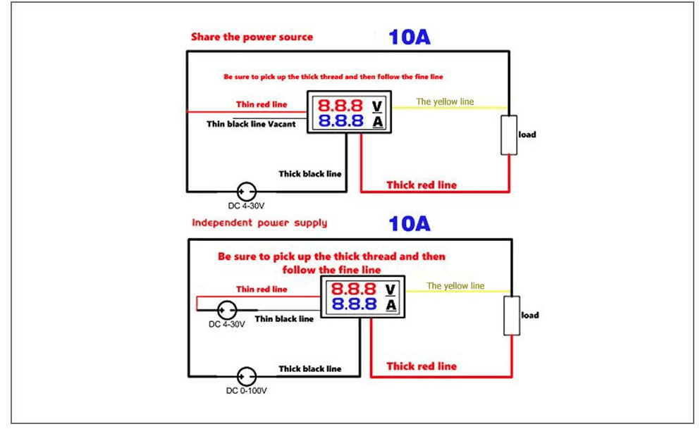

Jan, i saw that you and mark did some lab experiments couple of years ago with this little Chinese panel meter. I am dealing with those now. Do you have any results to share ? this is what i came with after some test, but i am not sure if this is right.
The 12V are separate with a DC/DC power for each.
Measurement input GND typically is galvanically connected with power GND in all meters.
But there are similar meters with isolated power supply, you may find them by this key word ("isolated"). They have isolated DC/DC onboard, so they cost a bit more.

thanks Nares,
i found this one DC Meter 100V -200~+200A Bidirectional Current Shunt Can be Put On Positive Side
I will try and report...
