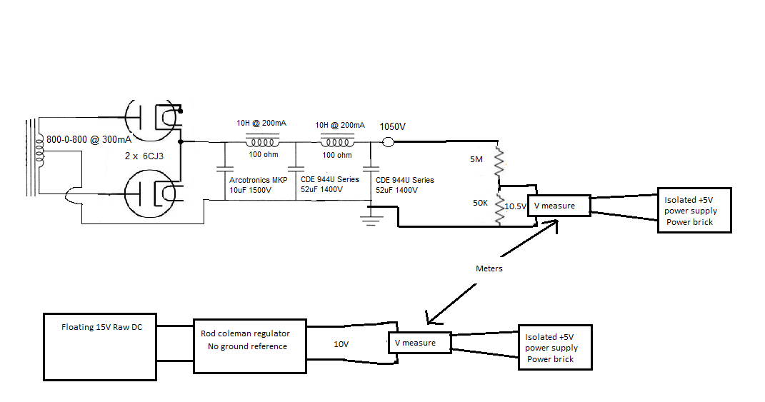

The other thing I want to measure is a stepped down output of a high voltage B+ supply in an amp.. So I was going to use a 5M (multiple resistors) / 50.5K voltage divider on a 1KV supply, so a 1KV supply I would measure 10V over the 50.5K resistance.

I'm not sure I understand how to apply that to my circuits.
It isolates input from output it looks like (attached an image from datasheet).
I've also attached a schematic showing the two things I'm hoping to do.
I could actually probably use one of the 2 wire meters for the coleman regulator measurement, because they could easily handle the extra 30-50mA current draw.
I couldn't do that for the voltage divider measurement though, as an extra 30-50mA draw through that would definitely not work, it would be like 50W of power dissipation through the 5M resistors.

You answered your own question. That is what I was saying.
On your above schematic: if you use two meters, sure that will work. If you want to switch between metering the two units with a single meter, then you need to switch all three meter wires.
If you do that you don't need the isolated power brick.
But I am wondering what that 5V is ultimately connected to; it will somehow have to be connected to the other circuit somewhere. Where is that?

Oh maybe I wasn't clear enough in my original post. I want to use separate meters to measure the two different things. But I don't want either of the things I'm measuring to be ground referenced to something else.
So for the coleman supply that is completely floating, if I use a power brick that is just powered by AC directly, and connect the + and - to the 3 wire meter, and then that shared - is connected to the negative terminal of the floating supply I'm measuring, and the + is measured to the positive terminal of the floating supply, I wouldn't be somehow ground referencing the coleman supply?
The meters are going to be in a box external to the amp chassis (which contains the things I'm measuring). The external box will be connected via some sort of umbilical cable to the amp chassis. The circuits I'm measuring will be fed through that umbilical back to the box that has the meters. The meters in the external box will be connected to their own power source via power bricks. Maybe this is a dumb way to do this, but I just want to have a box sitting beside the amp that I can quickly reference to make sure these voltages are where they should be.
Currently I have test points on the amp that I can connect a multimeter to, to measure.. But I want a permanently affixed box that has constant readouts of these things.
