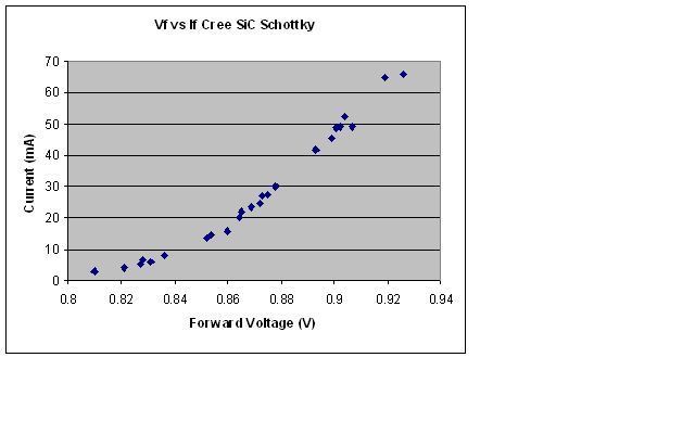

I use them all the time. I prefer the 1A, 600V Cree SiC Schottky diodes, which have Vf ~.85-0.9V in typical tube applications. I used 4 of them in series to bias the 6E5P input tube in my 833C amps to 26mA with 190V on the plate. I also used them in a preamp to bias a 2C22 to 15mA. They have a very low dynamic resistance, especially as you get up above 20mA or so.
Below is a plot that I made from bench measurements of their forward voltage vs current at low current levels. Higher current plots are available on the Cree data sheets.
IMO they sound great! Solid, deep bass response and nice clarity, and of course no bypass cap needed. No LED glow, either.

Disco, The dynamic impedance can be ascertained from a graph like I posted above or from measurements like yours, it's simply (delta V/delta I). For the Cree diodes I show, between 30mA and 40mA, it would be:
(.892-.878)/(.040-.030) = 1.4 ohm, which is very low. It will be a little higher at lower currents.
For the range of 3-10mA, the dynamic impedance for the Crees would be
(.84-.81)/(.010-.003) = 4.3 ohm
Lower is better. So to get your 1.7V using the Crees you could use two in series for a total dynamic impedance of 8.6 ohm, which is 40% lower than your SMD LEDs.
