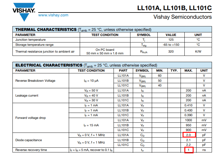

If you prefer SMD Schottky diodes, I suggest you include the LL101A among the candidates you test. Or if you prefer silicon thru-hole diodes, the 1N916 and the 1N4448 and the 1N4149 all have half the capacitance of the junkbox favorite 1N4148. Bob Cordell uses the 1N4149 throughout his power amp textbook.

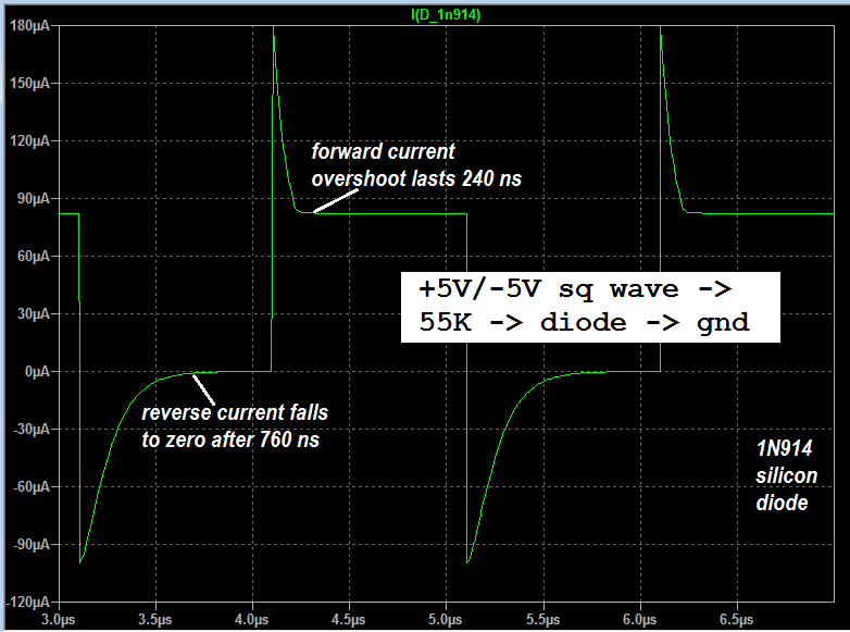

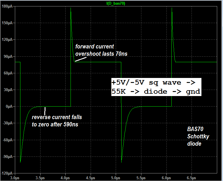

There may be no good reasons to trust LTSPICE "models" of diodes, nor to trust LTSPICE simulations of diode models, but here they are anyway, for your amusement. "Worst case" scenario uses 55Kohm series resistor.
_
I would not expect LT Spice to correctly model the dynamic capacitance of a small-signal Schottky diode - best to check it on the bench...
