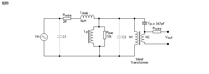

The good news is that an optimized C-RC snubber eliminates all transformer secondary ringing, even when using these brutal and twitchy diode-packs that create big reverse recovery snapback pulses.
Thanks ! i wonder what issues can cause these snapback pulses Will they happen only at the switch on ?
The “reverse recovery snap back pulses” happen every single time a diode turns OFF. That is, 120 times a second. They cause the transformer inductance to ring like a bell on each pulse - and are therefore far more audible than any hum caused by normal supply ripple. Sometimes the circuit just gets lucky and the loading conditions and supply filtering take care of it. Just as often it doesn’t.

Simple, no-math transformer snubber using Quasimodo test-jig
helpful analogy:
... oscillatory ringing of the L-C resonant circuit comprising the transformer secondary's leakage inductance, and rectifier + transformer capacitance. The resonant circuit is the "bell" and the diode reverse recovery is the "hammer" which strikes the bell & stimulates oscillatory ringing. To eliminate ringing ... add a C+RC snubber circuit across the transformer secondary, whose resistance has been tuned using the Quasimodo test jig and an oscilloscope.​

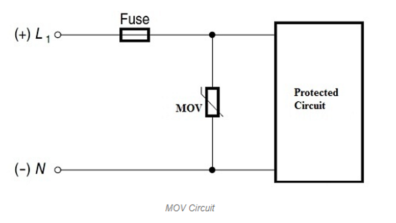

Hi and thanks again It seems that a MOV is mandatory I will check if there is one
I found a schematic
i see that is important that the fuse is on the L wire So i have to check also for phase ?

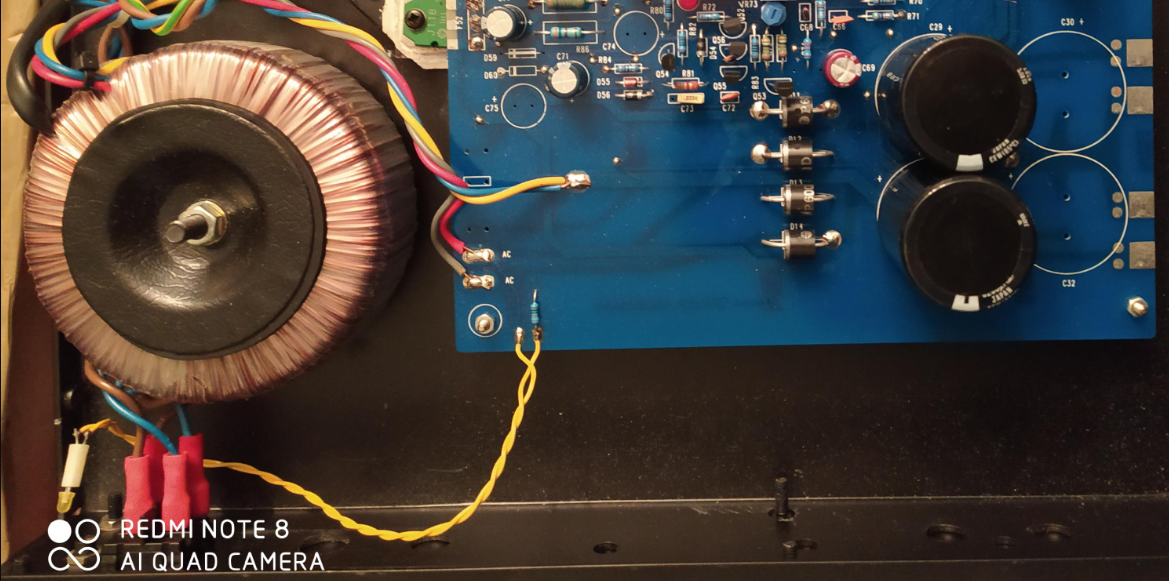

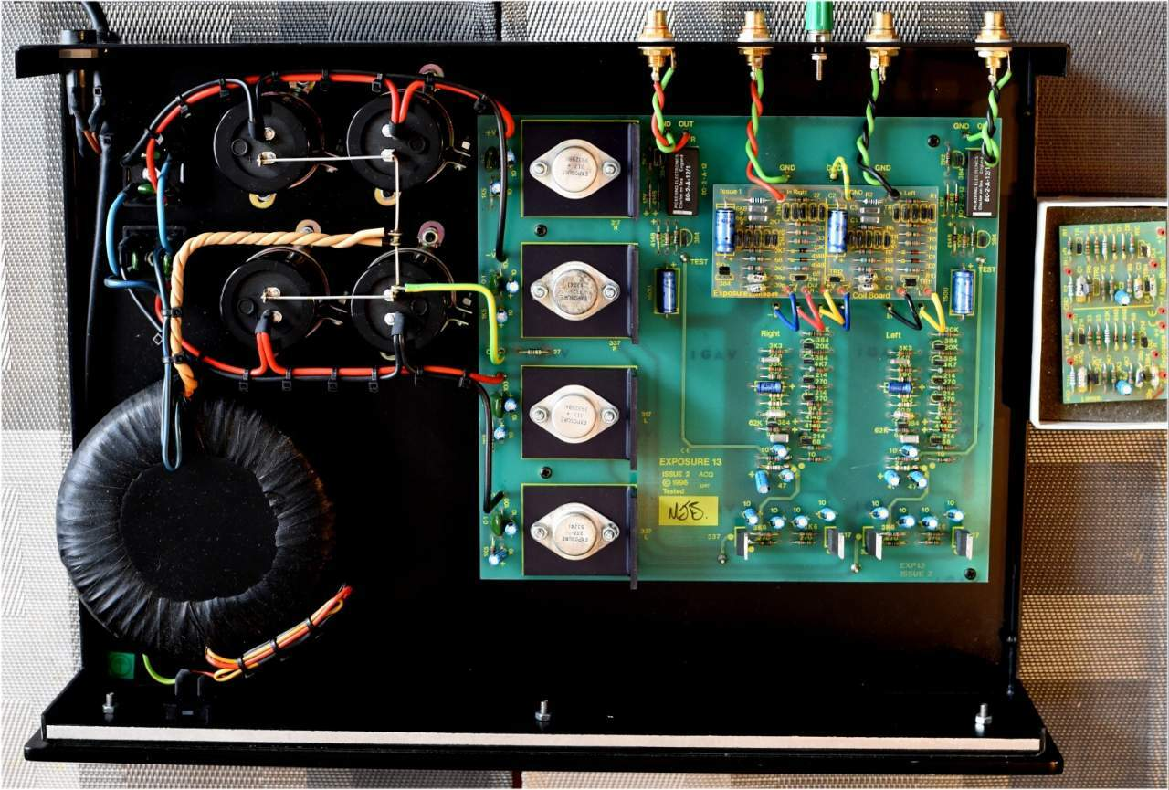

My original question was triggered bt seeing some quite big amps using tiny diodes for rectification This cannot be good
Expecially in high current power supply i like an industrial approach Big parts even if oversized
a 30A bridge cost almost nothing No reason to save money on it

I found a schematic
I’ve got an experiment you can try. Fuse the neutral instead. Then plug it in, remove the fuse. Put one hand on your grounded work bench, and touch any part of “Protected Circuit” with the other. After that little experience, you’ll know exactly why you’re supposed to fuse the L wire.
It’s like when some dumb electrician puts the light switch on the white wire and you go to change out the light for a ceiling fan. You might never come in contact with live electricity, but when the black wire hits the box, you end up on the floor with the ladder and a ceiling fan on top of you.

O.P. lives in Italy the flag says. Italy is in the Siemens electric area, and has no neutral. Both sides of the 220-240 VAC are hot.
MOV are not mandatory but do reduce pops from lightning and A/C shutoff in transformer driven amps even if the transformer is not ringing from diode shutoff. Disc caps used in after transformer snubber are subject to 1300 v*(transformer stepdown ratio) spikes unless a MOV or X or Y cap is across the inputs to the transfomer. With MOV or X or Y cap protection, the secondary snubber capacitor can be ~400 v rated or less.

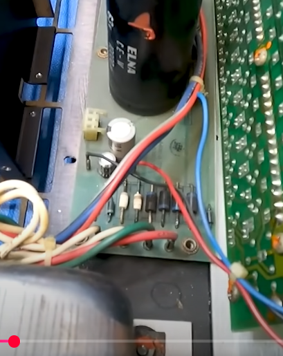

In the end i will only replace diodes with bigger ones Some stock diodes looks flimsy
as an example these can be found on a mighty SAE 2200 power amp I do not understand why they saved on this important parts
Mains transformer and ps caps are impressive
i love big diodes at least 10A parts Better if integrated
The current at idle will be always low No waste of energy My system should be sustainable
