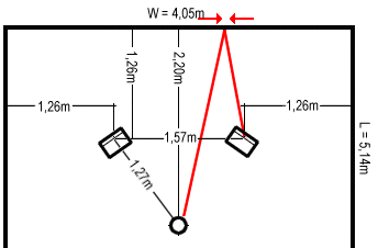

While the midbass peak can be equalized, you are stuck with the early (4-5 ms) reflection throughout the complete frequency range. This will result in imaging problems in the 0,5-5 kHz region. What are you intending to do about that?
Now that's an interesting topic.
As you say and according to the theory (Toole's book) there should be definitely some imaging shifts due to the front wall reflections. However, I subjectively find the imaging of the speakers very good to my taste:
- the center image is VERY well defined. This actually make sense, because the front wall reflections should cause an image shift TOWARDS the center.
- the sound stage is broad, stable and well defined in the whole range between the 2 speakers. This could be related to the particular polar response of my mid-high panels, which are a 2D array of 3.3" fullranges crossed over to a Neo 3 PDR. This makes them rather directional even above the dipole peak (>~500 Hz).
- the only impairment I could observe so far was the "depth" dimension: if I want depth, I need to roll-off everything > 5Hz at the back side. Which I do, being helped by the nature of the small fullrange drivers which roll off quickly on the back.
So I guess that the imaging could be "wrong" in terms of absolute source positions compared to, say, the same material on 2 normal speakers in anechoic conditions. But OTOH, imaging is something rather subjective and the absolute positions of sound sources are not really that important.

If, and how early reflections interfere with imaging will highly depend on the local situation - listening geometry, front wall condition etc. What I experience (without proper attenuation) is this:However, I subjectively find the imaging of the speakers very good to my taste:
Phantom sources near left and right from the reflection point tend to be drawn to that point. The amount of draw can change with frequency.
Best strategy would be to keep everything far from the walls, as lolo suggests. Does he live in one of those beautiful spacious Loire chateaux? 😉

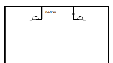

How about a setup like this: L-wings from speakers to the wall on the inner side ? This would make sure no reflection occurs on the inner part of the front wall, at the expense of an asymmetric dipole response.
Anyone tried this ?
Anyone tried this ?
