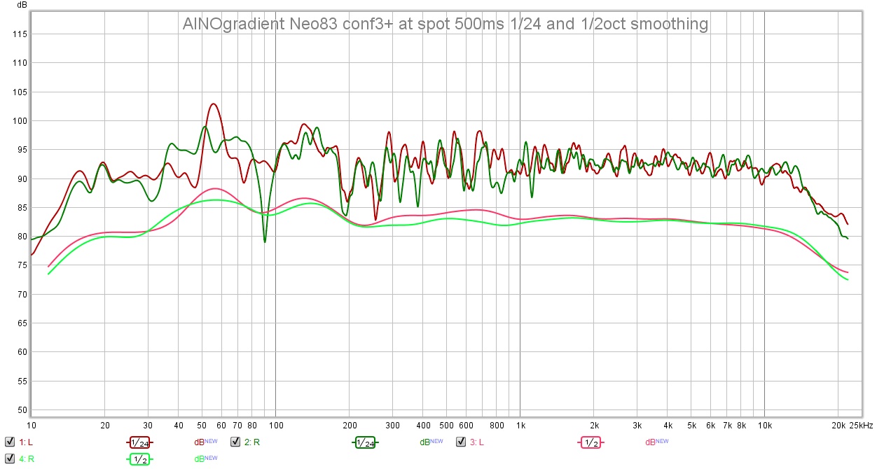

Can't say about Visaton, but here are my measurements with Fountek Neo3.5 with and without backside tweeter. Later on I got the B&G Neoe 3PDR. I have bad hearing of high freq, but I can hear these differences. Flat spot response is ok for me and my speakers sitting in front of windows!
https://www.diyaudio.com/forums/mul...aborative-speaker-project-42.html#post3761585
And a few posts later comparison of response with and without. Room responses on later posts. Yes I liked the backside tweeter effect on sound!

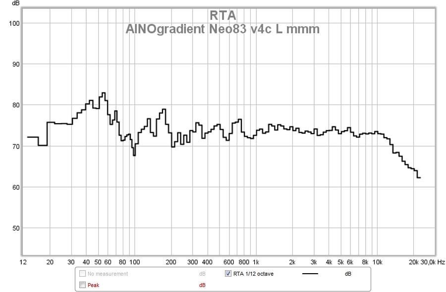

A small come has very ragged on-axis response and dispersion on the backside, because of it's spider and motor structure. But obviously it's total radiated energy i roughly same front/back. Uneven dispeersion will most likely make it sound a little different from a dome tweeter mounted on backside.
The advantage of dual units is that you can play with polarity, filter and spl. Passive needs components and active needs one more dsp channel.
Planar open back tweeters have best symmetry in dispersion front/back! But to manipulate backside radiation one must use tricks like superlon sheets. I chose to not manipulate.

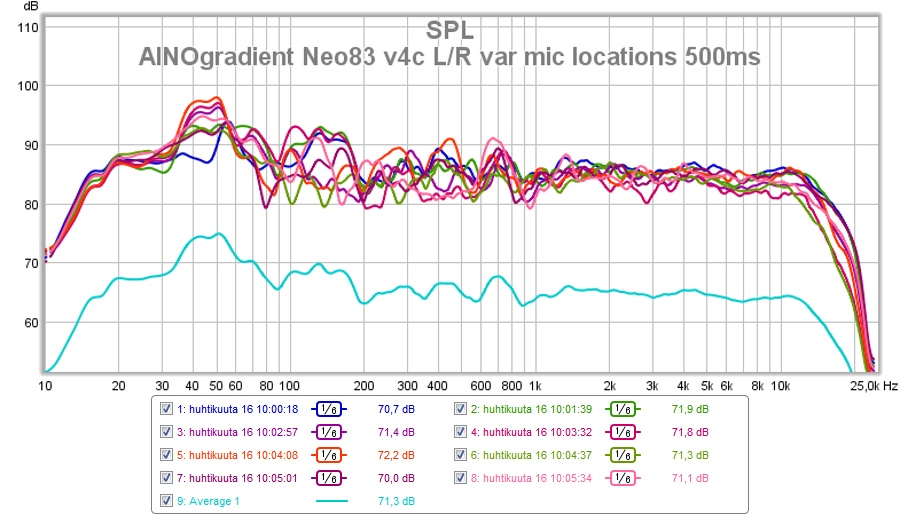

That response was quasi-anechoic. Room response that my dipoles produce and I like is almost flat, some measurements here. I don't use EQ for room modes!
