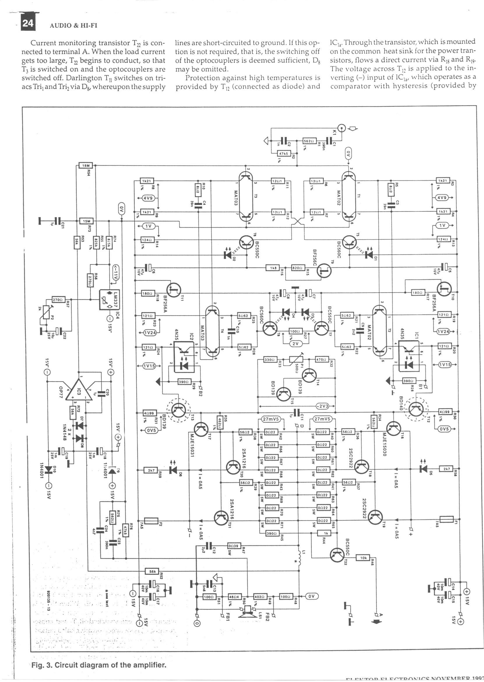

Elektor Amp for Ribbons
As menitioned in the Planar forum, there was a construction in Elekto for such an amp.
The articles was published in November and December 1992.
I'm sure you can get a back issue at Elektor, but otherwise, I can maybe make a PDF, and send it on a mail.
It's not a beginners project at all, and I think the construction might be a bit overkill, being able to diliver 160W in 0.4 Ohm.
Actually I think a small Class-d amp would be perfect for the job ..... at the very low voltages needed you could probably make one with a rather high switching frequency if wanted!
See attached schematic of the Elektor amp
