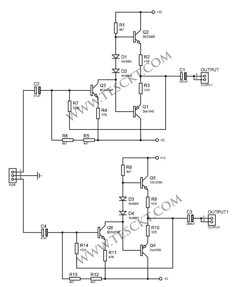

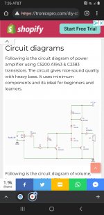

Can anyone explain why the direction of d1 and d2 diodes is opposite in these simple circuits? Thanks.

I thought so.
Why do they have it on their web page and youtube videos?
Thanks.
Because they get many thousands likes, million views, exaggerated praise, etc.

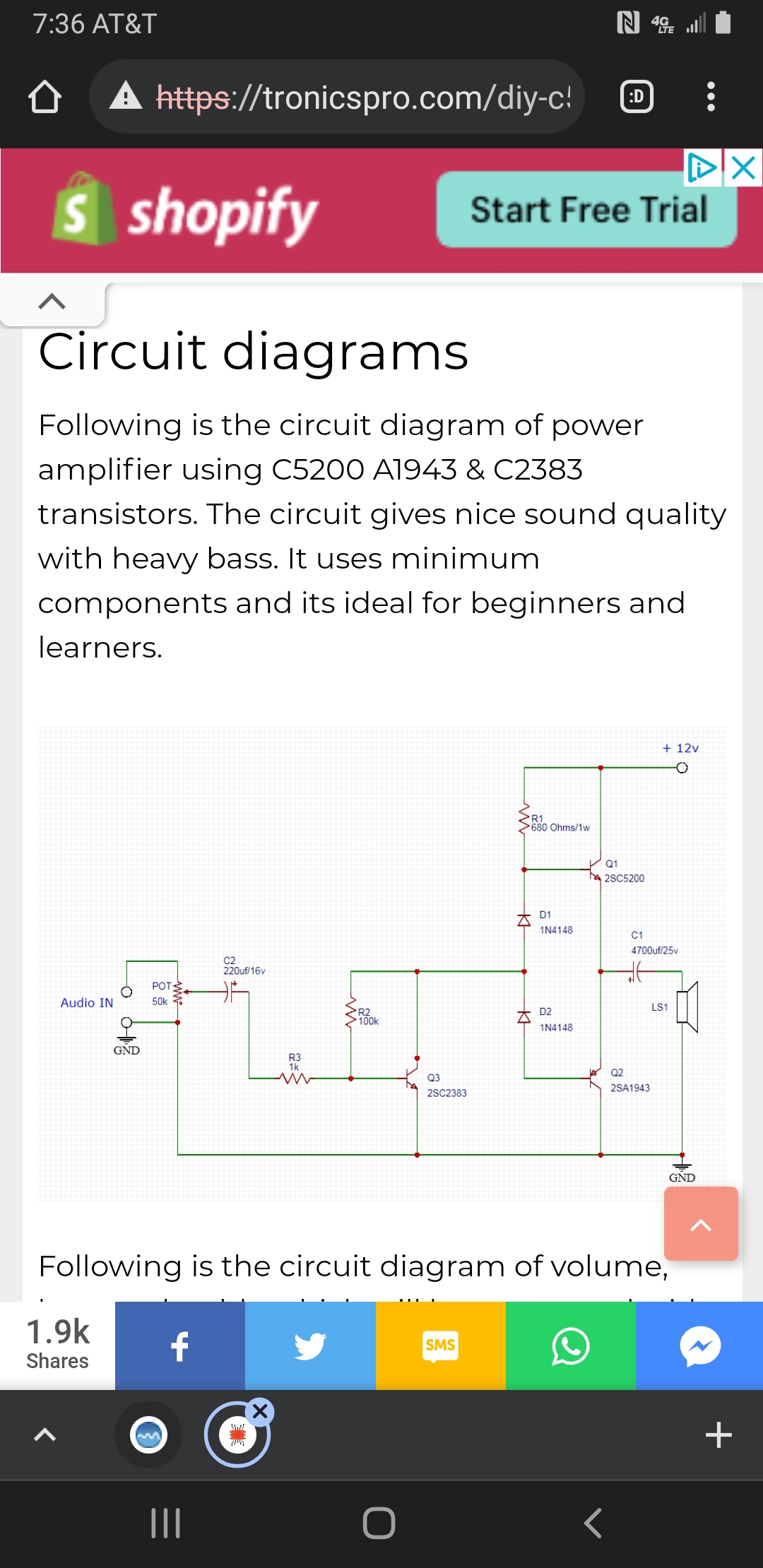

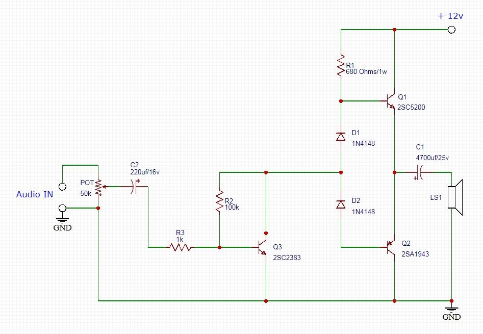

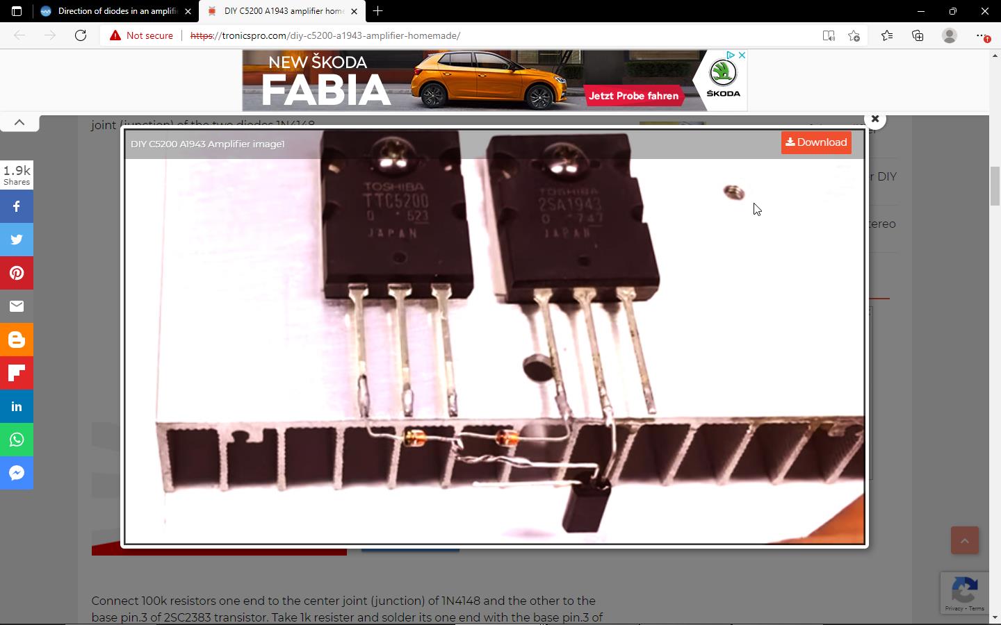

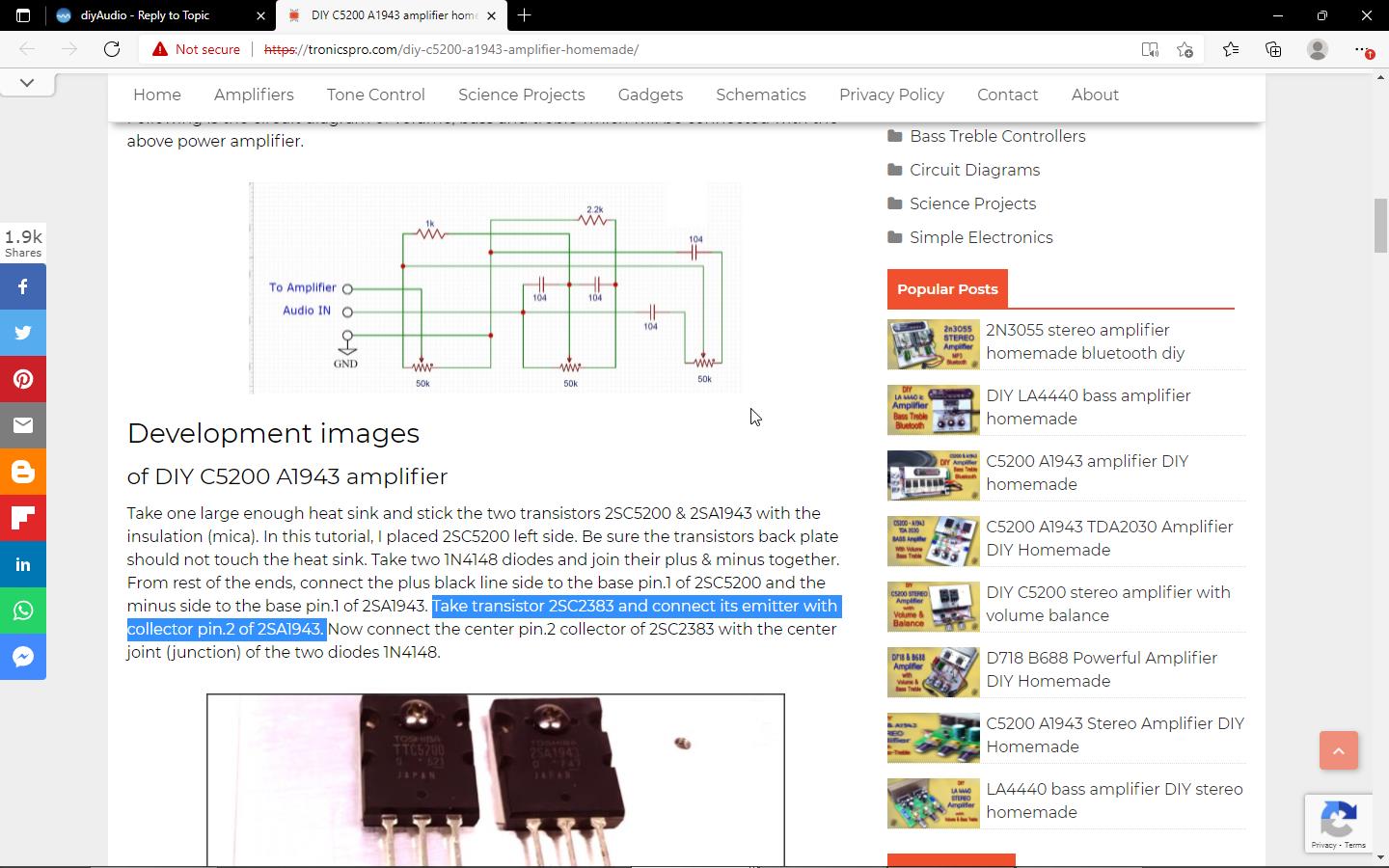

If we look at the site Pictured Version then we also see that the Emitter of 2SC2383 is connected to Collector of 2SC1943, so this give already another circuit..
Also read the Text.. Blue highlighted in the screenshot
Also in this picture below we can see the diodes are connected the correct way, mistake or bummer one or the other..
One of the both isn't accurate or possible both..
The Circuit will run when diodes are connected the visa versa./.
Have run it in my Simulation program.

Thanks hpro for checking it out.
I have lots of c5200 and a1943, i will build it just for fun of it.
But not the first schematics, second one in first post, the one showing feedback. That looks better and should eliminate some nasty crossover distortion.
