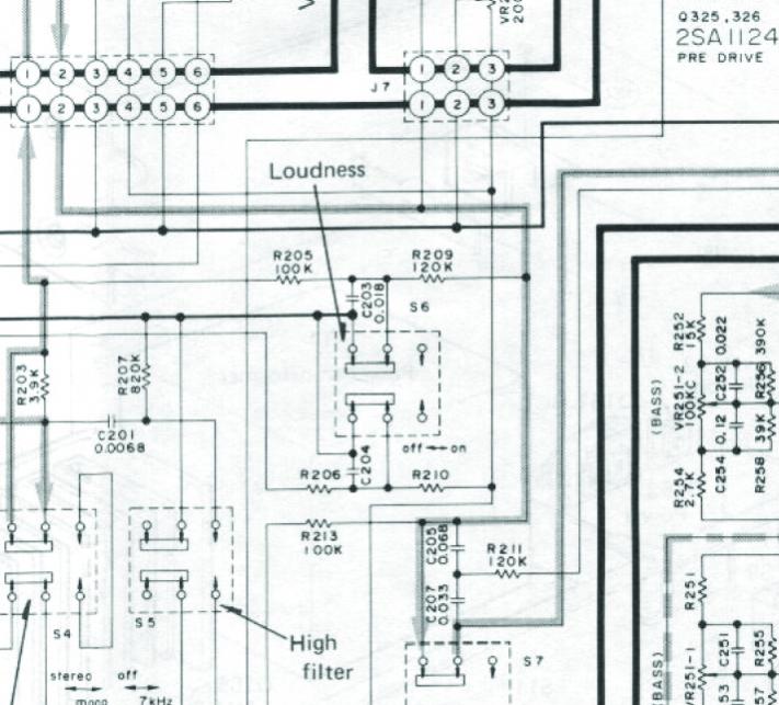

Thanks for the quick response Tony!
I attached a pic of the schematic zoomed in on the loudness switch in hopes that you or someone else can make sense of it. I can provide more pics if this one doesn't provide enough info.
With the amplifier casing removed top and bottom, I can see exactly where the switch is soldered to the pcb, but the switch itself is encased in plastic and I can't see which connection is being made (if any) on the pcb to put the loudness in the off position. My concern with leaving the switch soldered to the board and bypassing it is the possibility that while it's in the off position, the switch is making a necessary connection. Also, I worry that if I simply bridge the points on the board to make the loudness off, and if while in the off position a connection is still being made by the switch, it would cause a damaging or hazardous short if the switch were to be pressed to the on position.
Thanks again for bearing with the newbee!
Just a hint from another SUV Technics user - yes mine did the same with the tape monitor and tone bypass switches dying all the time until I realised that the problem was silver plated contacts on the tiny open backed alternate action switches.
This is bad in urban environments, as the silver forms insulating compounds with various components of the very air we breathe. I used contact cleaner/lubricant with lots of "working" of the switch with great success but this needs a re-clean every couple of years in my coastal environment.
Hey, it's dead easy and it works, ok?

I spent the $8 on some CRC contact cleaner and everything works perfectly. Thanks for the tip Ian! I didn't get the lubricating kind because a local vintage audio shop advised against it. Not sure why he recommended not using the lubricating kind though. Anyone know?

Without schematic or overlay diagram, I can't be sure what you are referring to there. It's confusing with this design since it is 2 amps in 1 and not straightforward.
