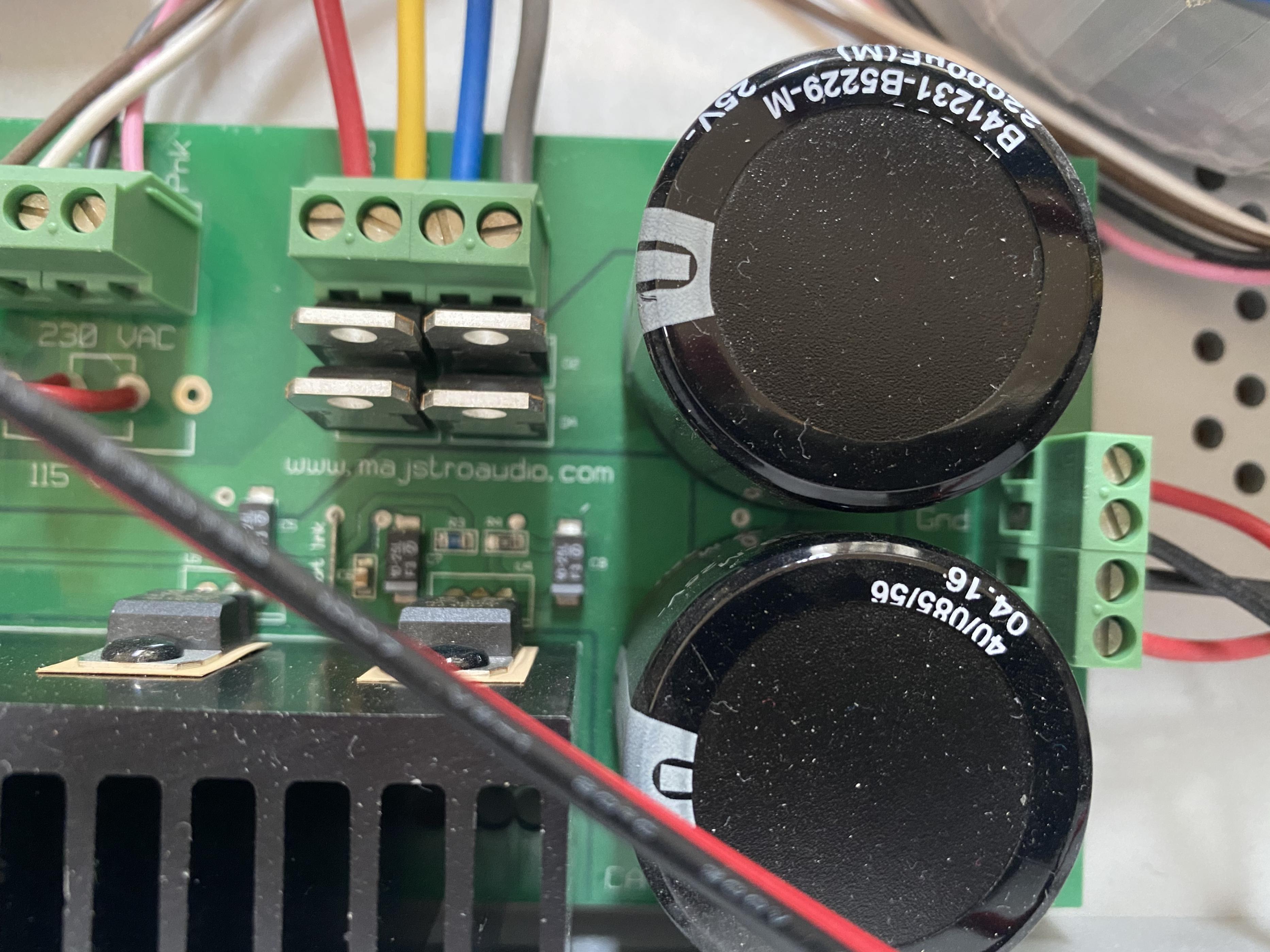

Post a picture of the power supply and maybe we can better guess it's power capability, but part numbers are generally more helpful.

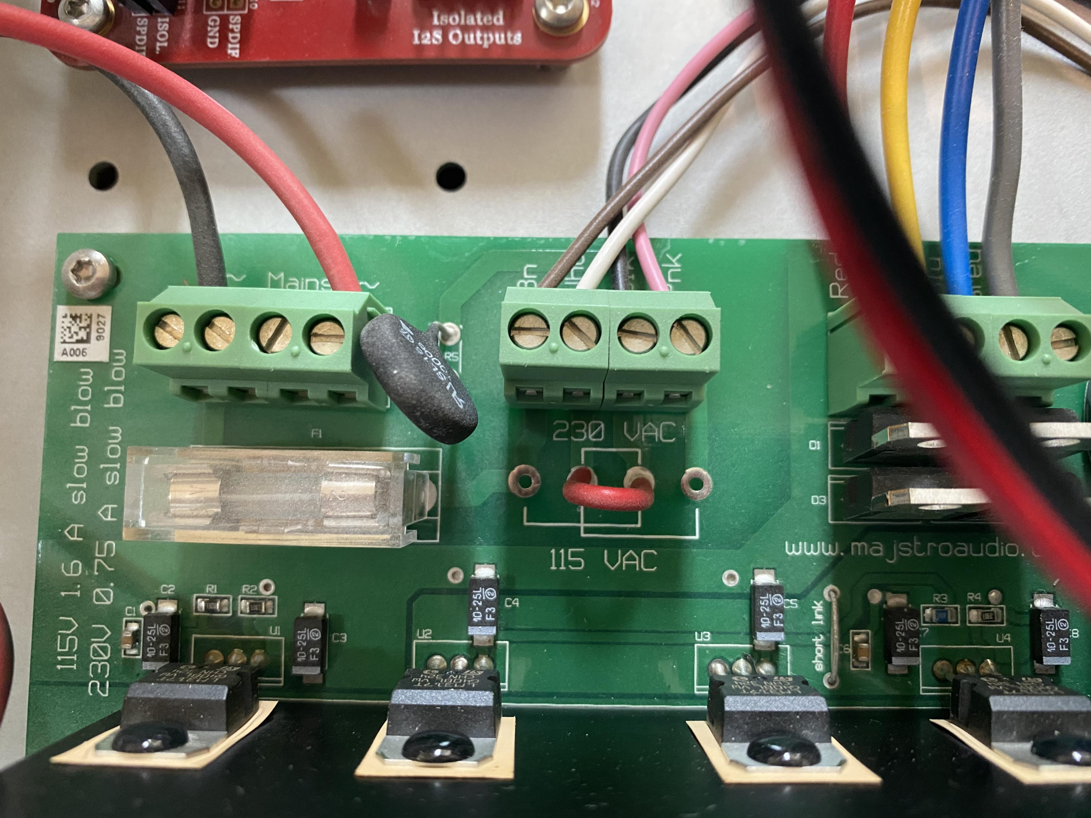

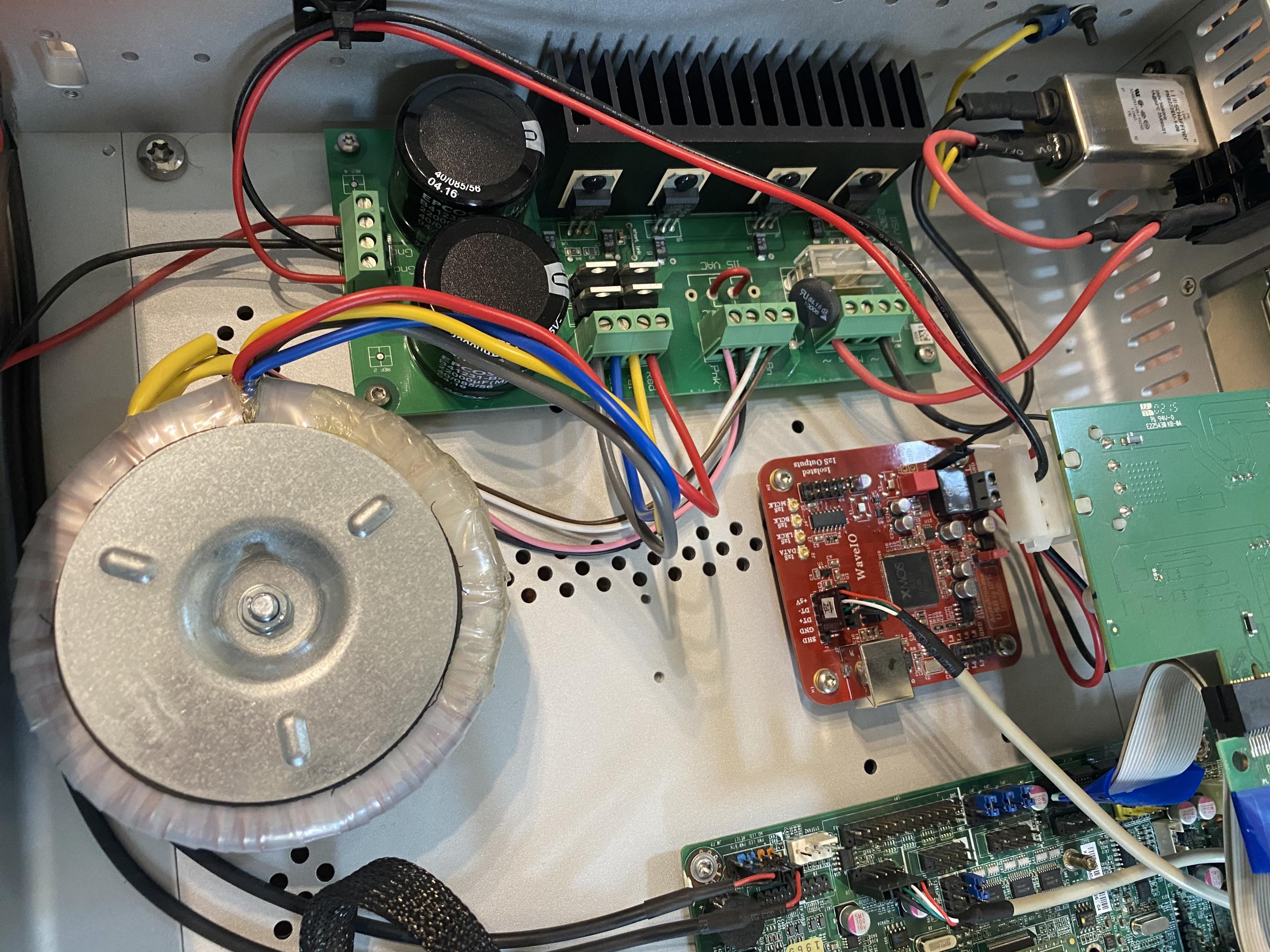

- I will open the box tomorrow morning and post pics.

230V*.75=172.5 W According to the fuse spec. Assume 150 W.
Check the LM317/337 datasheets. I see two on the middle picture. Seem to be paralleled.
The ST Microelectronics LM317T chips in that board are rated for 1.5 amps each. It does look like at least two of them are wired in parallel, possibly three.

There are two outputs - 12v to the motherboard and 5v to the JCAT USB card.

Thanks for the input. In fact, I identified the motherboard currently used. It is Jetway nf9m 2930. It is feeded on the 2-pin +9V ~ +36V Alternate Power connector (Molex 5566-2) with two wires coming from the power supply (GND and power).
I am not a big power supply expert, but I understand the linear power supply currently in there is of great quality for audio and replacing it would cost a significant amount. Hence I want to make sure that if I plug in another motherboard/cpu they can reuse the existing power supply. What i am not sure if I need to stay in embedded CPUs (so limited to Celeron and co), or that I can also plug in a socekted motherboard allowing me to use low power CPUs like the Core i3, i5, i7 T variants.
I don't mean to rain on your parade, but an LM317T-based regulator is not particularly high end, and the benefits (for hifi audio) of using it to power a computer are contentious. IMO a linear power supply is far more worthwhile just for powering your WaveIO USB interface.I understand the linear power supply currently in there is of great quality for audio

If your motherboard does run at 12 volts, it can draw maybe 50 watts total from that supply on 12 volts.
So I would use a conventional switchmode computer power supply, possibly the smaller SFX form factor.
If space is at an absolute premium, use a picoPSU (as Tubelab_com suggested) in combination with an external 12V "brick" SMPS.
So if you upgrade to a socketed mini-ITX motherboard, with an i7T processor, I estimate you will be over this 50W.

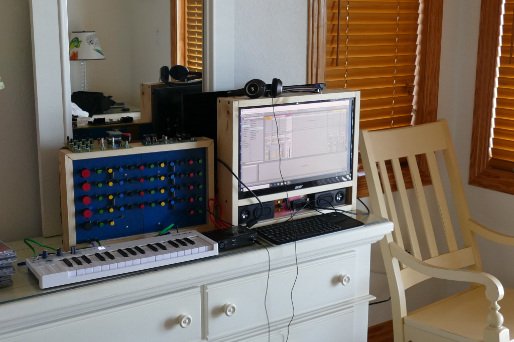

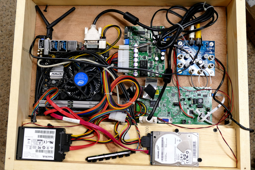

Here are some pictures of a crude portable PC that I built in a wood box back in 2017. It uses components similar to what's described above.
The motherboard is an ASRock mini-ITX H270M-ITX/ac with a core i7-7700T which is rated at 35W TDP. 35W is not the maximum that the CPU will draw, it is a weighted average. Under peak loads the CPU "turbo's" its clock speed up until the maximum core temperature is reached, then "throttles" back to stay around 35 W. This system uses the on board video and audio which are sufficient for the intended mobile video, and audio editing, and music creation applications. An external USB sound module is used for critical sound quality applications.
There are two SSD's, one is used for booting and program storage. The other is for data storage. All modern SSD's run from the 5 volt supply only and draw less than a watt when not being accessed. There is a 2 TB conventional spinning Samsung. It is run in standby mode (not spinning, and well under a watt). It is for pictures, video and music.
The green board in the center is a power supply that takes a 6 to 30 volt source, and produces all the voltages needed for a typical "ATX" motherboard. It came from mini-box and claims an efficiency of over 95%. I run this computer on a large 24 volt 5 amp brick, or a 22 volt 5000 mAH LIPO battery intended for a model helicopter (not present when these pictures were made).
M4-ATX, intelligent ATX automotive power supply, 6/30V - power your PC in a car.
The large green board is the board from a 19 inch ACER display that I removed from it's plastic case. The LCD panel is on the other side of the box.
The blue board is a TI class D amplifier evaluation board rated at 10 WPC from a 12 volt supply. It feeds the pair of Tang Band speakers on the front. Headphones are driven directly from the motherboard's headphone output.
This system IDLES at 27 to 35 watts, about 10 of that is consumed by the display. A simple task like playing a 1080 video streamed from Youtube over WiFi pushes it to around 50 watts. Running a DAW like Ableton Live can push the average power demands up near 75 watts and sometimes over 100 watts. Loading up Ableton with a bunch of software music synthesizers, can get the the CPU utilization up into the 60% to 80% range causing peak demands of over 125 watts. All measurements were done by measuring the actual current and voltage on the 24 volt input.
This shows that a 35 W TDP chip in a conventional motherboard can still eat a lot of power, depending on the CPU load. If your power supply can not source the required power without limiting there will be erratic operation and possibly damage to the system. This possibly led to the death of the CPU chip in this system. My Amazon sourced 24 volt brick kept limiting, or shutting down unexpectedly when I attempted to render a 1080 video on this computer, sometimes it worked, sometimes, it crashed, one day it just died. The CPU was dead. I have been using a Meanwell 150 watt 24 volt supply for power since then with no issues.
The pictures show what's inside the box, and it's use on a vacation trip in 2018. It is being used with a DIY music synthesizer, an external music keyboard and audio interface that runs from the USB port consuming another 5 watts .
