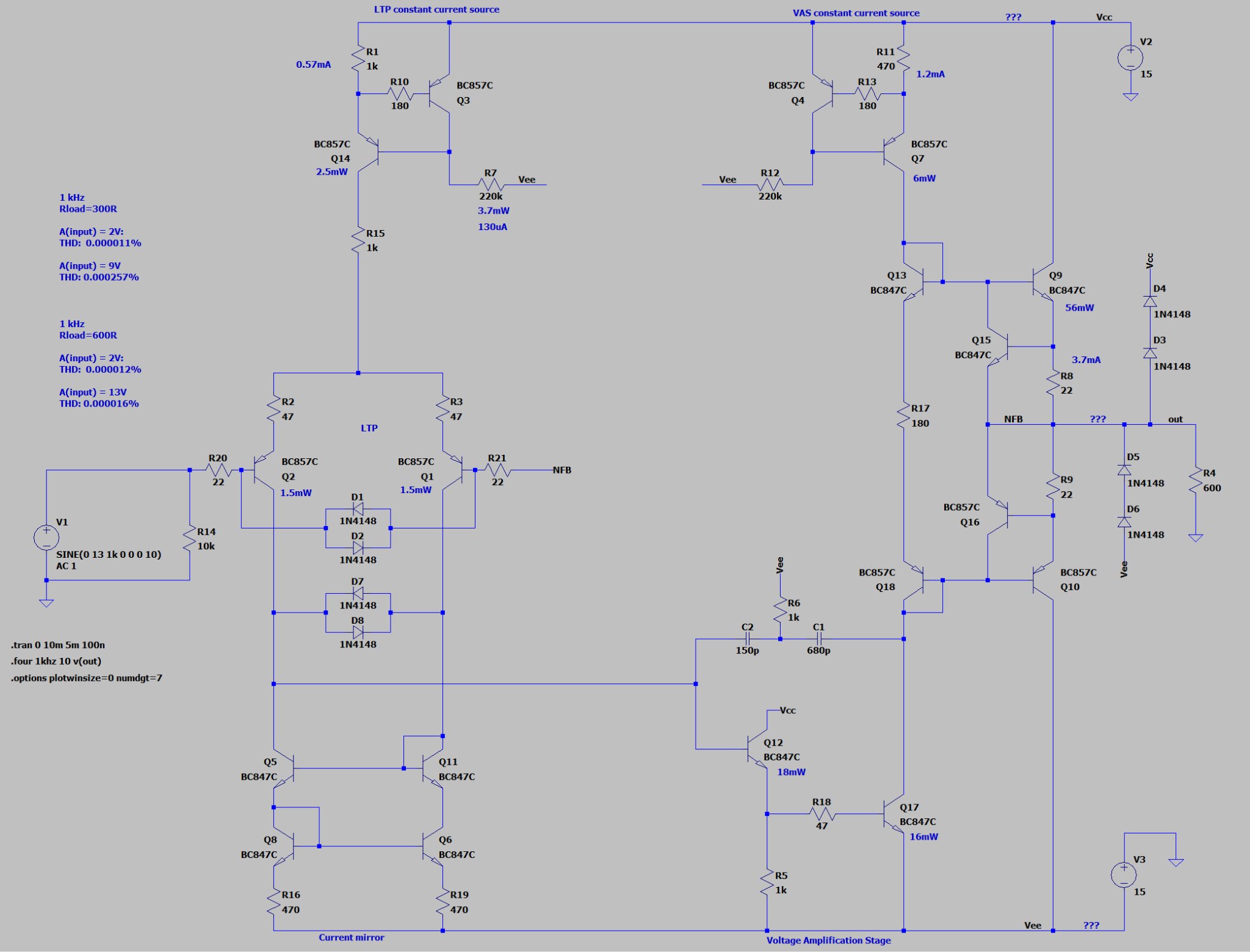

Inspired by the three-stage topology, I set out to create opamp schematics consisting of discrete components that offer distinct design advantages over commercially available opamps. Main goal of my design was achieving a high open-loop gain within audio band frequencies. To accomplish this, I employed an advanced type of voltage amplifier stage (VAS) compensation known as two-pole compensation. This technique creates two poles on the Bode plot, effectively expanding the open-loop gain at higher audio frequencies. As a result, the loop gain plot exhibits a steeper roll-off of 12 dB per octave, compared to the simpler Miller compensation method, which rolls off at a rate of 6 dB per decade.
To optimize LTP, PMP5201 and PMP4201 matched double transistors were used. These transistors are essential for ensuring precision in the input differential pair, current mirror, and constant current sources. Using just two matched devices also simplifies the bill of materials.
Update: newly redesigned opamp uses all 2N3904/3906 transistors as those offer higher bandwidth resulting in better performance. See post #17

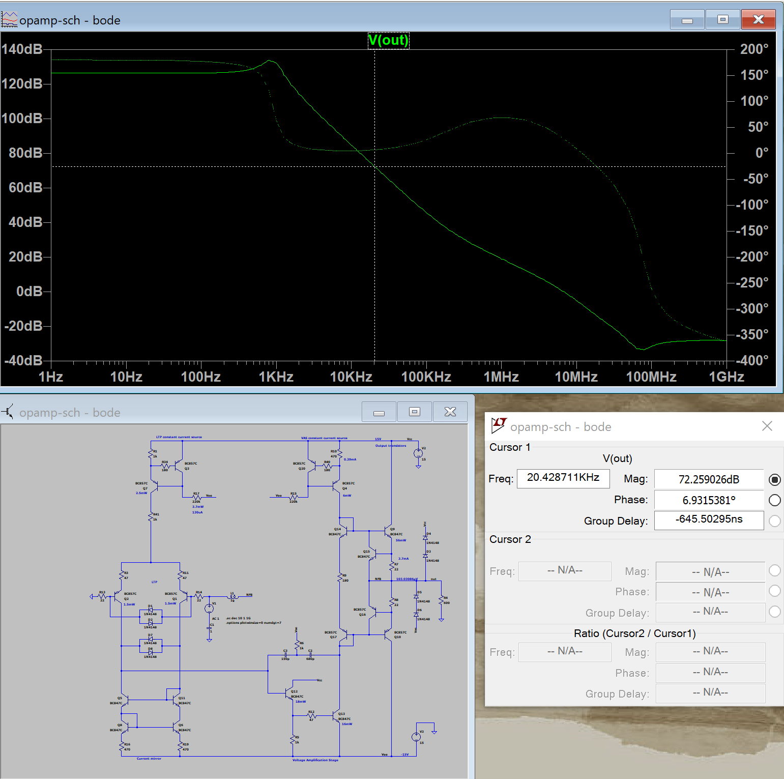

AOL (100Hz): 118dB
AOL (20kHz): 72dB

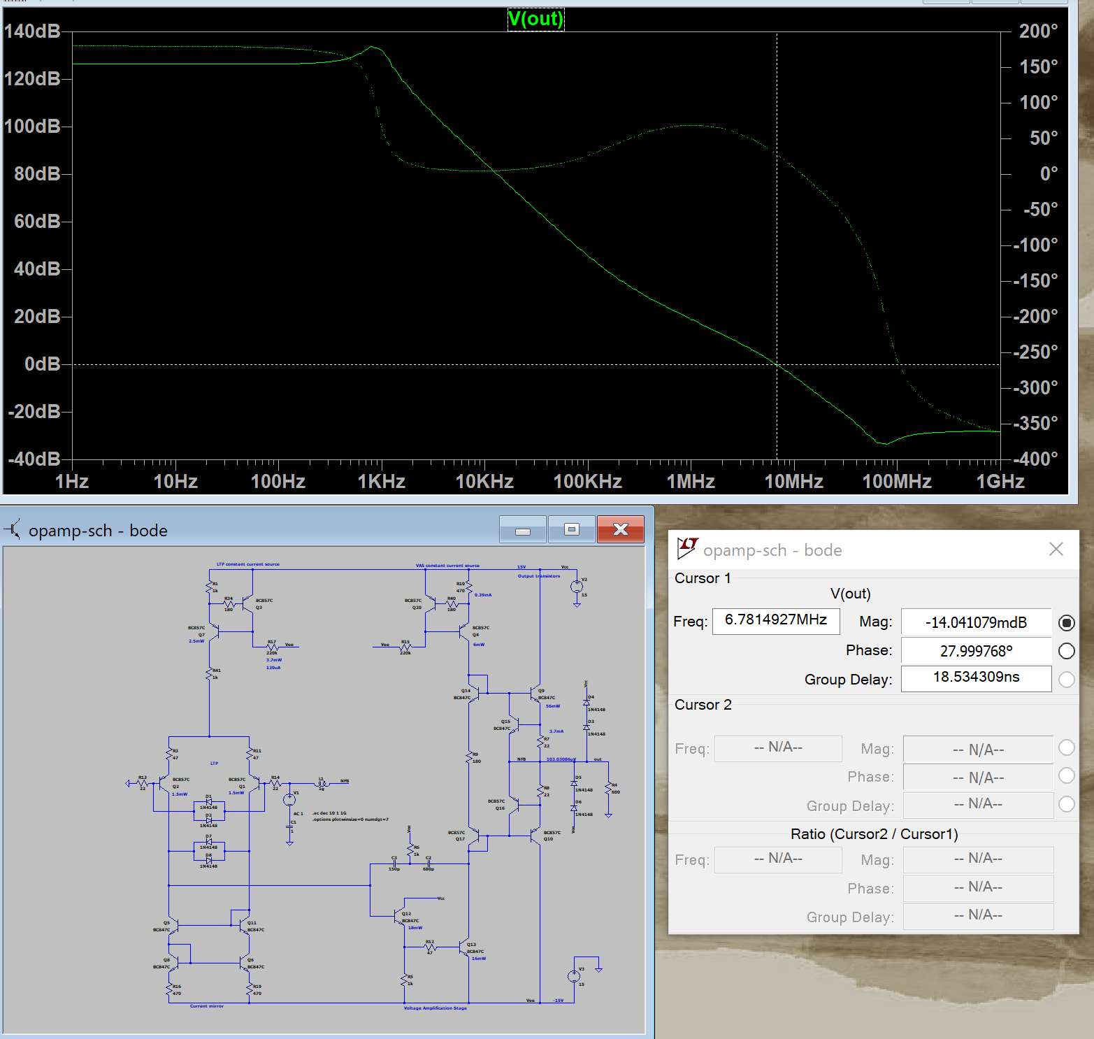

This is posted as a concept and does not perform correctly in frequency response simulation yet.

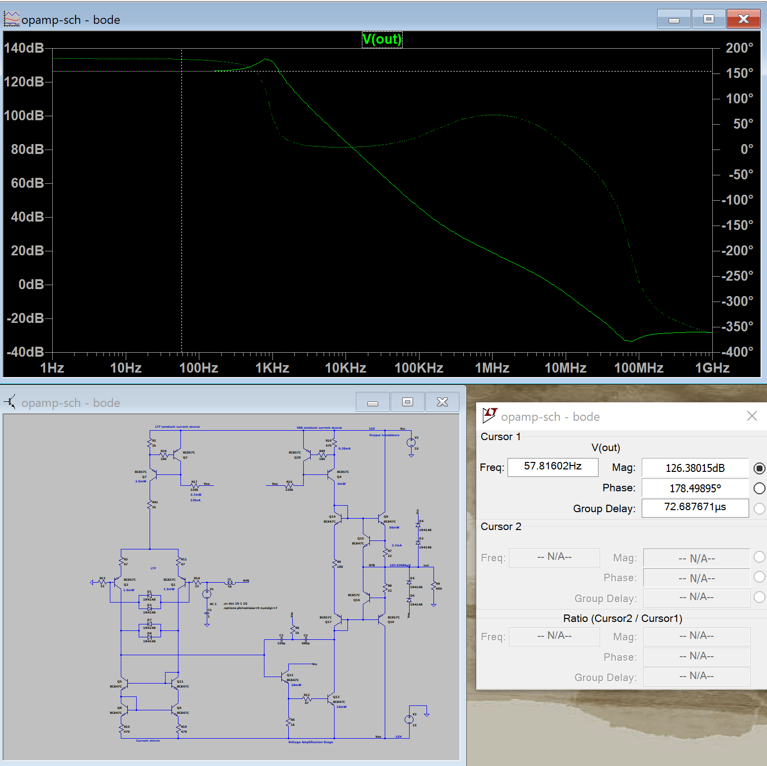

Is there any proof for that claim?By using discrete components, this opamp offers enhanced sound fidelity
Sound fidelity or not, a discrete opamp built along an integrated opamp topology will have the same shortcomings - for example, common mode distortion. Try feeding your circuit from a higher impedance signal source and see what happens. In addition, this amp doesn't include overcurrent protection at the output, which comes standard in all integrated opamps since uA709. BTW how it behaves when clipping?
Also, two pole compensation means the phase margin, which is not phenomenal to start with, will be degraded when your configure the amplifier for a higher gain, say, +10. It will have more ringing at fast transients. Using frequency dependent feedback network with a two pole amplifier, as in filters, can be fun.
Oh, and current sources do not need matched transistors. It won't hurt, of course.
I try to avoid competing against IC op-amps on the same metrics.
Rather, I design for moderate open-loop gain (60dB). Then, the open-loop distortion, bandwidth, and PSRR can be much better. This works in most circuits that don't require enormous open-loop gain.
Ed
Ed

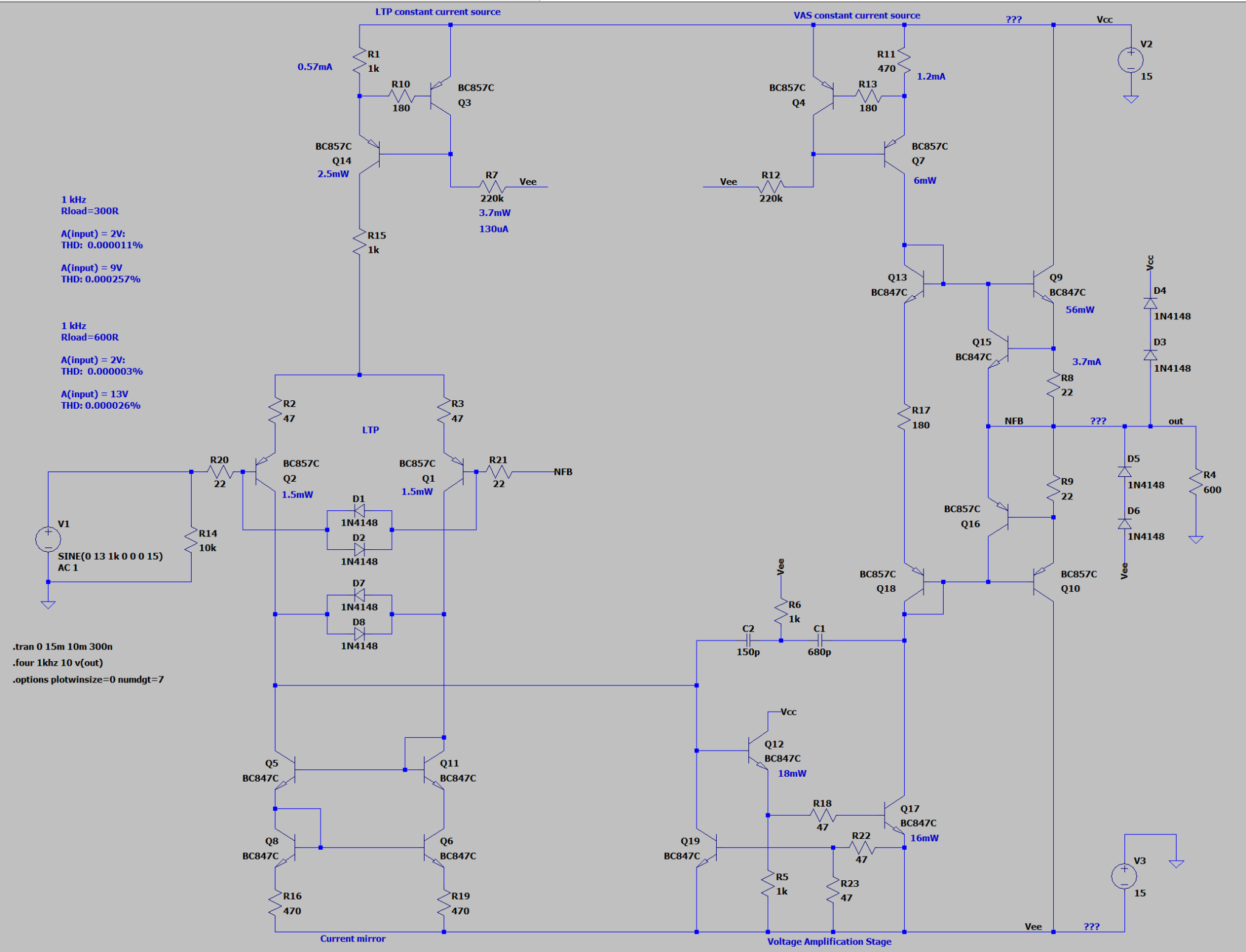

Few updates:
Added current limiting transistors at the output to limit 0.6V/22R = 0.027A or 27mA
Added protection diodes
Changed all transistors to BC847/BC857, adjusted current for LTP, changed degeneration resistors - reduced noise down to 2.3 nV/Hz/1/2
Simulated I to V converter for current based output DAC
All results and LTSpice simulation files are attached

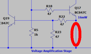

With this kind of protection, you also need to protect from overcurrent your Q17 (the VAS common emitter transistor).Added current limiting transistors

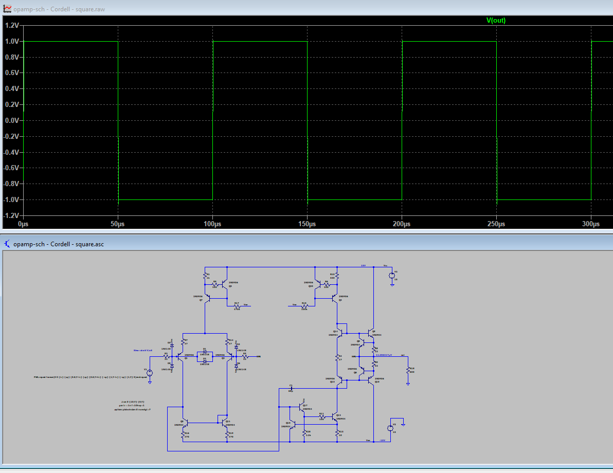

I would assume all those additions will add a lot of OLG which will probably make it harder to compensate.

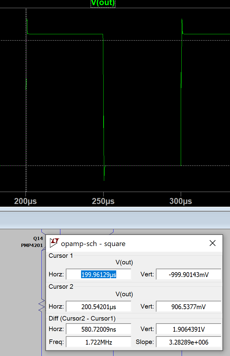

It has been a challenge to apply TPC to the current version. And I am not sure I did it correctly as a square wave response still shows overshot.

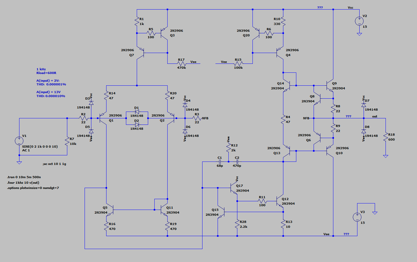

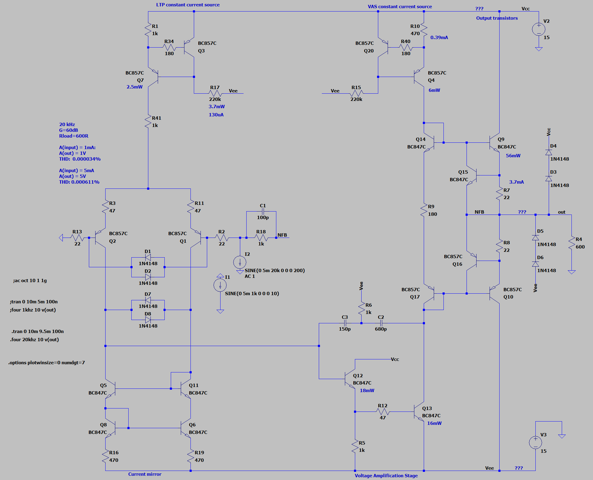

Thank you all for the input - now I added everything that was suggested
So I was able to get 0.000001% THD from this topology!
All 3906/3904 transistors.
LTP current was set to 580uA, VAS current was set to 1.88mA, and EF OPS current was set to 2mA.

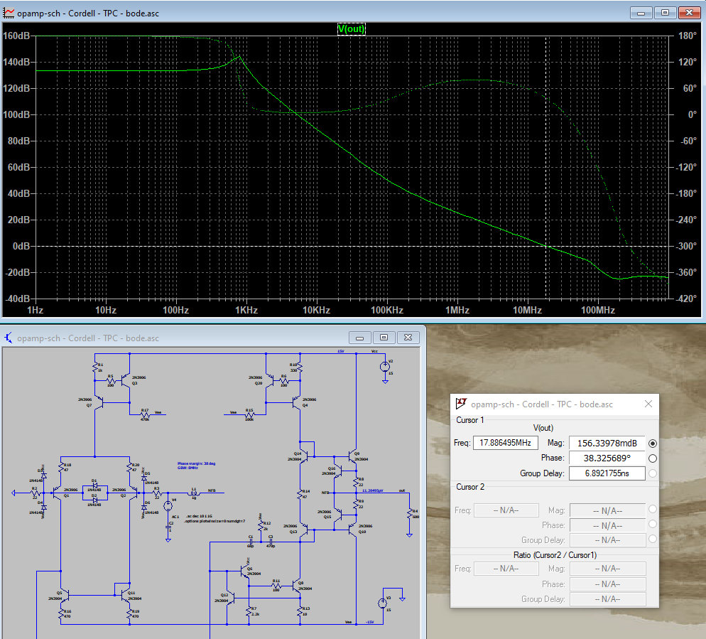

Instead of playing with two pole compensation I started with a simple Miller cap. This allowed me to find optimum operating conditions as far as the phase margin that is usually set to be at least 45 degrees on Bode plot where the gain is equal to 0 or GBW.
Only after experimenting with Miller cap I changed to TPC.
I also simulated overvoltage and overcurrent conditions by sending 20V of sine input into the amplifier and by changing the load to 1 ohm. As a result of this test I added protection diodes to inverting and noninverting inputs and also added overcurrent protection transistors to VAS and OPS.
New specs (for TPC version):
THD (G=+1, 600R, Vin=2Vrms, 1kHz): 0.000001% or -160dB
THD (G=+1, 600R, Vin=13Vrms, 1kHz): 0.000020% or -133dB
Voffset: 0.011mA
GBW : 18MHz
Phase margin: 37 deg
AOL (100Hz): 133dB
AOL (20kHz): 76dB
Noise: 2.36 nV/Hz1/2
Slew rate: 6V/uS

Great work! Looking forward to the prototype measurements. Hope you can test with all three sets of PMP, BC and 2N diff stage transistors.
Thank you!Great work!
I wish I had Audio Precision Analyzer APx555 for that lolLooking forward to the prototype measurements.
PMP appeared to be the noisiest out of all.Hope you can test with all three sets of PMP, BC and 2N diff stage transistors.
As it is, LTP transistors 2N3906 are contributing 1 nV/rtHz of noise each; totaling in 2.32 nV/rtHz at the output.
If I change LTP transistors to PMP5201 they are twice as noisy at 2 nV/rtHz each; totaling in 3.46 nV/rtHz.
BC857C each contributes 931 pV/rtHz; totaling 2.24 nV/rtHz.
BC857C is 100 MHz
vs 2N3906 is 250 MHz devices
Not sure if that matters for LTP, but I was able to get better performance when all 3906/3904 transistors were used.
