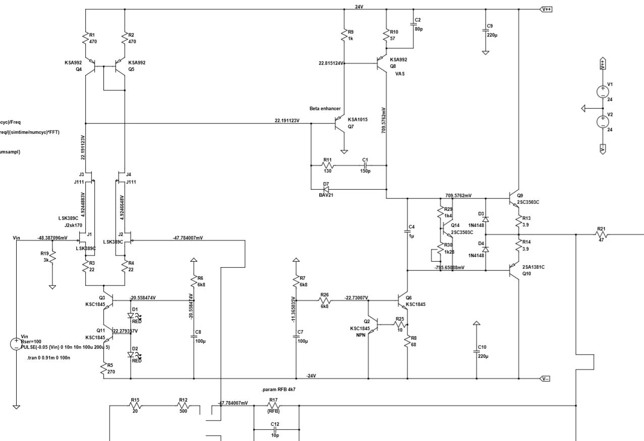

Initially I noticed a difficult to null offset,
Unloaded, the response peaked at 250kHz and sinusoids presented distortion in the negative part indicating slew issues.
I reduced IPS current to 4mA (R5 270ohm)
Also reduced VAS current to 9mA (R8 68ohm)
Adjusted output stage idle current to 15mA
Reduced VAS gain by increasing emitter degeneration (R10 57ohm)
And added a capacitor parallel to R10
Now I minimized overshoot and response is flat to 2MHz (unloaded)
Interestingly, the capacitor over R10 must be 330pF when operating at unity gain but it must be higher than 1nF if I use feedback to have gain.

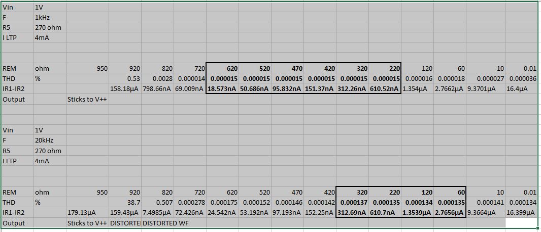

Joined 2006
Made some measurements that indicate the correlation between LTP Mirror emitter resistors and distortion.
It seems that I can minimize THD at 1k and 20k by choosing emitter R to be 320 ohm...

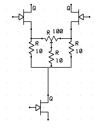

Joined 2006
In my build I use a trimmer over R1 to null output offset..... now I see this is not the ideal as different values over R1 and R2 will surely increase THD.
My experiments indicate that trimming the input fets degeneration resistors can also null output offset but without affecting THD..... but a trimmer there might leave a strong sonic signature...
Joined 2006
Demian Martin suggested:
"This is what I have used very successfully for offset trim. It limits the current through the pot wiper which is important. The resistor in series with the wiper should be adjusted to the largest that will accomodate worst case offset differential between the two fets.
The pot needs to be a good one. I used vishay foil but those are $$$. Carbon would not be good for this. Possibly a wirewound would be the best reasonable but cermet may be as good.
I have also found that a stable thermal housing and reaching operating temperature is important before attempting to adjust.
I have also found that in some cases the lowest distortion is not at the lowest DC offset of the amplifier. usually this is at the -130 dBC distortion levels or lower."

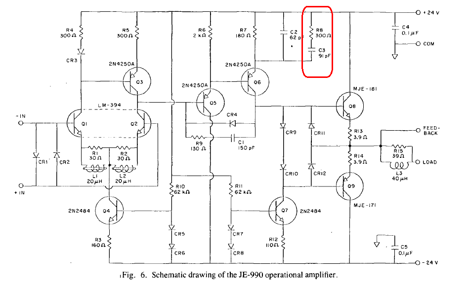

Joined 2011
You left out some of the magical components of Deane Jensen's JE-990 design: its mysterious frequency compensation that gives such excellent phase margin. The components you omitted are circled in red below. I've attached the relevant section of Jensen's paper, published in the Journal of the Audio Engineering Society. By the way, if you don't happen to be an AES member, it only costs USD 125 per year, and you get full access to their entire online library of publications.
_
  • Freq_Comp_JE990.pdf
Joined 2006
Thank you Mark
The 990 uses a highish emitter resistor in the VAS... 180ohm... I will read carefully the paper you posted and understand the solutions provided... as I am using a much lower emitter res, I left the zobel out until I totally dominate the technique.

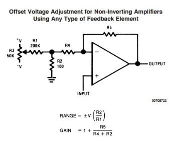

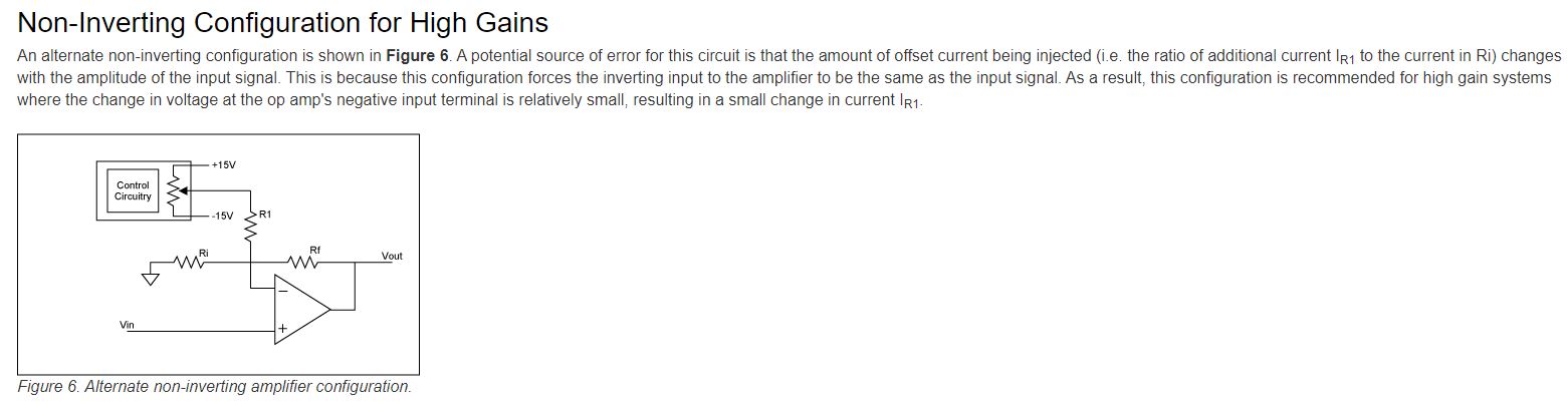

Joined 2006
I also found this circuit that might work and I would not need to trim the LTP degeneration resistors:
Regarding this solution, Martin wrote:
"Its a common solution, especially for opamps with no offset trim capability. It does require a stable external supply because the supply is the source of the correction. It can also inject noise etc if its not well managed. The circuit I use is also low noise and independent of external stuff. It would be interesting to check Vgs for a set drain current vs Vds. That has not been an issue in cascoded circuits for me since Vds is essentially fixed. I think internal adjustment of the actual offset would be best, especially if you are starting with closely matched Jfets. BTW I use depletion mode MOSfets for the cascode transistors these days. They work well."

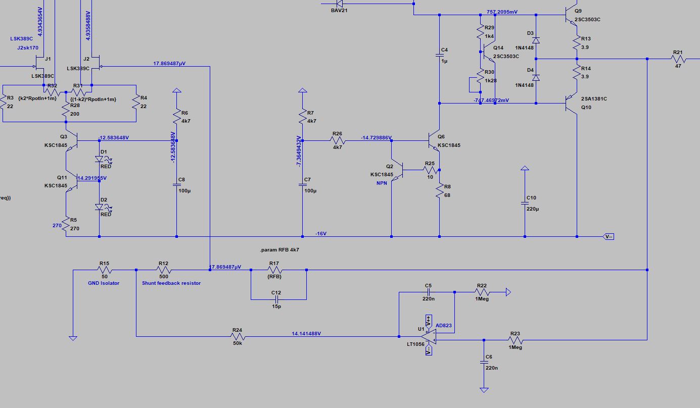

Joined 2006
I am using a servo to null offset and drift in my DOPA build.... I inject the error current directly into the inverting node..... should I inject it instead on the other end of the shunt feedback resistor (and separate this node to GND with a small resistor) ?

Hi stein
In the first post i left a sim with complete circuit.

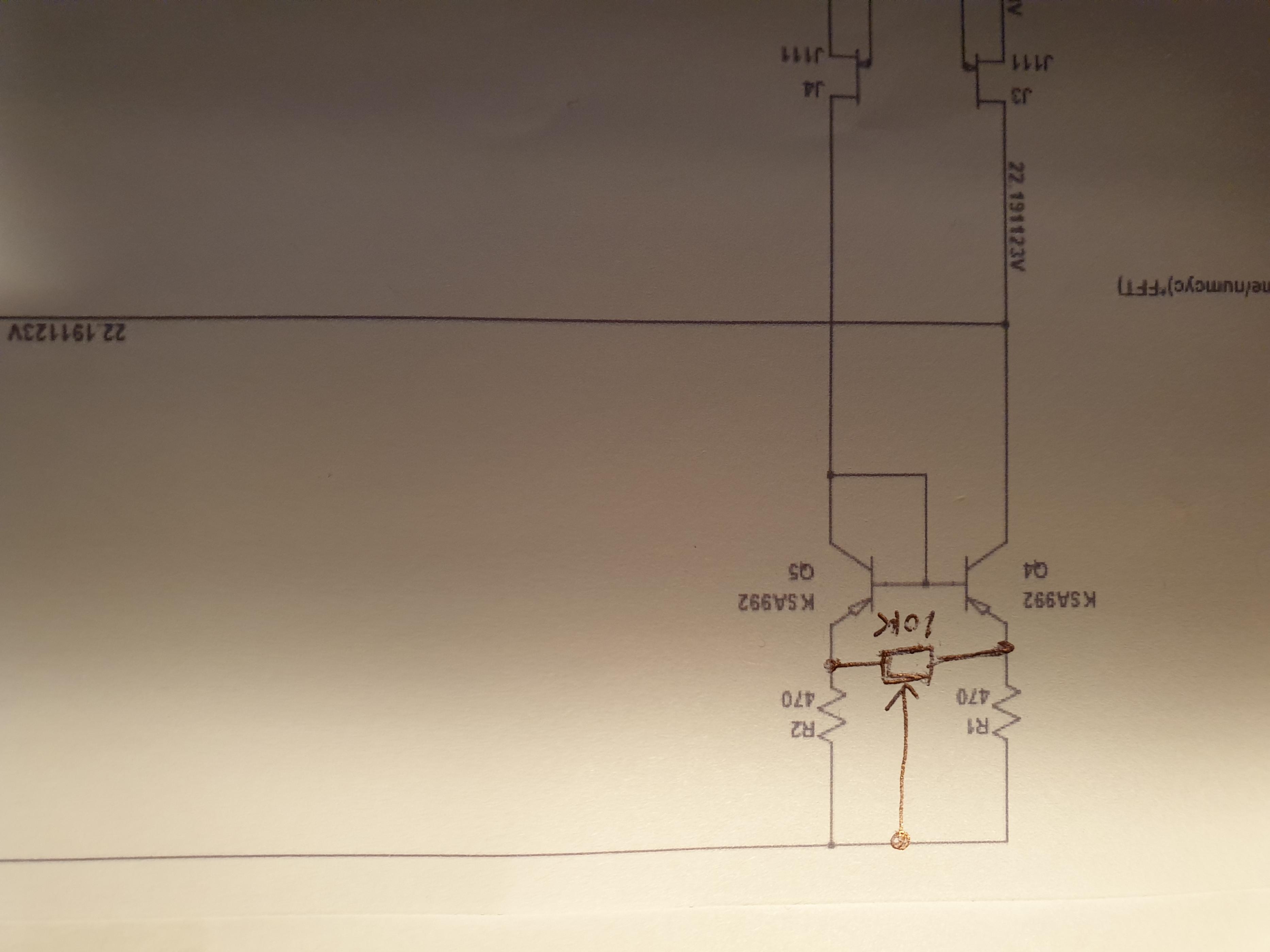

Hi Ricardo
Thank you, but to see it I have to install LTSpice and that is not going to happen.
I have looked on some of your previous posts and can see your "design".
I think you should try a 10k pot. with the wiper connected at the positive rail and the element between R1 and R2 see the drawing, that should null the DC offset at the output.
(This i my opinion: I would not null the offset like Damian is suggesting and in case you intend to use a DC servo I would not connect it to the negative input.)
One question why do you select this design and what is the reason you have chosed to use JFET ips instead of BJT?
In my opinion, if you for some reasons prefere JFET ips instead of BJT there are much better ways to design a circuit with lower noise and THD that will fit into a 990 package.
