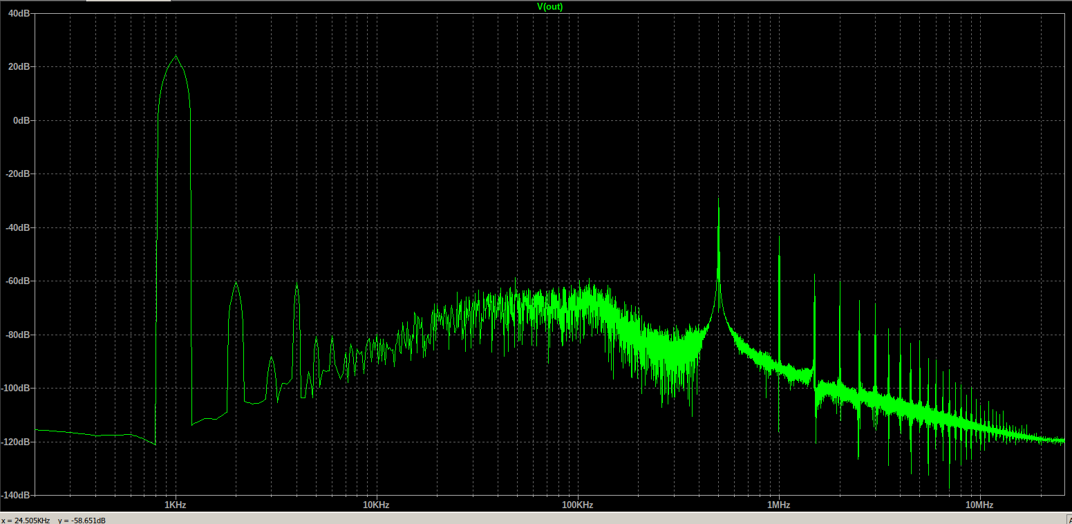

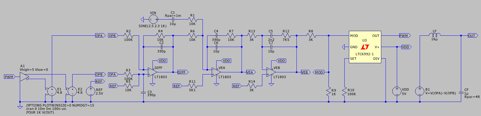

Cute. Unfortunately it would appear that the LTC6992 is going to be the main limitation on your achievable distortion figures. The datasheet...
https://www.analog.com/media/en/tec...ata-sheets/LTC6992-1-6992-2-6992-3-6992-4.pdf
Indicates that it has an internal error loop involved in generation of the PWM signal and the settling time of 8*Fmaster suggests the bandwidth of that loop is basically 1/8th of the base frequency. In your 500KHz case that would be 62.5KHz.
The above figure is not unreasonable. Pre-filter feedback involves converting the bridge switching node voltages to a triangle wave with a differential integrator prior to comparison with the reference triangle wave in the PWM modulator. The amplitude of that triangle wave at 50% duty cycle is constrained by slope matching requirements to be half of the amplitude of the reference triangle wave. If you run through the sums then that sets the ultimate loop crossover frequency at Fs/2PI where Fs is your switching frequency. Fs/6.28 is kind of close to Fs/8 give or take manufacturing variances.
However because you are forced to close your loop around the internal loop of the LTC6992 you have to do so with a loop bandwidth below 62.5KHz. How far below that is one question but as a basic design strategy it would be reasonable to proceed on the basis of slope matching using the 1V control range of the MOD input as your starting point.
Basically if you select your integrating capacitors to produce a half volt amplitude triangle wave at the MOD input your external loop would be expected to cross over at 80KHz, 500K/2PI. You can't have that so you have to increase the value of those capacitors.
How much? Basically until the thing stops fuzzing at the extremes of modulation. The picture and .asc file is a suggestion as to how to implement the loop. C2 and C3 are the main integrating capacitors. There are two voltage error amplifiers.
If you ignore VEB then VEA gives you a first order response from DC. C4 is set the same as C2/C3 with R7 being that same as R4/R5 so the sections match and overlay. VEB adds another pole zero, C5/R12, set to be less than half the overall loop crossover. If you run the analysis with zero volts in, 50% duty cycle, the amplitude of the triangle wave at the MOD input is 300mV peak to peak. 500mV peak to peak would be 80KHz so the estimated crossover is 3/5ths this or 48KHz.

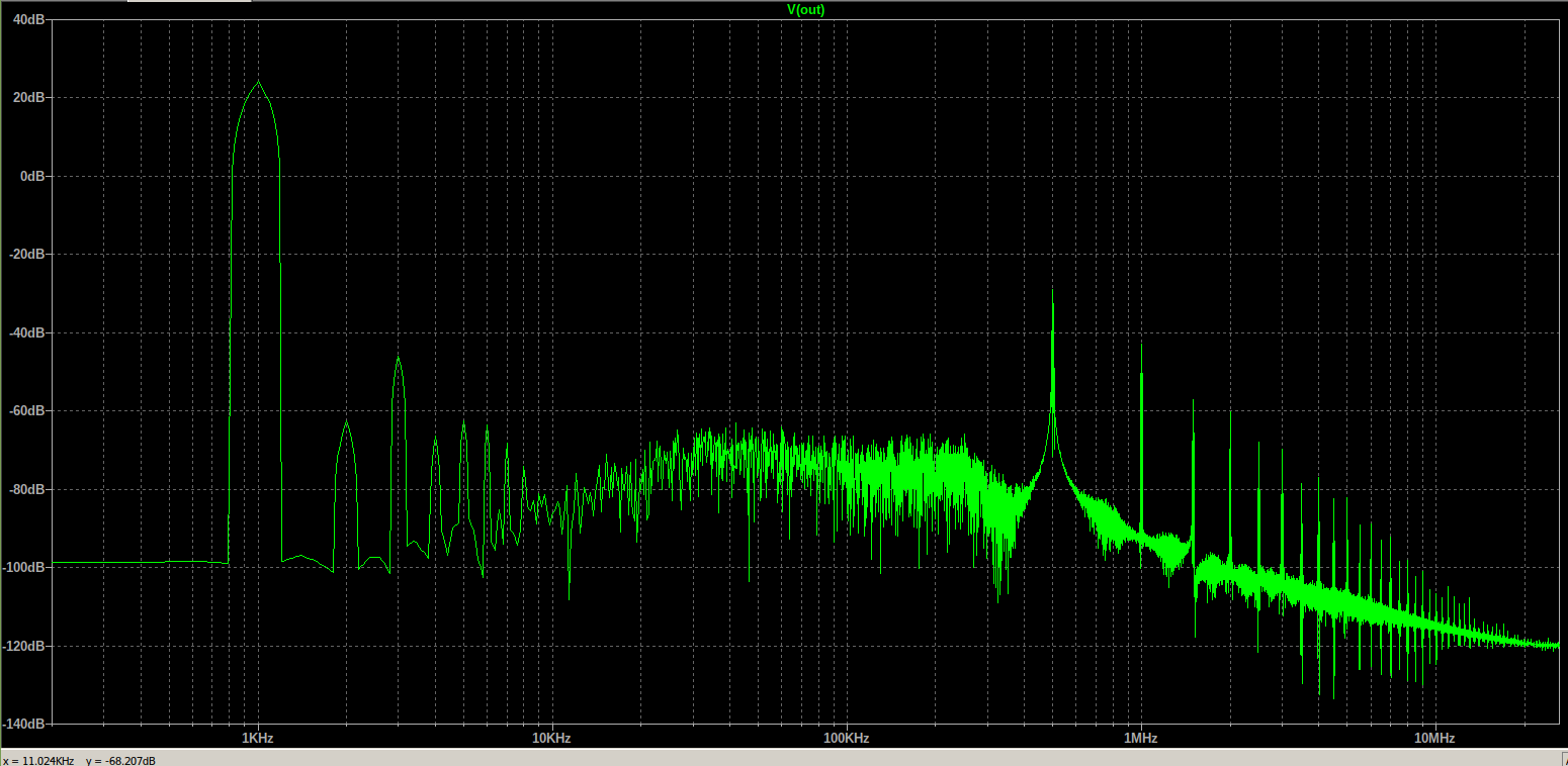

The plot shows the FFT of a close to clipping 1KHz sine wave with the indicated THD being about 0.03%. This is by and large a result of the inclusion of two Voltage Error Amplifiers to get as much loop gain as possible. In real life it will probably fall over.
There is a fundamental issue with the method used internally to the LTC6992 to achieve its PWM function. I won't go further than to say it does not like the ripple voltage that gets applied to its input as a result of this particular application. Unfortunately your THD figure will not improve if you reduce that amplitude by increasing the integrating capacitor values because you sacrifice loop gain in doing so.
However you can improve matters by increasing the values of C6 and C7. Those were initially in place to tame high frequency instability in the LT1083 amplifiers. Setting them to 68pF introduces two extra poles at about 200KHz attenuating the ripple at the MOD input. The second FFT shows the result with the indicated THD falling to about 0.008%
