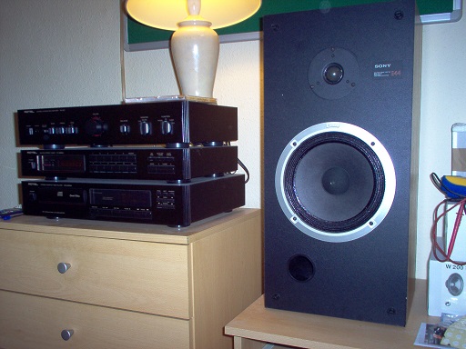

But most people use the term in a similar way to describe a speaker that can clean peaks high above it's nominal SPL. When a speaker can reproduce peaks at are 16-20dB above the average SPL without audible strain, distortion or other artifacts, I would call it very dynamic.
By that measure, my speakers are "dynamic." I had always thought of them as relatively neutral, but (as Mehitabel would say), wotthehell.
