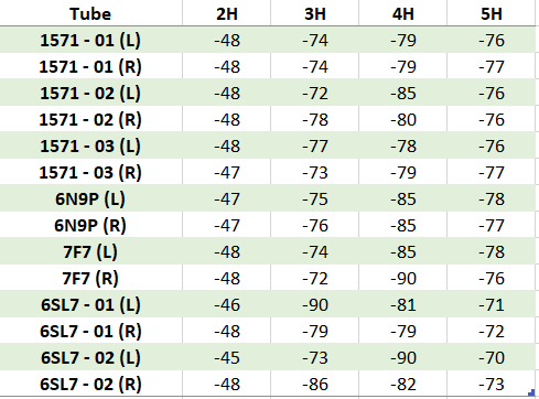

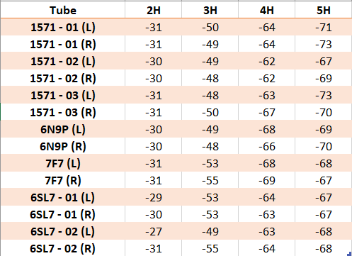

I decided to measure distortion at two operation points. One is when input signal is 100mV. This is a common case for most audio devices when 6SL7 tube is used in first stage. Second operation point was when input signal is 2V peak to peak. The reason for that selection was that in circuit which I used, tube automatic bias is about 2V. Thus this is close to maximum possible input signal for the test circuit before any clipping may be observed. Surprisingly all vintage tubes from my set required LESS heater current (290mA) than modern production tubes (330mA). But there should be no issues unless your device has dozens of tubes.
First test was to check DC operation point. For all tubes plate voltage was 200V, bias 2V and idle current 0.9mA, with variations no more than 5% from tube to tube. It means that all tubes could be used in the same circuit without need to adjust other component values.

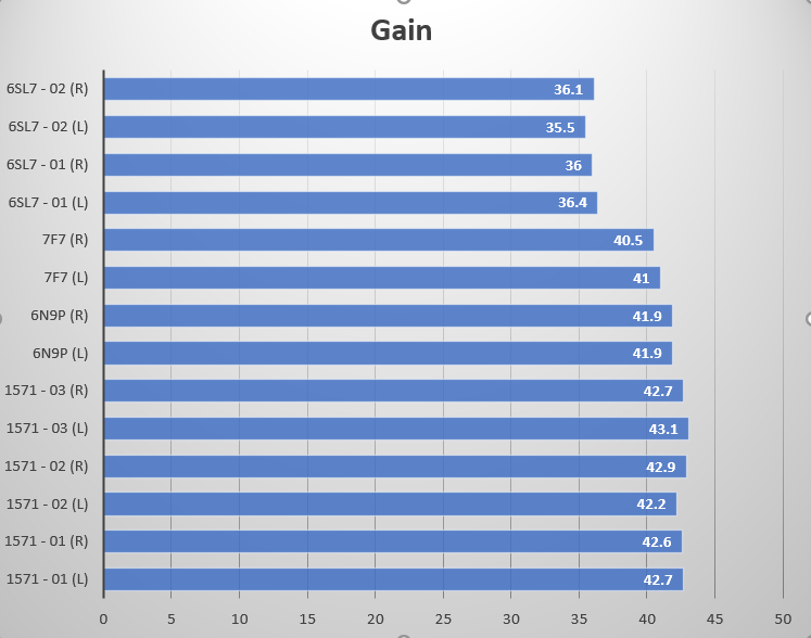

When I measured gain, I found that there were two groups: 6SL7GT tubes had lower gain than all other tube types. It means that with circuit that depends on feedback, there will be significant difference in response, due to lower gain of circuit before feedback is applied. Considering that 6SL7 tube is mostly used in first stage and gain is multiplied by following stages, it could become a serious problem.

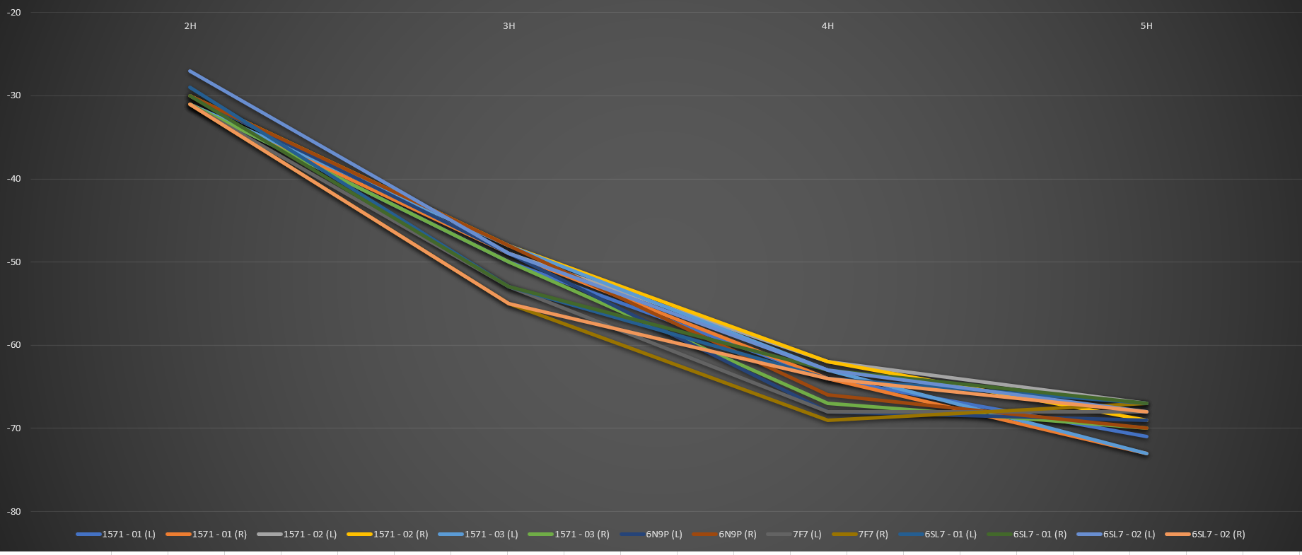

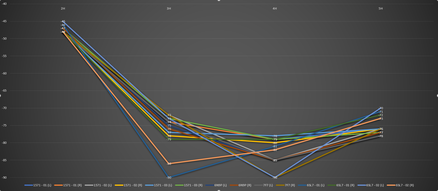

Finally I ran series of tests where I measured distortion components. Results are presented in table and graphical forms. As you can see, variation of harmonic profile are bigger at low signal level than at high signal level. How that influence perceived “sound” of the tube is open for discussion. But nevertheless I could not find any “huge” difference and sound differences between tubes should not be easily heard. You need to be well trained to there these differences, and this is likely only possible wen you hear two amplifiers with different tubes side by side.

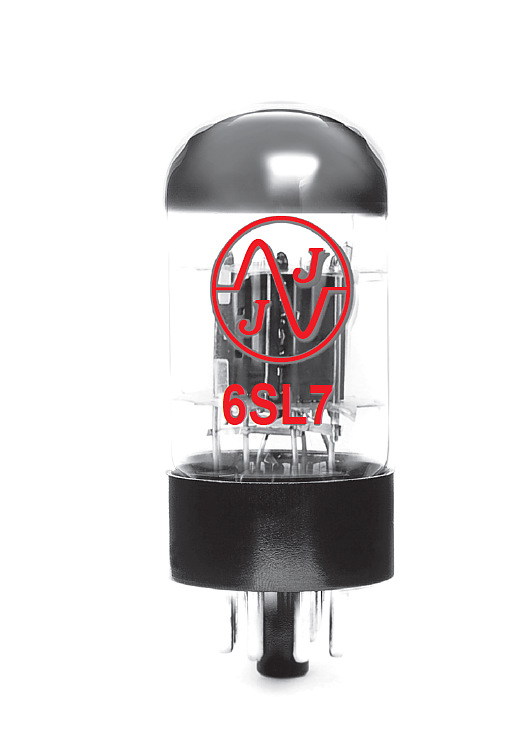

Black Glass Tubes
In the past I recall reading that old tubes with black glass coatings have lower distortion, it would be interesting if you could get a pair of those and measure them.
Joined 2009
and Jan Jurco are now making new 6SL7 and 6SN7 valves too.
