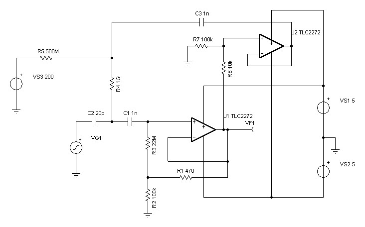

Obviously the capsule needs the 200V dc polarisation voltage, but why does the buffer amp need +/-60V? You could use modern CMOS op-amps with bootstrapping of the 200V bias supply. The noise won't be as good as a simple FET stage, but it might be easier to get working properly.
The capacitance of the B&K mics I have used is around 20pf, so the Zin of the buffer needs to be very high to get any LF performance. Attached is a TINA SPICE schematic of a buffer stage I might try. The simulation shows very good performance, but you would need to use PTFE boards to build it on!

Hi there,
thanks for your reply! I heard of the FM-Modulation technique, to have very good linearity. But I think it is to much RF design for a
DIY-Project. Epecially the lack of RF-Measurement equipment leads to problems.
So back to the Audio Circuit. Your Bootstrap-Circuit is an interesting impedance converter. Using the voltage divider R1 and R2 to lowers the current through R3 and bootstrapp the impedance to (approx.) Zin = R3 * (R2/R1) = 4,68 Gig Ohm. I used this circuit with a Capacitor in series to R1 to get better Offset-Current behaviour. The Offset-voltage over R3 and R1 is amplified by the open loop gain. When using FET-Op amp it mght work and you don't have to use a quite huge capacitor. The simulation looks good. Do you think there can occure other problems by reason of the offset current flowing through R3 and R1?
Because of the use of FET OP-AMP the noise performance isn't the best. This gives good reason to compare it to a discret impedance converter.

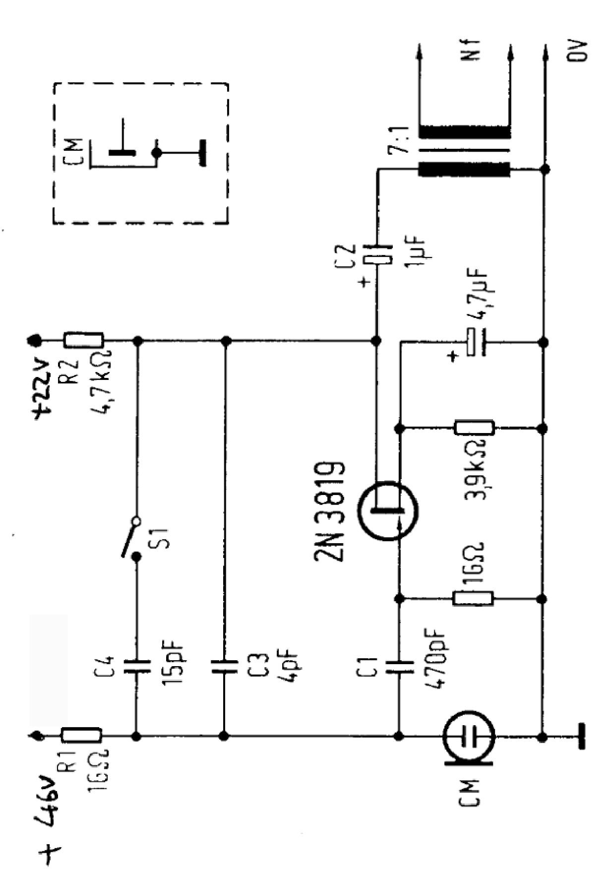

The most commercial impedance converters have a voltage supply of +-28V to +-60V. Using the GRAS-capsule and having the highest possible preasure Level of 150dBSPL (I know this is definetelly not practical value, especially not for audio, but this is what the most specs of impedance converter show) you get a peak-Voltage of 45V.
Here is a basic circuit of a condenser microphone:
It is a classical IC-FET-stage with a Voltage-Feedback over the Capacitor C3 and C4. The input section is very critical, because the high impedance can lead to problems, when isolation resister shunts the 1GOhm. I am not sure about the noise performance of this circuit. I gues the noise of the 1GOhm resister is low pass Filter by the 470pF.
What happens when the isolation resisters shunt the 1GOhm? In measurements it looks like 1/f-noise.
The ouput transformer is replaced by a bjc-transistor as impedance converter.

Hi there,
Cheers

So one more try... I have problems with loading up jpeg files. Maybe the file size was to big.
Another technical comment. What do you think of the voltage feedback? I saw a lot of schematics without this feedback. For the input it works like a miller capacitance, which shunts the resistor. For the ouput it decreases impedance which is good when using an transistor in Collector circuit.
