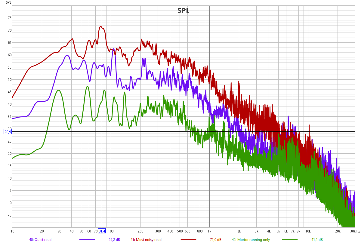

I look mainly for mid to bass cancellation, mainly tires noise, I know it is nearly not possible for high frequencies.
I also know cancellation can be done only in small area close to mic.

Yes, full silence is not good, but nose level about 60 to 70 dB make not possible to enjoy music.

"Noise cancellation works precisely if, and only if, the area you try to shield from the noise is significantly smaller than the wavelength of the sound you try to cancel, because then you can ensure that the anti-sound signal will in fact interfere everywhere destructively with the environment noise. Wavelength scales as λ=csν, so it gets ever smaller as the frequency ν increases. (cs≈343ms is the speed of sound.)
As soon as the size of the room you try to apply this to is larger than the wavelength, it is inevitable that the artificial signal will in fact interfere constructively on half the space, i.e. it will in many spots actually make the problem worse than it was by itself!
In a car, you can go quite far – the space is really small, and LF rumble has a generous wavelength – up to ~100 Hz you can be sure that it at least won't interfere constructively anywhere in the cabin.
Quite different in case of an airliner – not only is the cabin much bigger, also, jet noise has much more high-pitched components. Hence it is completely hopeless trying to cancel this sound with open speakers. It is possible to cancel it directly at the ear, with noise-cancelling headphones. But these are already available individually, so it's not something the airline needs to worry about!"
Considering, it's understandable why NC headphones work as well as they do. In a car cabin, getting to 1k everywhere could be tough - unless your idea is for a solo arrangement; the driver position gets the full bandwidth cancellation, the rest of the cabin locations is what it is.
I am happy with only cancellation at driver position.
