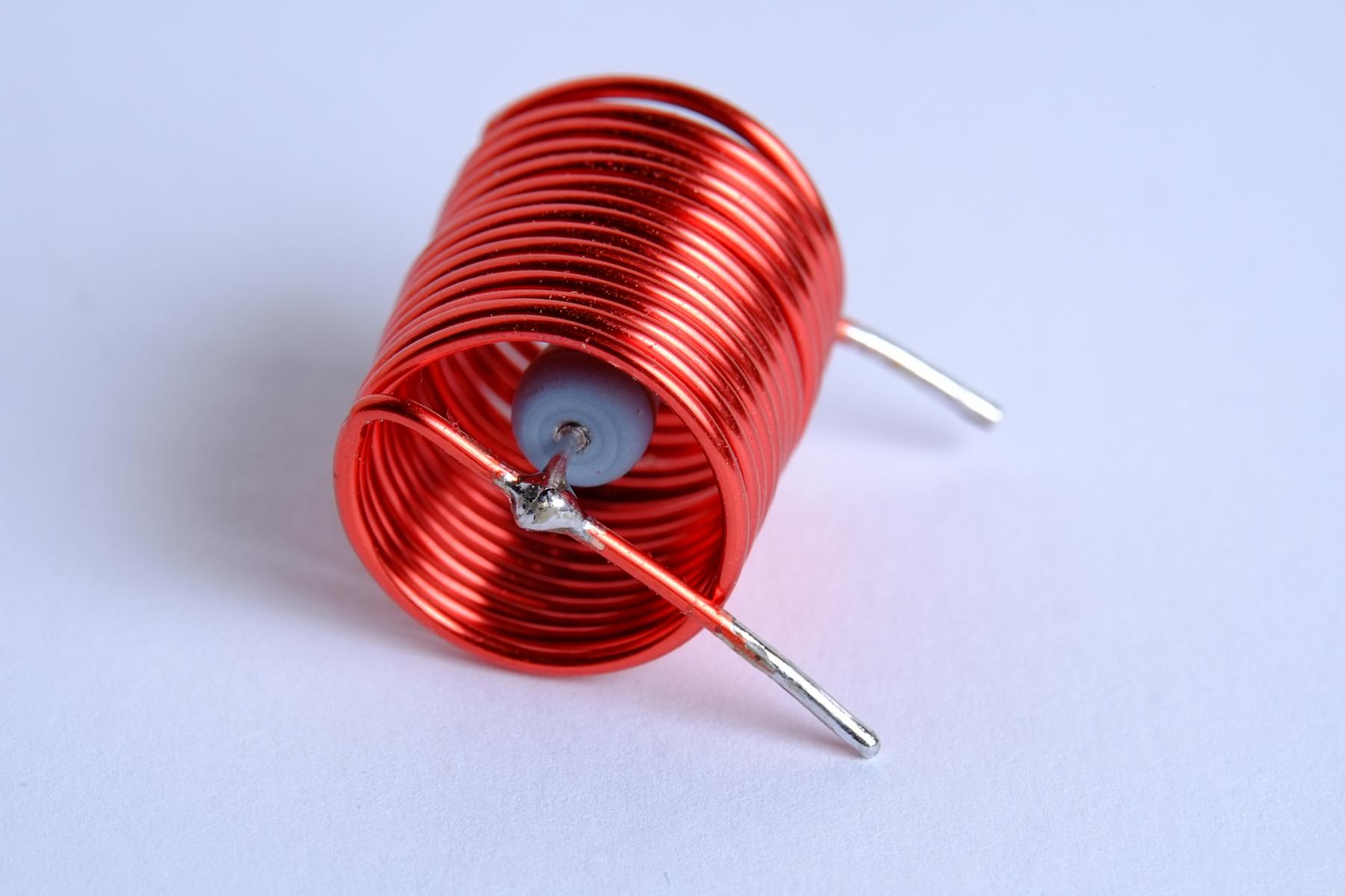

Playing with some class-D amp I thought it would be useful to make my own inductors, because they are only made of bits of wire and that's much cheaper than buying them right?
So I played with a bit of old toroid with 1.2mm wire until I realised that I needed a bobbin to hold it all together, or at least a former and some superglue.
Then I found a useful guide to them HERE.
gifs upload
So the bobbin's I chose are regular sewing bobbins, in plastic, mine measure 8.5mm dia in the middle and a length of 9mm for the coil.
I decided on AWG21 (0.72mm) wire giving a 0.05ohm DC resistance for a 10uH inductor needing 38 turns. Thicker wire will fit in but this is dead easy to manage and I only bought this one size. The design tool posted above gives you all the sizes if you want to try thicker wire - next time I'd probably go up one or two sizes, you'd also need less turns if you did.
After mounting the coil of wire (a 500g reel) in my solder dispenser I hand fixed an M6 bolt in the reel, set the drill on slow and 'backwards/undo' to wind the coil.
Using my finger and thumb to tension and guide the wire I just had to count to 38 and it was wound, and after about 5 minutes I had 4 nice inductors that actually measured exactly the same inductance as my 10uH Wurth ferrites I'd bought.
Note: Run the drill back as it self-tightens the bolt in the bobbin, go forward and it will just loosen off.
An additional advantage to winding your own is you can make the flyleads as long as you like, which makes soldering them in much easier and allows you to have less PCB track around gathering capacitance.
Probably best to mount them at right angles to each other as the flux is not so constrained like in a ferrite so you may get a little crosstalk. However you'll never saturate the cores and air is pretty linear so they should sound good.

I thought they were impossible too, as I was trying to achieve this:
(The SMSL SA-60 pictured).
Then the calculator kept telling me to go wider and flatter, so I tried a nut and couple of washers before I realised that a sewing bobbin <obiwan>was the item I was looking for</obiwan>.
Winding them into a bobbin was in fact ridiculously easy 😀

In general, you get the most compact inductor for a given inductance if it's roughly square. I.e. length = diameter.
Not really. To be more precise: your statement is underdefined. You didn't tell anything about 1: resistance, 2: weight. 3: number of layers.
For a given inductance and given DC resistance and lowest weight but without specifying fixed number of layers the best geometry is actually very close to a fully wound sewing machine bobbin. But for low AC loss it is very bad. Generally: the more compact the design the higher the eddy current loss.
Your rule apply more or less for single layer inductors. However "compactness" is not a well defined parameter. What should be minimal? Surface? Volume?...
I guess one could wind each layer on the bobbin and then add a tape spacing layer before the next coil layer.
Either way I suspect in practice it may not matter much, getting rid of the ferrite is for me the main aim.
The real discovery for me was how easy and quick it was to wind my own. Next comes the trials and experiments 🙂.
