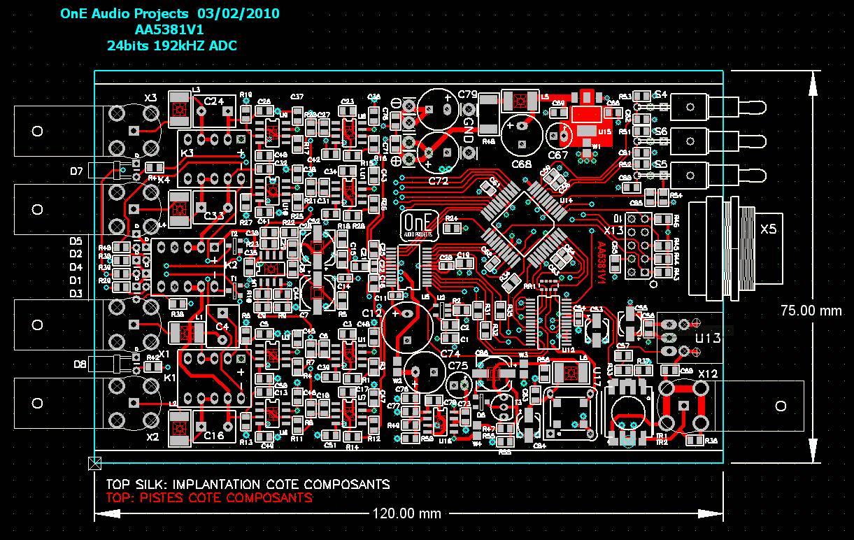

Here the PCB design use 4 layers with massive ground plane and very clean signal path routing
Now, the schematics and the PCB design is done, but not already sent to the PCB manufacturer.
I verify again and again each one before to order it.
If some DIYers are interested by this project, i can post more details about it.
Below, You can see what it should look like.

Below, the PCB design finished (only the top layer is displayed).
The ADC is designed as audio measurements tool. It replace a sound card, with more easy to use because it's an external unit with direct BNC connexion.
It allow DC or AC coupling, single ended or differential input, offset calibration,
overload detection on each channel and 48/92 and 192kHz sampling rate are supported.
The digital output can use optical or coaxial link (SPDIF).
It need only a low noise dual rail +/-15V dc power supply.
I wait comments...:Pawprint::Pawprint::Pawprint:

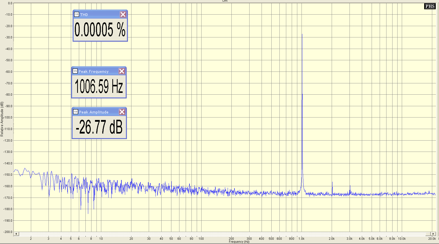

Maybe you are looking for something readymade, and possible unbeatable, take a look at TI's PCM4222EVM ( US $ 149,-- +shipping ).
You just need a dual 15V and single 5V powersupply.
Here a FFT; source Krohn-Hite 4400A, both units SLA battery driven, PC interface RME-PAD via AES/EBU.

About the spectrum of the EVM, how exactly the measure has been done ?
Digital, analog, all setup ?..
Frex.

I think now soon send Gerber files for pcb manufacturing. 🙂
I think use "pcbcart" service. It' offer cost effective solution and they job is very good.(145€ for 2 boards including shipping).
I hope that my job doesn't yet contain many errors.🙄

Thanks for the good tip, but that -168dB floor in your plot, is relative to what voltage?
ghg,
What is the rms level of the analyzed signal ?
The spectrum analyzer is it calibrated in real dBv ?
It will be interesting to make measurements with higher sampling rate,
because noise increase.
Do you use weighting filter ?
Can you post more pictures ?
