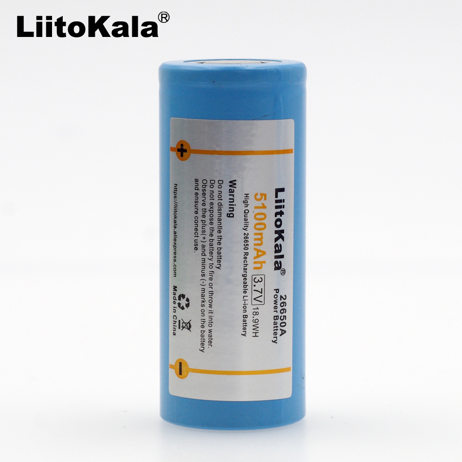

Look into this 26650 / 5000 mah battery, very highly rated. I have at least 40 of these, no duds and all perform to spec.
LiitoKala 26650-55A 5000mAh 26650 – Buy LiitoKala 26650-55A 5000mAh 26650 with free shipping on AliExpress version

Thanks. I kinda have the battery thing figured out. I am more interested in how to put it together, parts used, battery management, etc.
Also I have to use 18650 in this build due to very limited size in the compartment. I have pre-built batteries that use 26650 and the play and play and play for days. I just can't use them in this build due to their size.
I am going to use 4 16650s. I know I won't get the play time, but I don't think I need it to play all day.
BTW, I have heard good things about those batteries. I would be hesitant to order from China these days. I have some other stuff that has been sitting in China waiting for a plane for 7 weeks now.
