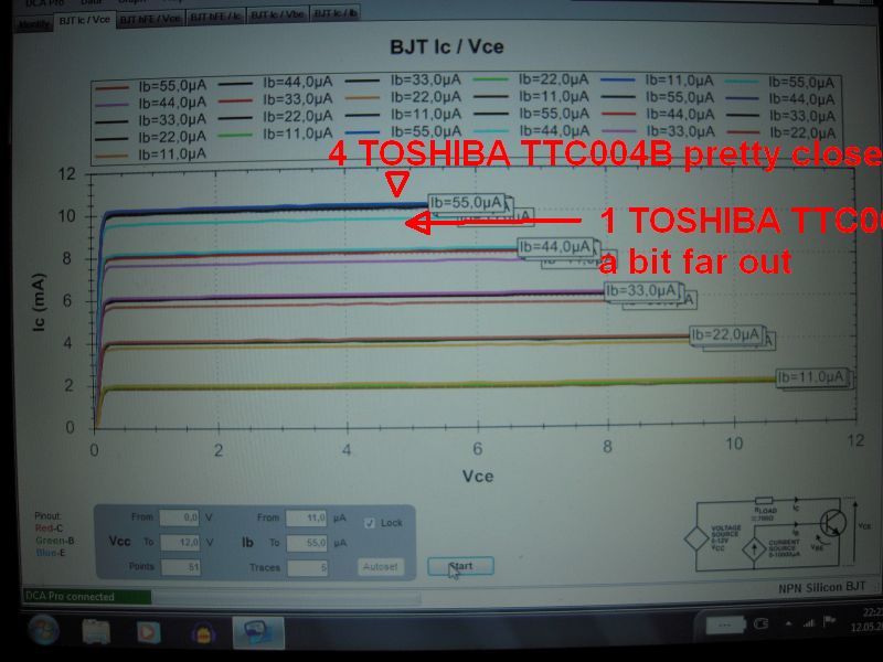

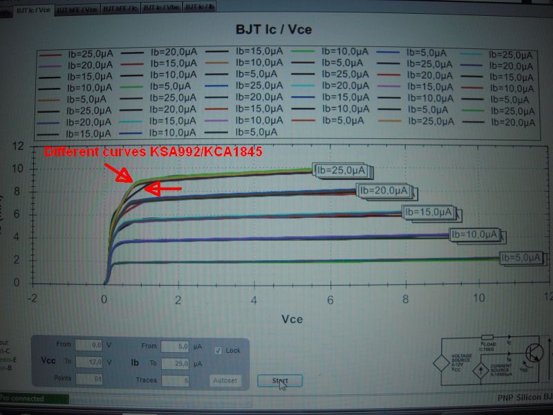

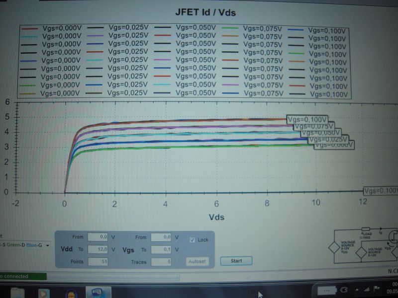

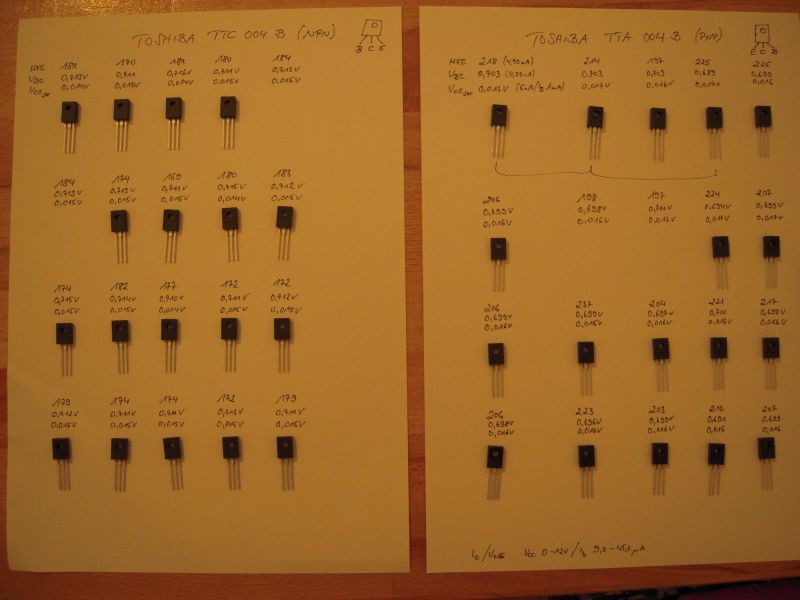

Hello AmpsRus,
the Peak Atlas DCA75Pro is one of my most important tools to build amps.
If you want to match your active devices, the DCA75Pro is a very good thingie at an affordable price (I paid 123,50 € here in europe).
The range to measure is not so'wide' like a professional curve tracer. In my opinion more than enough for me as an hobbyist.
The DCA75Pro is delivered with a software that shows your results (curves) on your PC.
You can see some of my measurements / matching active devices in the `Waynes BAF2018 linestage'-thread.
Greets
Dirk

to AmpsRus
some pics
Greets
Dirk
