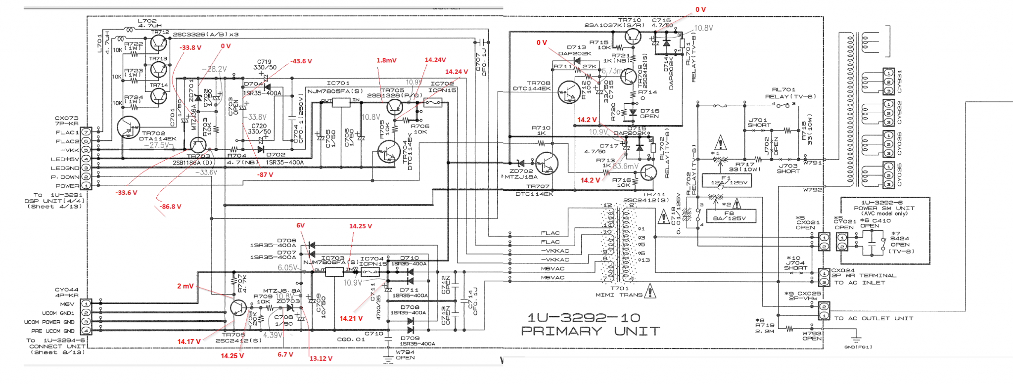

Just wondering if the voltages stated on schematic are on the dot when tested in the real world. I'm getting mostly higher voltages ,i.e. 14.4V instead of 12v. They are mostly like this. One voltage does bother me though. It is -88v instead of a -33v stated the schematic.
All transistors looks to be doing ok on the mini power supply. Instead of the internally resistor biased transistor (BRT), which I have no idea how to test either in circuit or out.

Good, then find why the discrepancy in voltage.
That will tell you how to find the fault.
It died on you, or you got a dead unit?

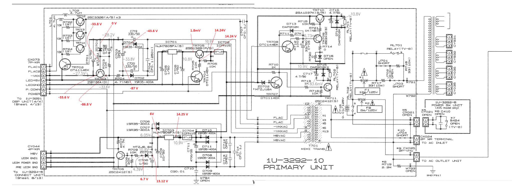

The unit I got dead for a price I couldn't resist. Here are a few of my readouts. I might have missed the reading with 0V on ZD701, I'll be checking it again once I get my ESR. Just too much weight for me and too little room to keep working on it again without the ESR meter.
You need to start from the secondary side of the transformer, a failed Zener is possible.
Other component damage is possible due to it.
And look for signs of attempted repair...then it is a bigger job if experiments were done, those are difficult units.

I got a comment from a friend that the circuit around it acts as a voltage doubler or tripler thus the suspicious readout.It's also worth checking for a voltage across the resonator.
The -87V concerns me.
Chris
Also said that the -30ish on the manual might be a misprint as the circuit somehow looks to be a doubler and was designed to have no caps on it. Said misprints are common on service manuals and are corrected subsequently on later service memo (not sure if its the correct term).
