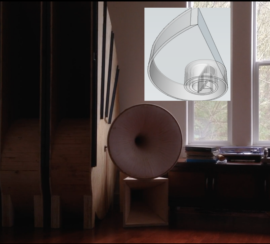

I am looking for some plans for a DIY pair of Horn speakers. I am thinking folded horn in a box with a dynamic conventional driver for the Bass. And then on top of that a good compression driver with a multiway horn or just a nice front loaded horn. I will be driving it with my 300B SET amplifier. A very high quality amp. I am looking for spl around 105ish to be on par with my La Scalas that these will be replacing. So I am looking for suggestions. Don't worry about cost at this point. Just toss out some suggestions of nice designs please.

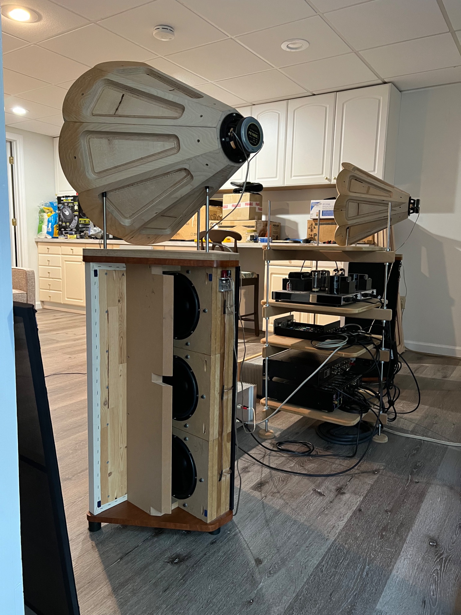

I took mine even further and radically re-engineered them with my own spin on the DJK port mods, increasing the upper cabinet volume by 50%, sealing it and coupling it to the woofer dog house, using a 15" passive radiator in lieu of ports. Combined with a JBL 2225H driver, PRV WG4550 & PRV D4500ND-PH mids, L-MAHL/B&C DE10 tweeters and an active DSP Crossover and 6 mono block amps, I'm getting a +/-3dB frequency response from 20 Hz to 20kHz, an increase of 35Hz in bass response and 2kHz treble over earlier OEM LaScala, with linear time alignment and near linear phase, courtesy of the DSP. With a passive crossover and a single ended amp, you'd get similar frequency response (if your amp was capable), but neither the frequency response, nor time and phase alignment would be particularly flat.

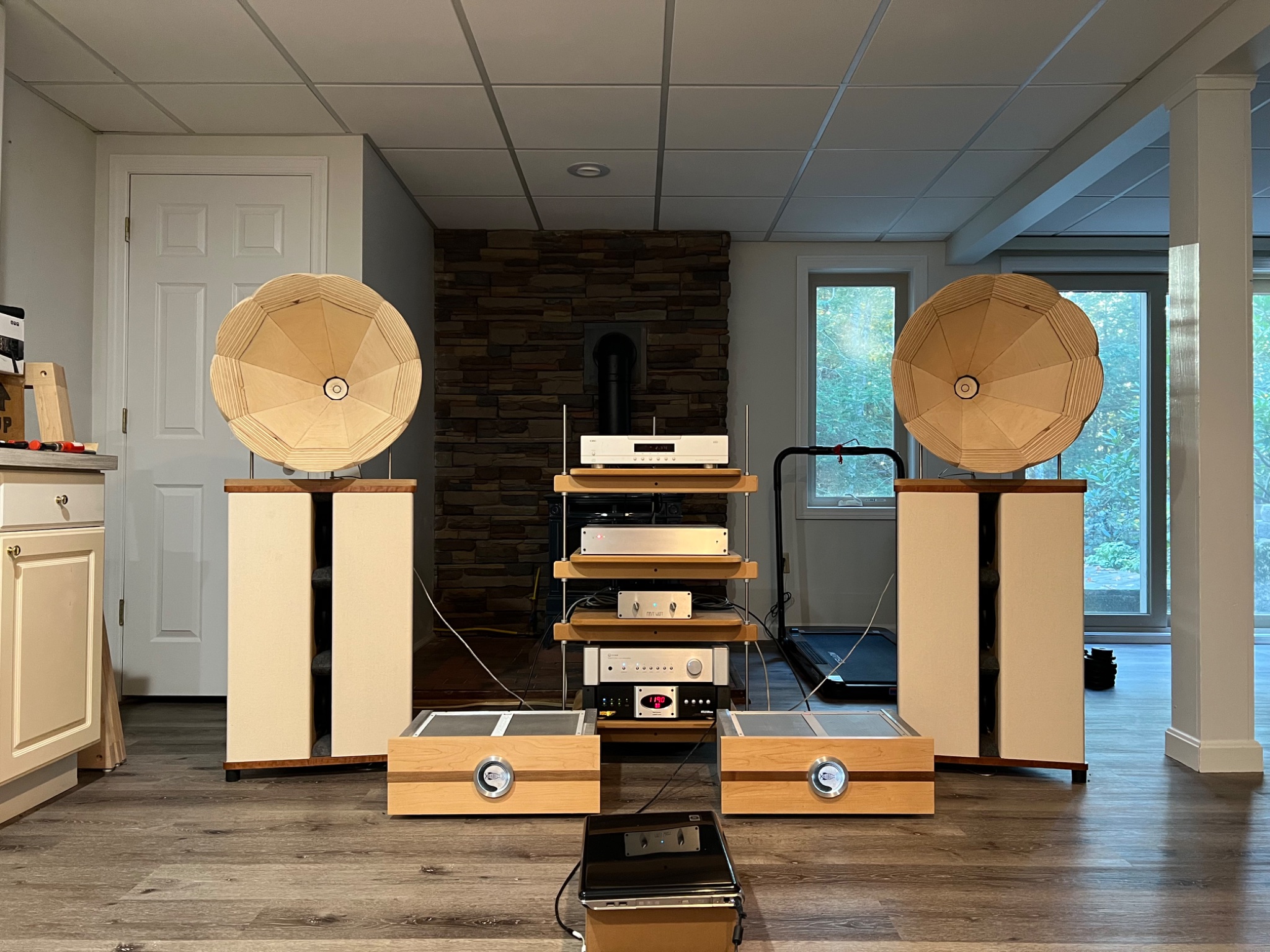

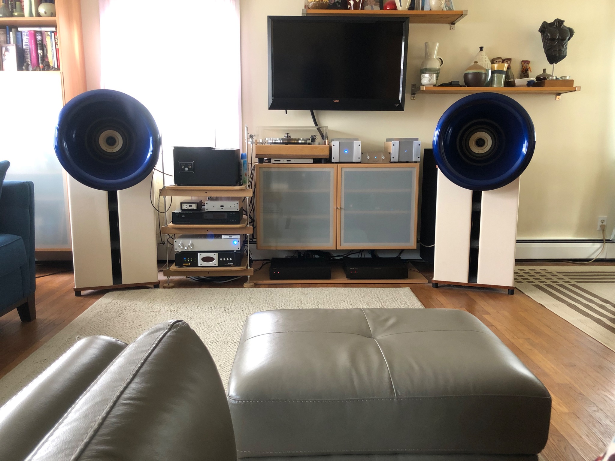

I get it. It’s why I started my front horn experimentation with the Oris horns and wide band drivers. They were cool looking and the resolution did impress me.
Unfortunately, I tired of the severe “head in a vise” beaming in my modest sized living room. Never got the bass support resolved correctly either.

The size (and sensitivity) is inversely proportional to the low frequency cut-off (Fc) of the FLH (front loaded horn).But they still lack a bit of bottom end... I would like to build a true bass horn so it all blended well but only if I can find an existing system to copy.
Define the Fc, and you can determine whether something like Inlow's ~25Hz Fc spiral horn
https://inlowsound.weebly.com/spiral-bass-horn.html
or Tom Danley's spiral horn LAB sub at 45" x 45" x 22.5" with an Fc ~35 Hz:
https://forums.prosoundweb.com/index.php/topic,174478.0.html#new
Or something smaller that does not reach so low.

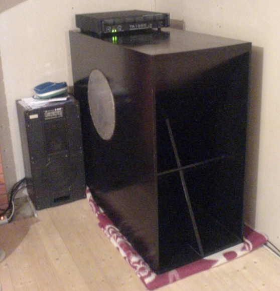

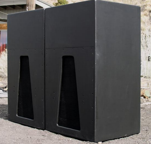

Tapped horns (TH) don't require as much mouth area or cabinet volume to go as low as a FLH, something like the Keystone Sub (also a spiral horn) has near the same LF response as the LAB sub, (though lower sensitivity) in about half the cabinet size, 26.5" x22.5" x 45".
The Keystone Sub™ cabinet works well with a variety of speakers of quite different parameters and sizes.
The Keystone is named for it’s exit shape, similar to a keystone. Like keystone lens correction for off axis projection, the keystone exit corrects some frequency response problems that result when a rectangular exit is used with the particular fold pattern employed in it’s construction.
