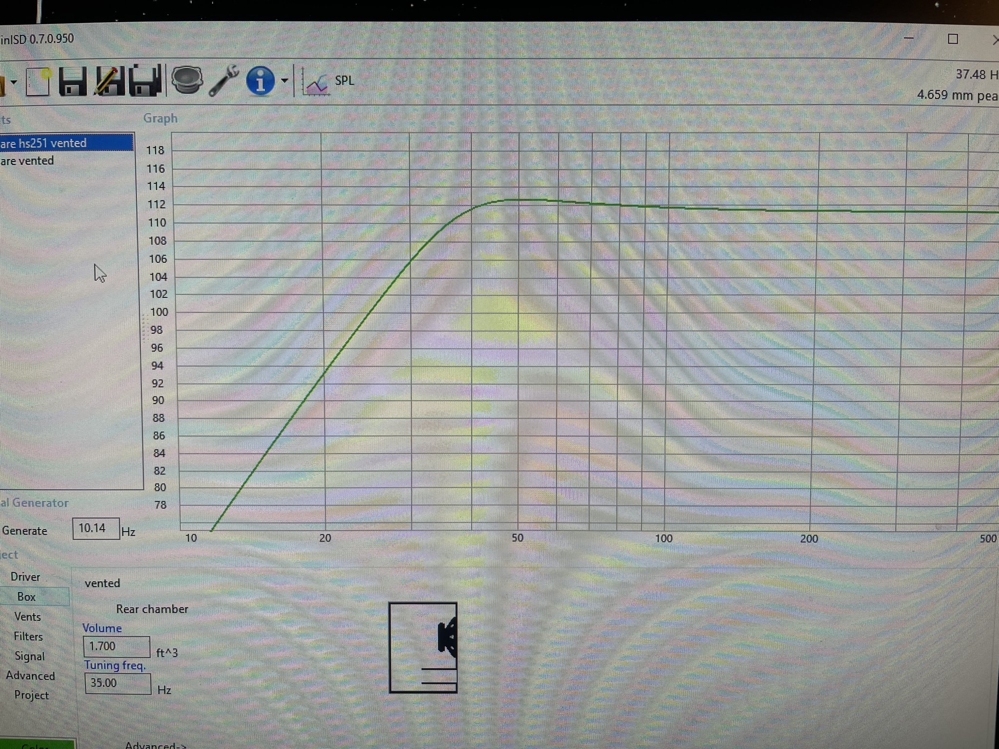

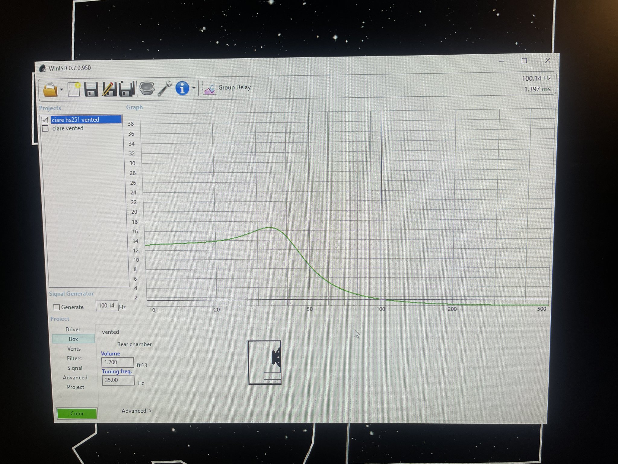

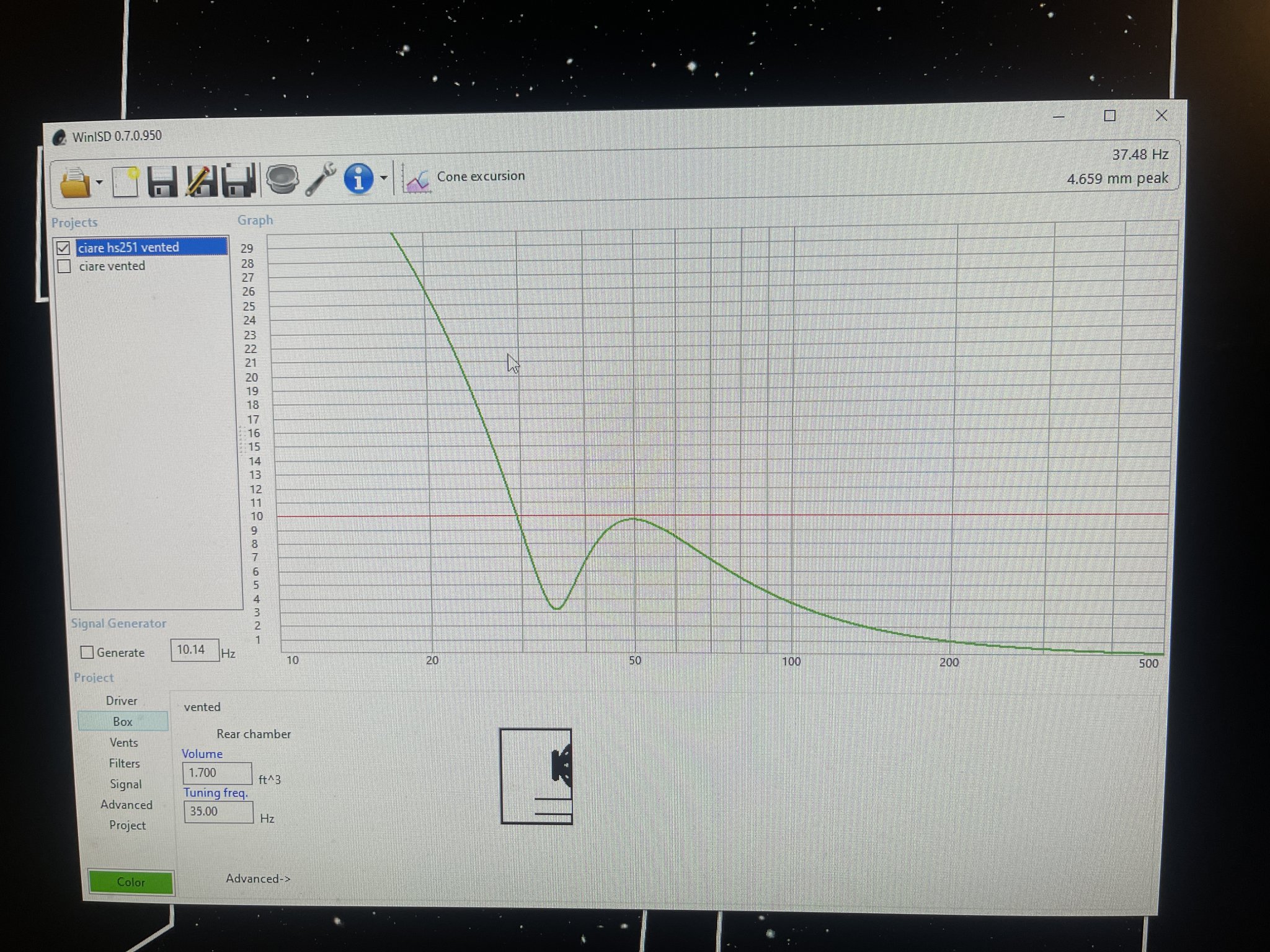

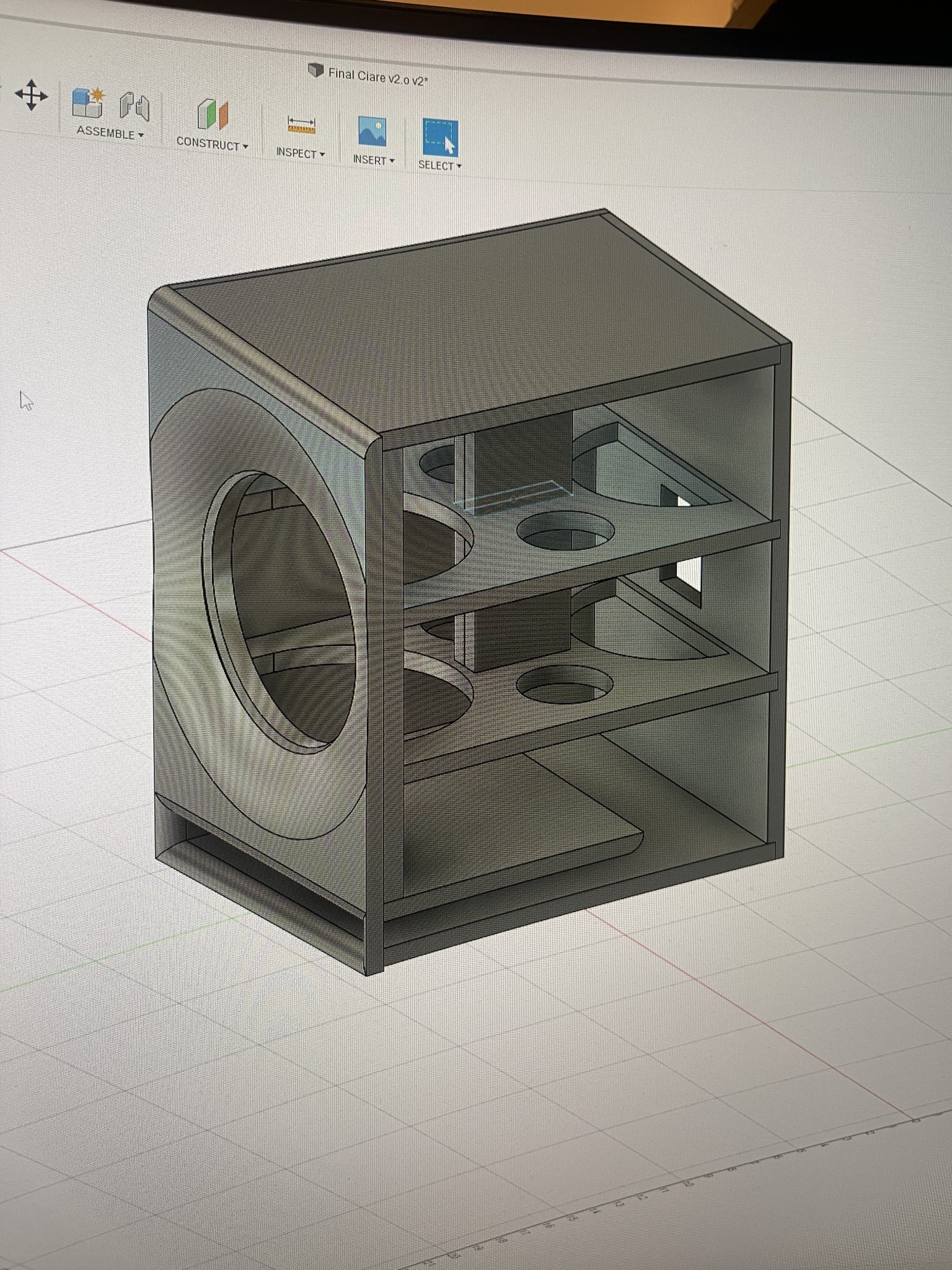

Ok here are photos of the simulated performance in WinISD of the subwoofer I am producing. I will be starting CNC machining it tomorrow. Here are simulated group delay responses, excursion at 200w if power, spl at 200 watts, and the box design (minus the side panel so you can see into it).
There will be a internal front baffle that the subwoofer behind a beauty cover front baffle. It will be made of 1” thick MDF. The front baffle will have Allen head screws that screw into the MDF baffle with threaded inserts.
The rest of the enclosure will be made of super nice 0.7” 13 layer Baltic birch ply. I will add some generic dynamat sound deadening and some fiberglass insulation. It is a 1.9 cu ft ported enclosure

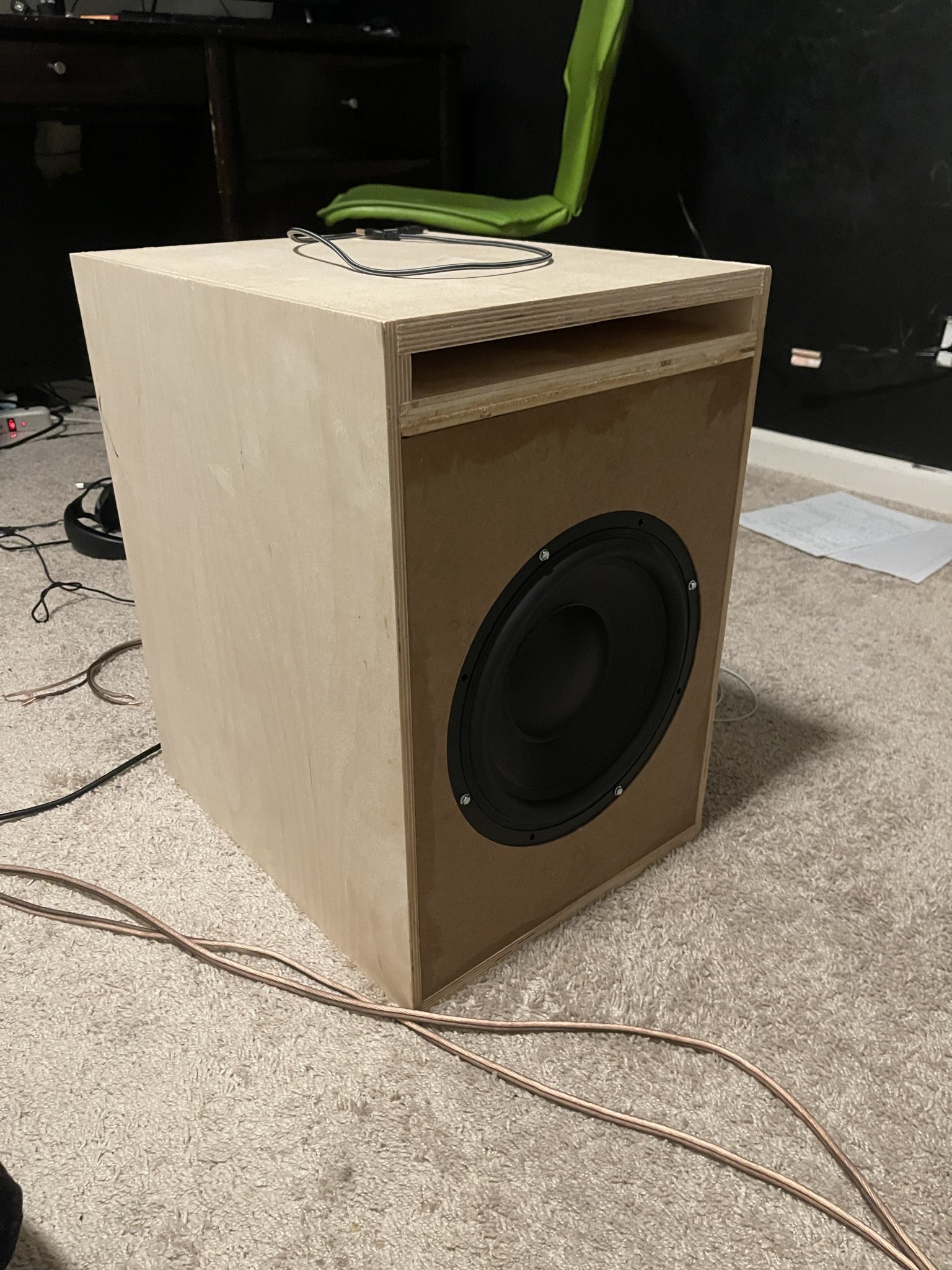

Alright everyone! Im close to getting the subwoofer done. I have CNC machined all panels except the small baffle inside that creates the port. Im going to finish CNC machining everything today and do some sanding and test fitting. I ran out of wood to machine the nice looking front baffle/beauty cover but I do not need it to have a good sounding sub so I will do that in a month or two. This front baffle does add length to the port but not having it will reduce the port length by 0.7” slightly shifting the tuning frequency up by a few Hz. I tried to post a video of my CNC cutting the internal brace but it was “too large for the server to process” 😬
Ok here is the subwoofer Minus the beauty cover sitting on a 1” thick MDF baffle. So far it Sounds Great. Super Hard Hitting, clean, and low bass. I do have to do some sanding on the enclosure too.

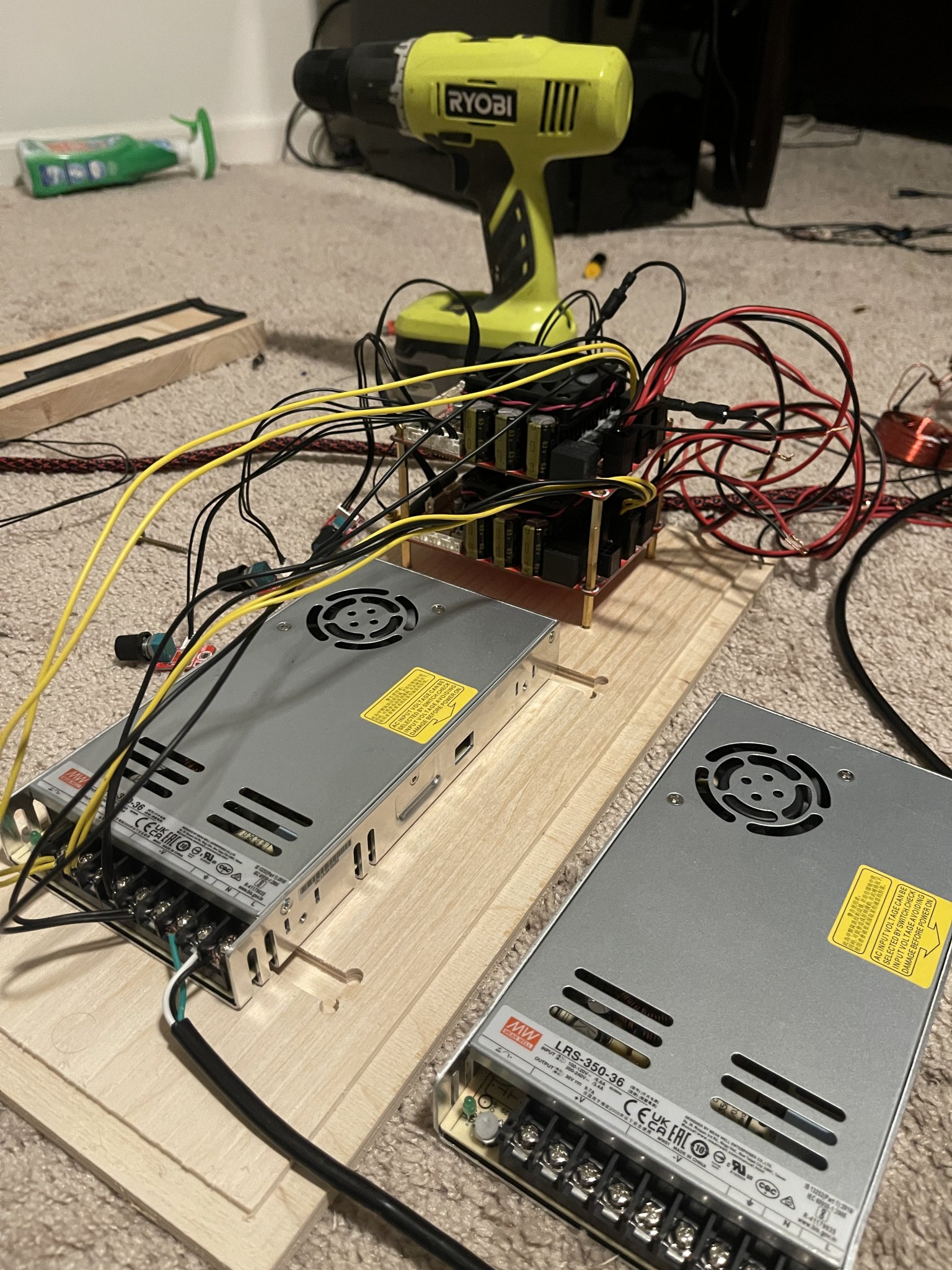

I also CNC machined a base plate for my amplifier chassis (made from 0.5” birch ply) for the dual KABD 4100 Amps and their two power supplies. I will be making a back amplifier chassis baffle to mount and wire up the Terminal Cups next which will tidy up the wiring, and I will have a 3 Prong AC Power Plug with a switch and fuse.
