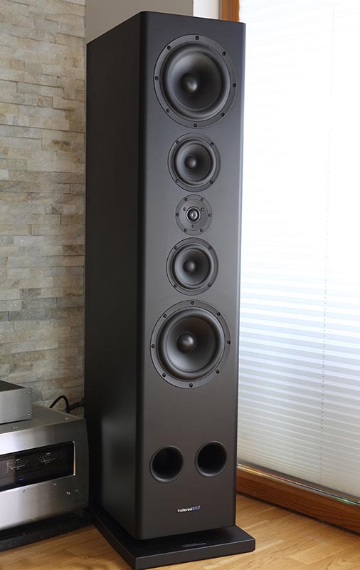

High-performing home cinema DIY LCRs kit for a big cinema rooms:I am thinking of a DIY home theatre system. Looking for recommendations for a very high performance diy floorstanders. I like to keep pricing under $5k for the floor standers and the lower the better. Would also need some bookshelf speakers for surrounds.
Also planning on diy flat pack subwoofer cab + synthesis hs18s (x4).
HC GigaLCR DIY Speaker kit by StereoArt
