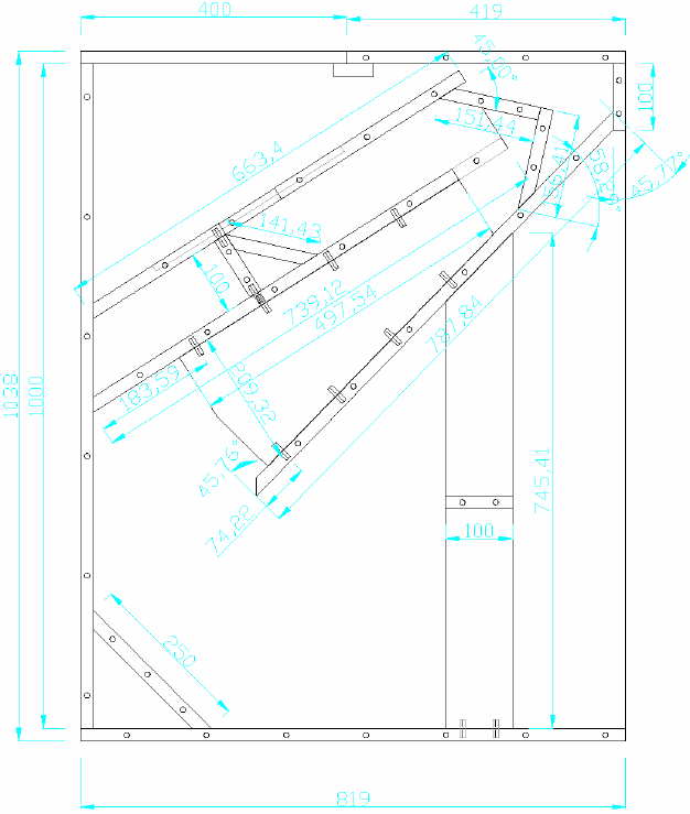

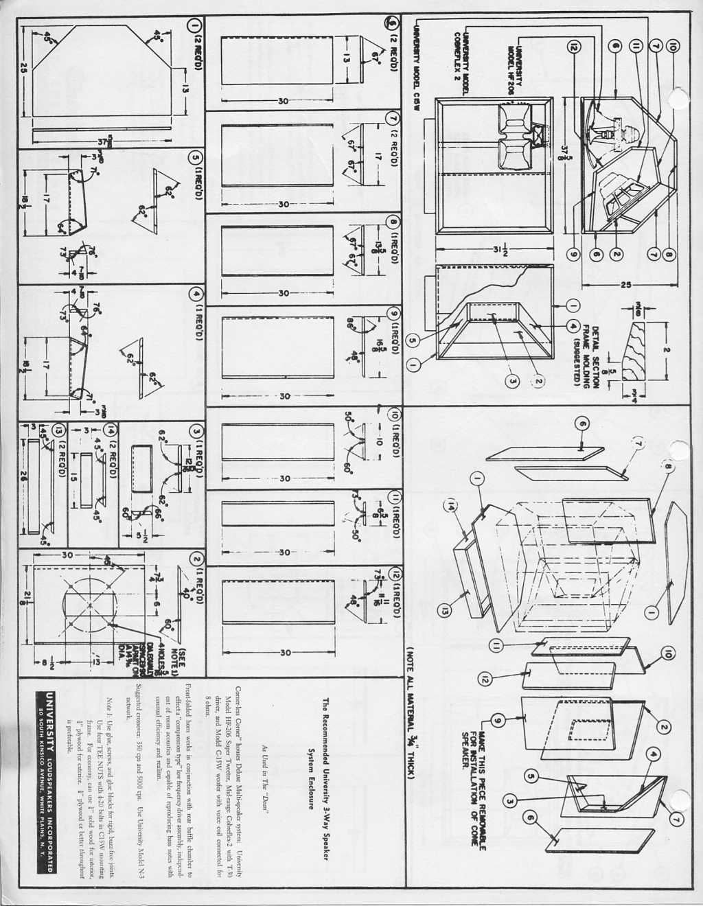

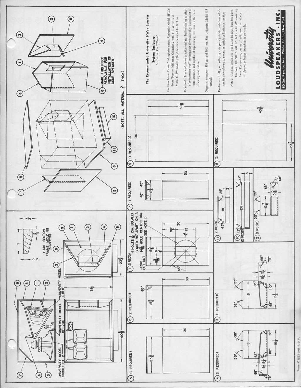

Klipsch Bass-Horn
here are drawings for you.
took some time to find these for you.

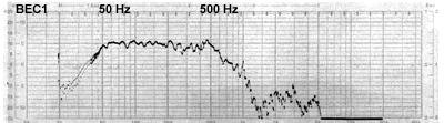

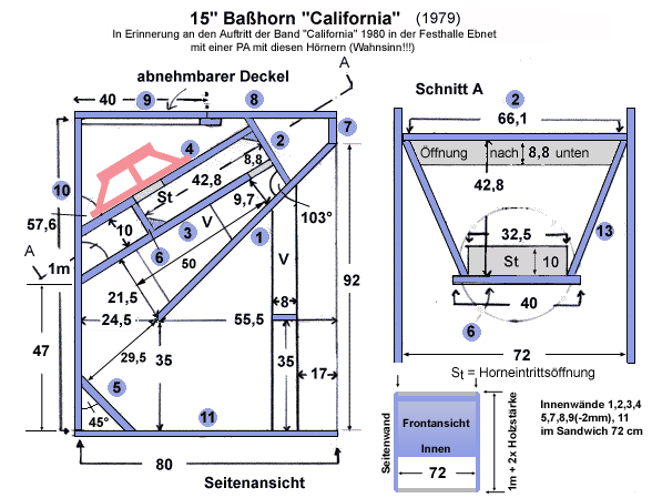

The California bass horn designed by Ernst Georg Beck.
Included is an upgraded version with improvements to the first bend.
The fellow who devised the improvement to the first bend is a member at the Lansing Heritage forum.

Thank you very much for finding and posting those drawings and all the extra information.
I have a sizable room, approx. 17ft x 21ft. What ever I build must fit in the corners (WAF), so the California ones are not going to be suitable unfortunately.
I'll study the drawings and measure up over the next few days.
take a look then at Beck's single twelve inch horn design which is more compact and has close bass response to the California as well as equally impressive response and extension. A sub or two for the lowest octave would be called for with all of the discussed designs. A pair of stacked twelve inch cabinets in a corner will push about 50% more air than a single fifteen inch woofer is capable of.
BEC2Biex
Becks page on loudspeakers.

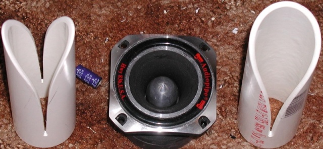

The Cobraflex horn is not one of audios highlights and if you do some looking you will find that to cross as low as 200 - 250Hz takes a very large horn. You would do well to investigate the Karlson K-Tube they certainly surprised me. I have a paper set of K-Tubes on my EV DH1A drivers with the extender nose cup removed which makes them a nominal 1.4 inch exit driver. I much prefer the double cutaway version of the K-Tube in fact I prefer them to any of the horns that I have used so far. The attached photo shows a K-Tube in both single and double cutaway style.
