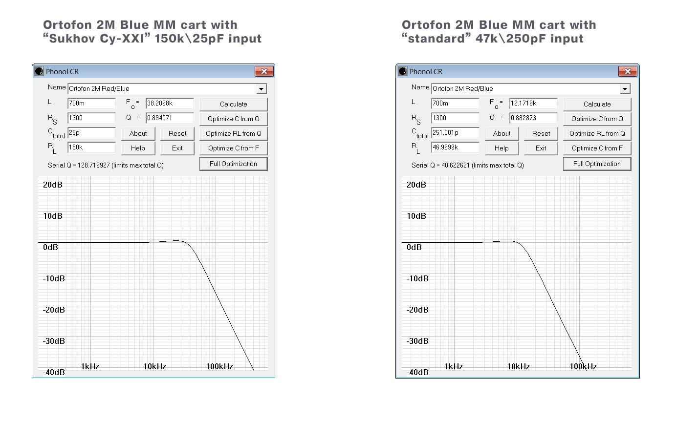

Looking to build a M/M phono opamp version or i
also have a matched quad of original 2sk170bl if any good
what would be a good schematic to use ?
quite a few pcb on ebay and alibaba
but dont mind making it on veroboard
my cart is a 2M Red
my cart is a 2M Red

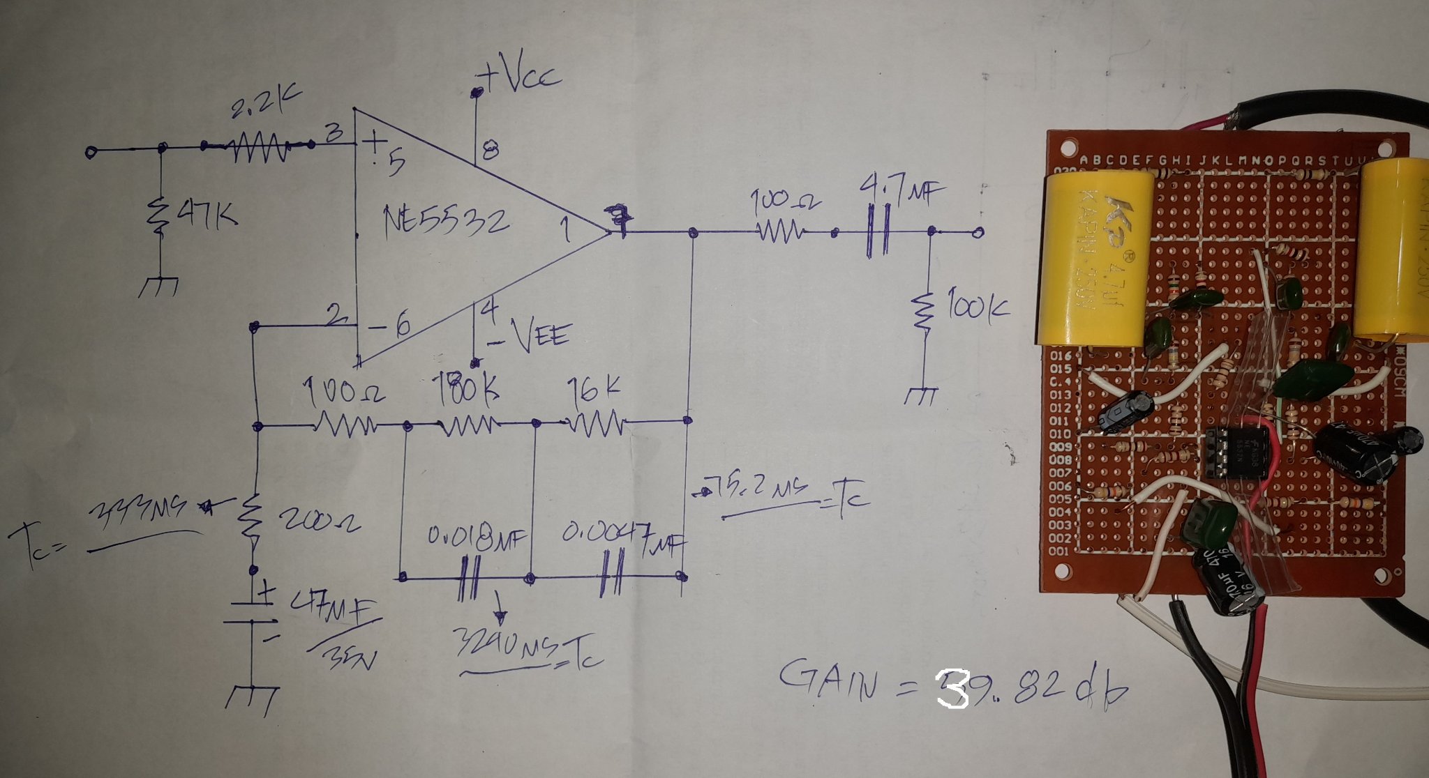

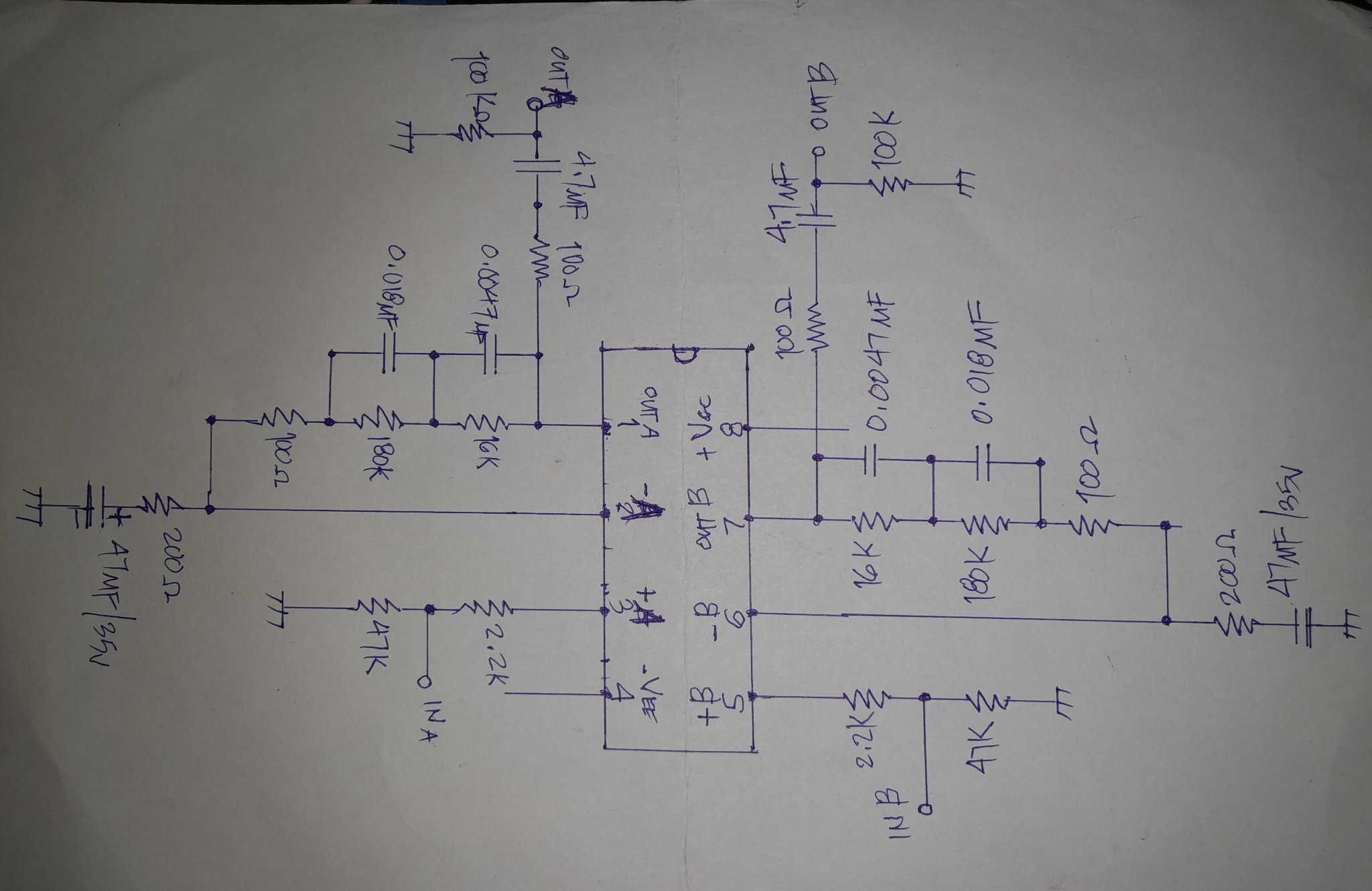

I recently completed my simple DIY active phono preamp project using the venerable NE5532N op-amp, and I am pleased to report that the sound quality is good, especially considering its straightforward design. The circuit is fully functional and has been tested with various vinyl records.
Comments, suggestions, feedback, or any advice to improve the circuit are welcome. It's enjoyable to build DIY projects, and they are inexpensive. Thank you!

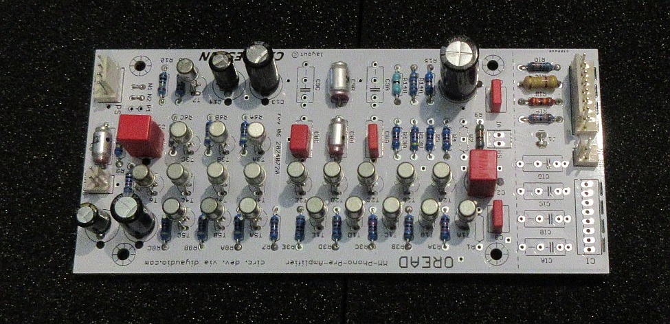

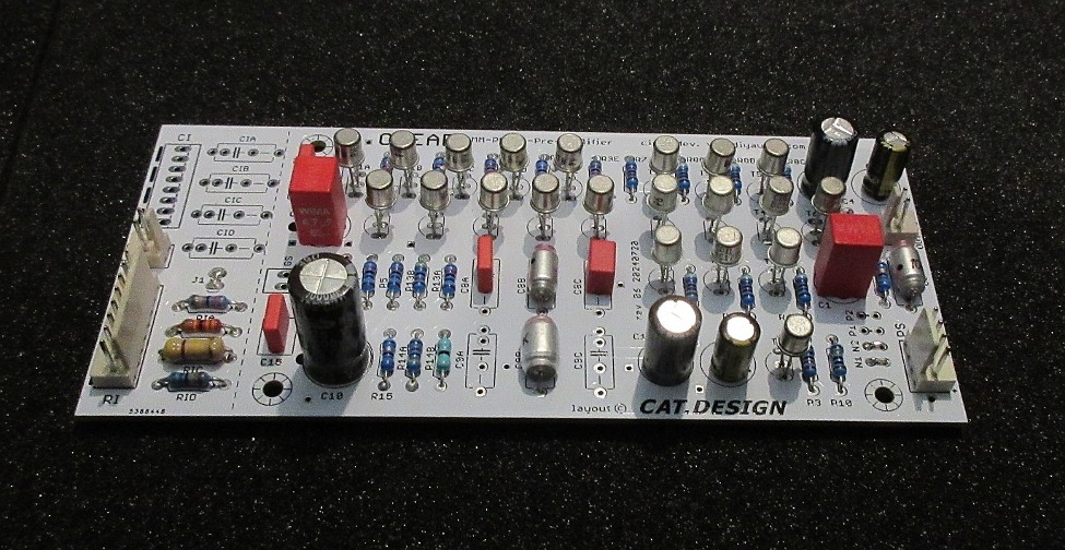

I got the new OREAD PCBs, version r06, and immediately assembled one.
This time, as already announced, the 'NPN circuit', i.e. with NPN transistors at the input.
All other transistors, electrolytic capacitors and of course the operating voltages have their polarity swapped accordingly.
To do this, I made a few small changes to the board layout compared to version r04.
To avoid the operating voltage having to be connected the other way round than the board print indicates depending on the selected circuit (NPN/PNP), the polarity of the operating voltages on the...
