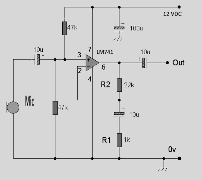

The simplest possible circuit would be a single high gain opamp stage where you just alter the gain setting resistor suit. Just tie the mic between ground and the input of the circuit.
You could then develop that and split the gain between two stages (the two opamps in the package)
This runs on a single supply... you might even get away with 9 volts from a battery. Watch the pin outs, this is for a 741 type opamp.
The gain is set by changing the 22k and/or 1k and equals (R2/R1) +1
Thanks a lot for the explanation and all other resources you shared. I learned a lot.
